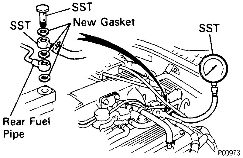

3. Remove the union bolt holding the left hand delivery pipe to the rear fuel pipe. Remove the 2 gaskets.
CAUTION: Put a shop towel under the delivery pipe. Slowly loosen the union bolt.

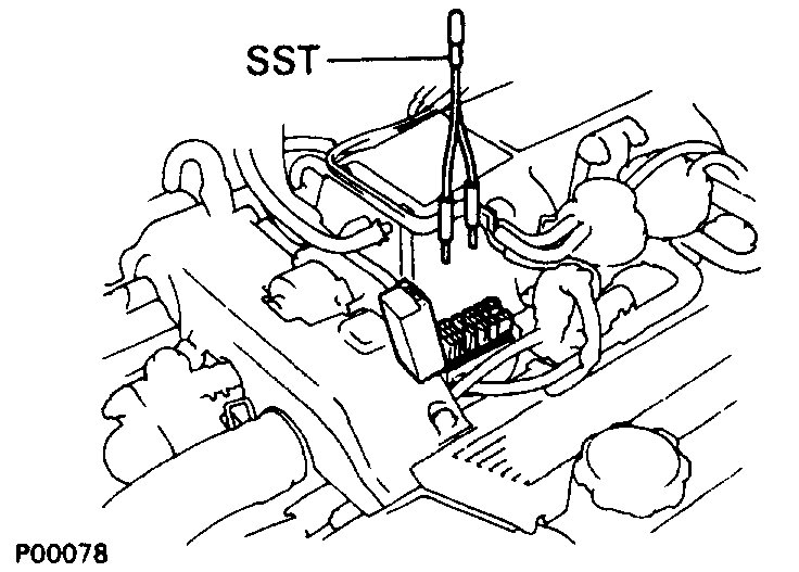

pic 1
4. Install the rear fuel pipe and pressure gauge to the left hand delivery pipe with 3 new gaskets and the union bolt. (SST 09268-45012)
Torque: 39 Nm (29 ft lb)

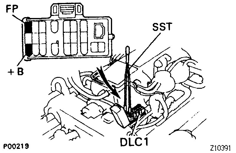

pic 2
6. Using jumper, connect terminals B and FP of the data link connector 1. (SST 09843-18020)

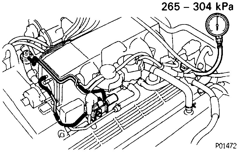

8. Turn the ignition switch ON.
pic 3
9. Measure the fuel pressure.
Fuel pressure: 265 - 304 kPa (38 - 44 psi)

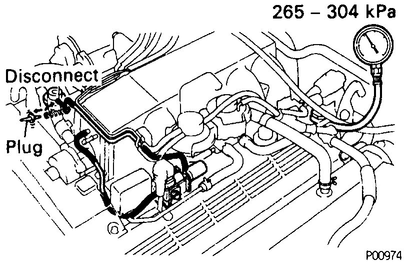

12. Disconnect the vacuum sensing hose from the fuel pressure regulator, and plug the hose end.
13. Measure the fuel pressure at idle.

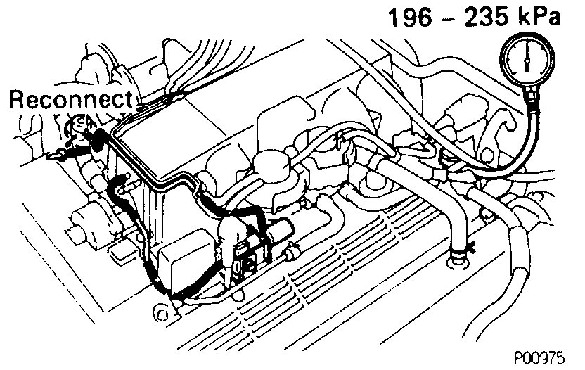

14. Reconnect the vacuum sensing hose to the fuel pressure regulator.
15. Measure the fuel pressure at idle.
Fuel pressure: 196 - 235 kPa (28 - 34 psi)
