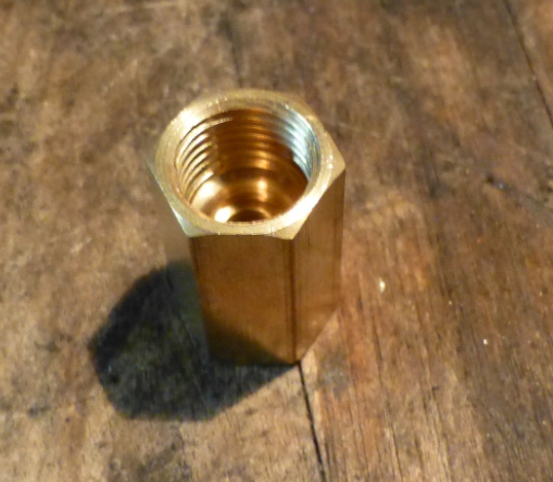

Wow. It is unlikely but it is possible that you have another new part that is faulty. What will tell us this is how you narrowed it down to this caliper.
I am not able to find what style fitting you have on the brake line that goes into the caliper. However, what I would do is remove the line from only this caliper and cap the line. This way the only thing not in the system is this caliper.
I attached a picture of a standard cap below that should work on all except the lines that have the banjo bolt.
Basically all you are doing is confirming that you have a hard pedal with everything but this caliper. If that is the case, then the source you are getting these from has a batch of faulty parts. Unfortunately this does happen.
However, I would not try to move on until you confirm it is still soft with this removed because I don't see what you are missing.

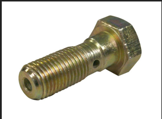

So if the master was not large enough you would not have much braking power as it would not apply the brakes very well but it would still have a hard pedal.
So lets try and cap that caliper a different way just to see what result we get.
As you can see below the banjo bolt has a hole that allows the fluid through when you press the brake. Just find a bolt from a hardware store that is the same length and install that banjo line on the caliper with it.
This will block the fluid from going any further then that line.
By doing it the way you did, it will not get a hard pedal until it fills that void so that make sense that it would be low.
This will be a definitive way to check this because I just can't believe this is anything other then that caliper.
If not then clearly we are missing something in the lines because if you capped the master and the pedal is hard then obviously we are missing it.
