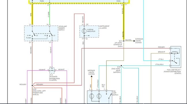

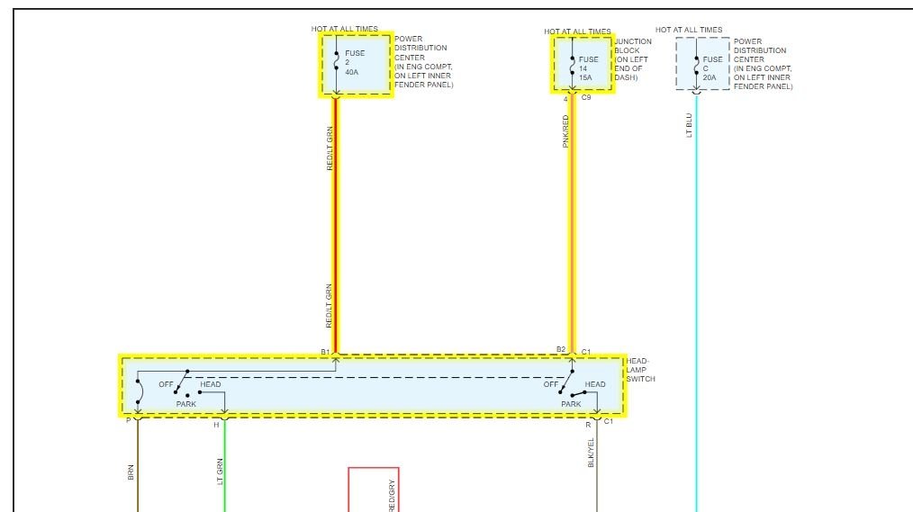

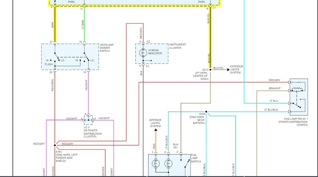

the parking lights, taillights, dash lights all work. if I barely pull the switch out but won't work when pulled into park or light position. I have used 2 new OEM switch's and the problem still exist. Headlights, turn signals, brake lights, flashers, and dome lights all work fine. What can be the problem??
Feb 22, 2020 at 10:41 PM
Good morning,

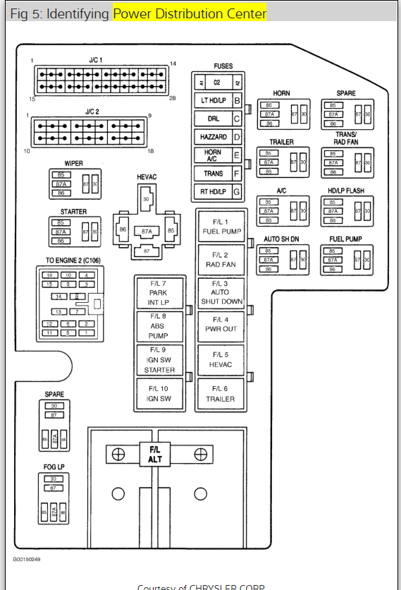

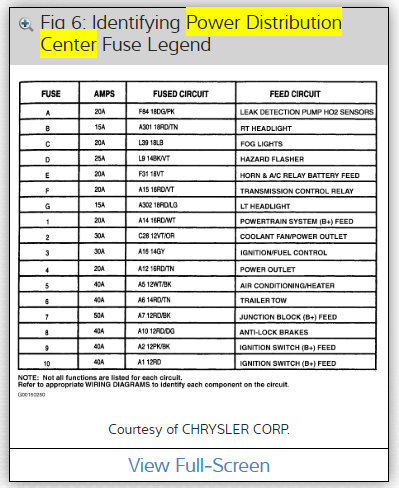

I attached a wiring diagram for you to view. Check for powers into the headlight switch.
Check for power with a test light. I think you have either a bad fuse or a wiring issue to the switch.
Feb 22, 2020 at 11:01 PM

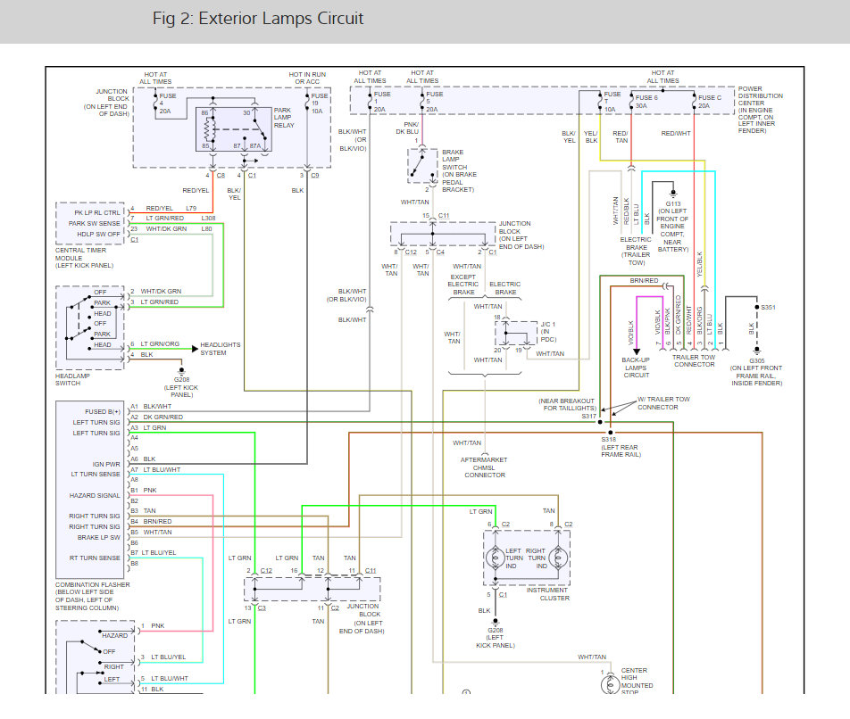

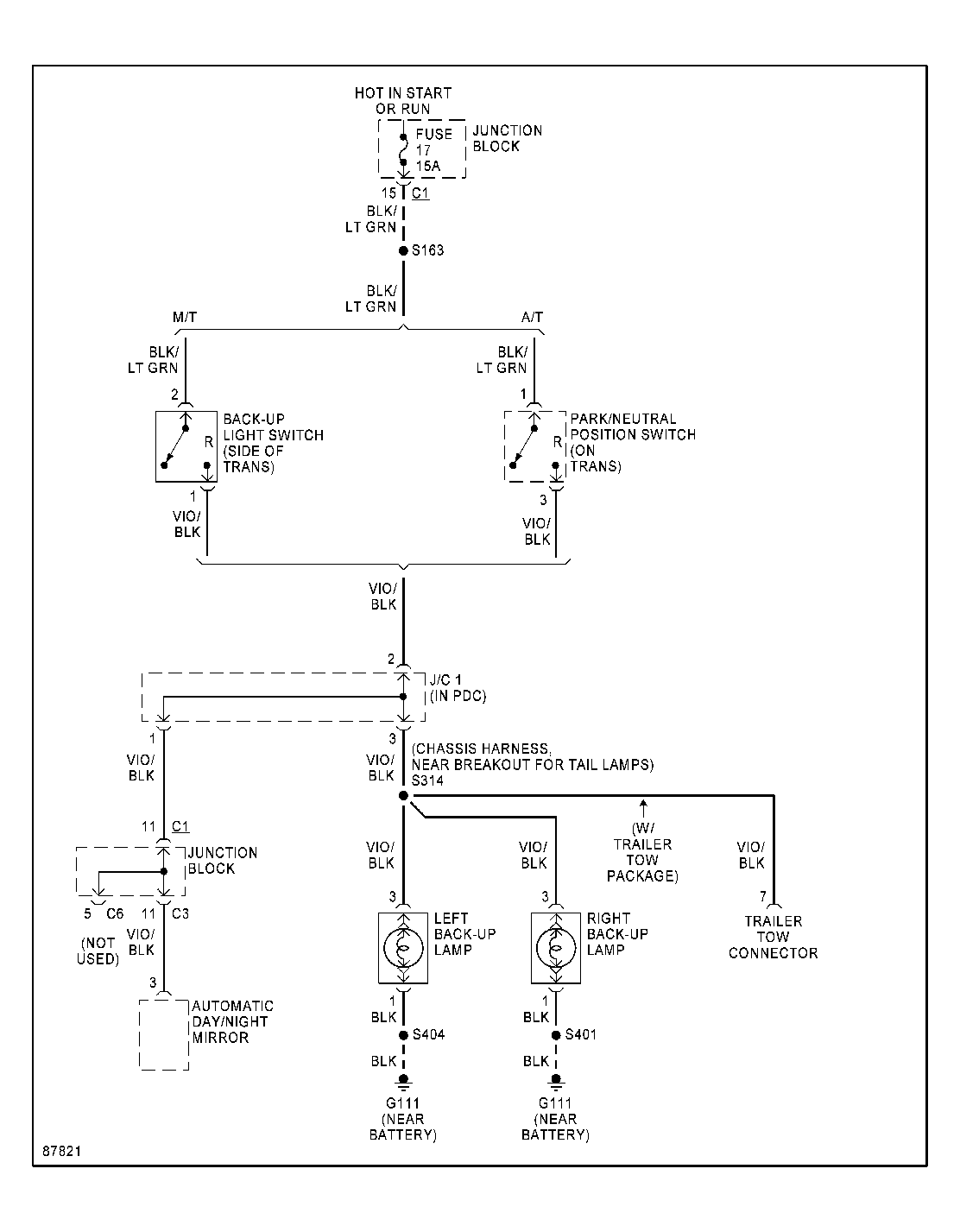

I have changed bulbs an small fuses don't know wat else could be hopefully you can help me don't have back up lights turn signals work brake lights work license plate lights don't work wat else do I need to do chaged the fuses in the fuse box in the cab and under hood small ones only its a dodge Dakota 4x4 98 model um that's about it
Dec 3, 2020 at 2:10 AM (Merged)
WRENCHTECH
  • 20,761 POSTS
The tag lights and back up lights are on entirely different circuits so the only way they can be connected is if there is a problem with the harness going to the rear. The tag lights are on the same circuit as the tail lights so if they work, the problem is in the wiring or tag light sockets. This guide can help with the tail light wiring diagrams below for your car so you can see how the system works.
Check out the diagrams (Below). Please let us know what you find.

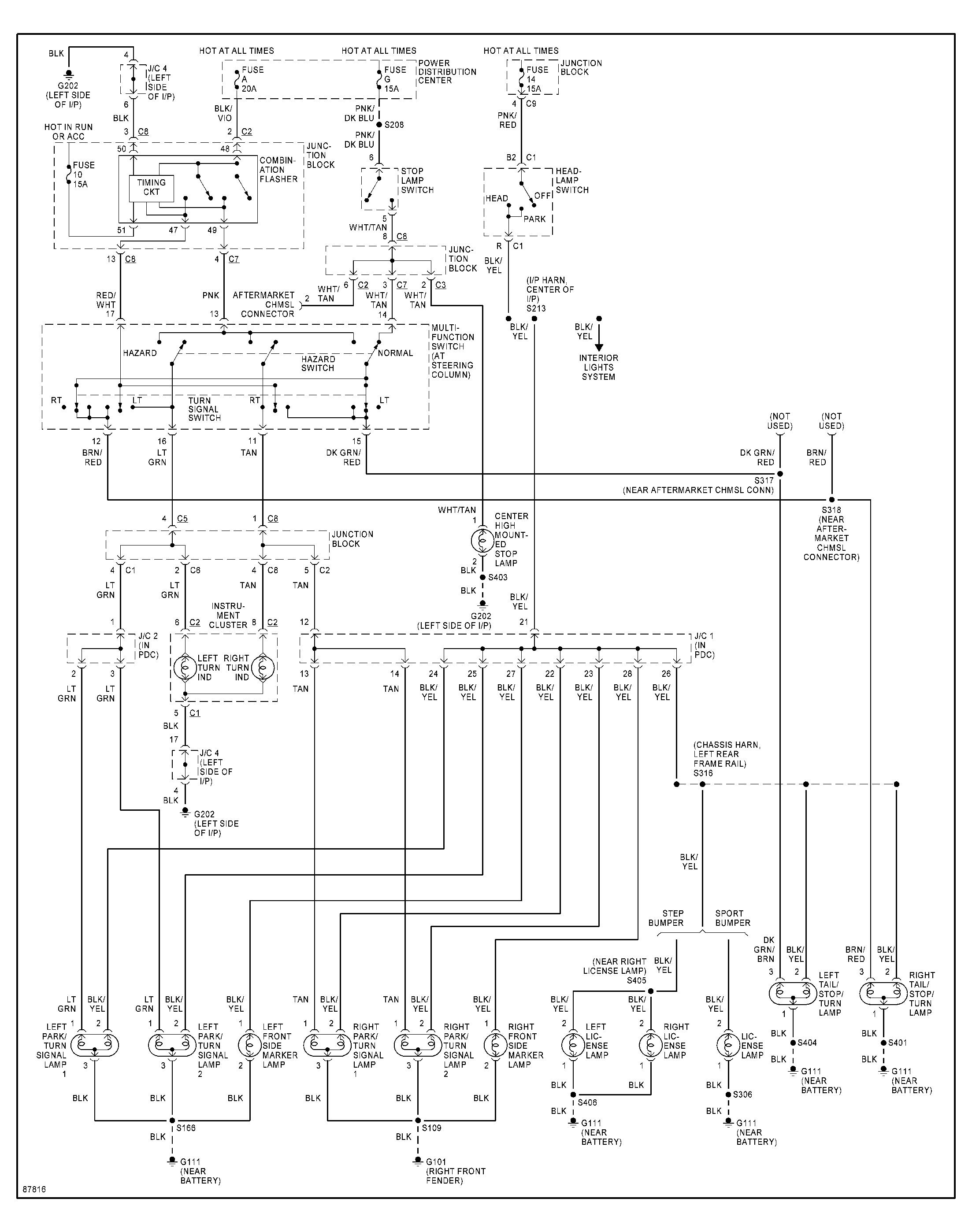

i just bought a 1997 dodge dakota extend cab sport how can i find a tail light wire diagram or brake light diagram ?
  • 110,240 POSTS
I have attached a schematic for the rear lighting system and the back up light syste.

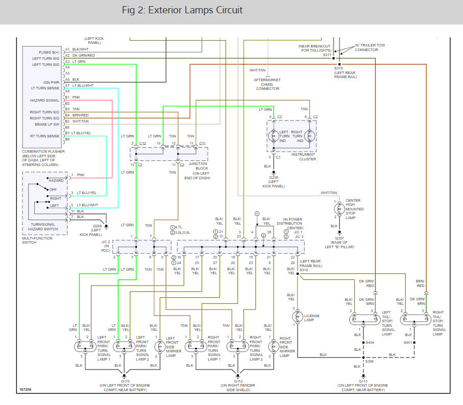

ok thank you may i ask on the plug factory plug that goes on tail light and brake light that plugs into each other theres a black wire that is cut from there any ideas where that goes ? or how to find out ?
EXPYOU
  • 10 POSTS

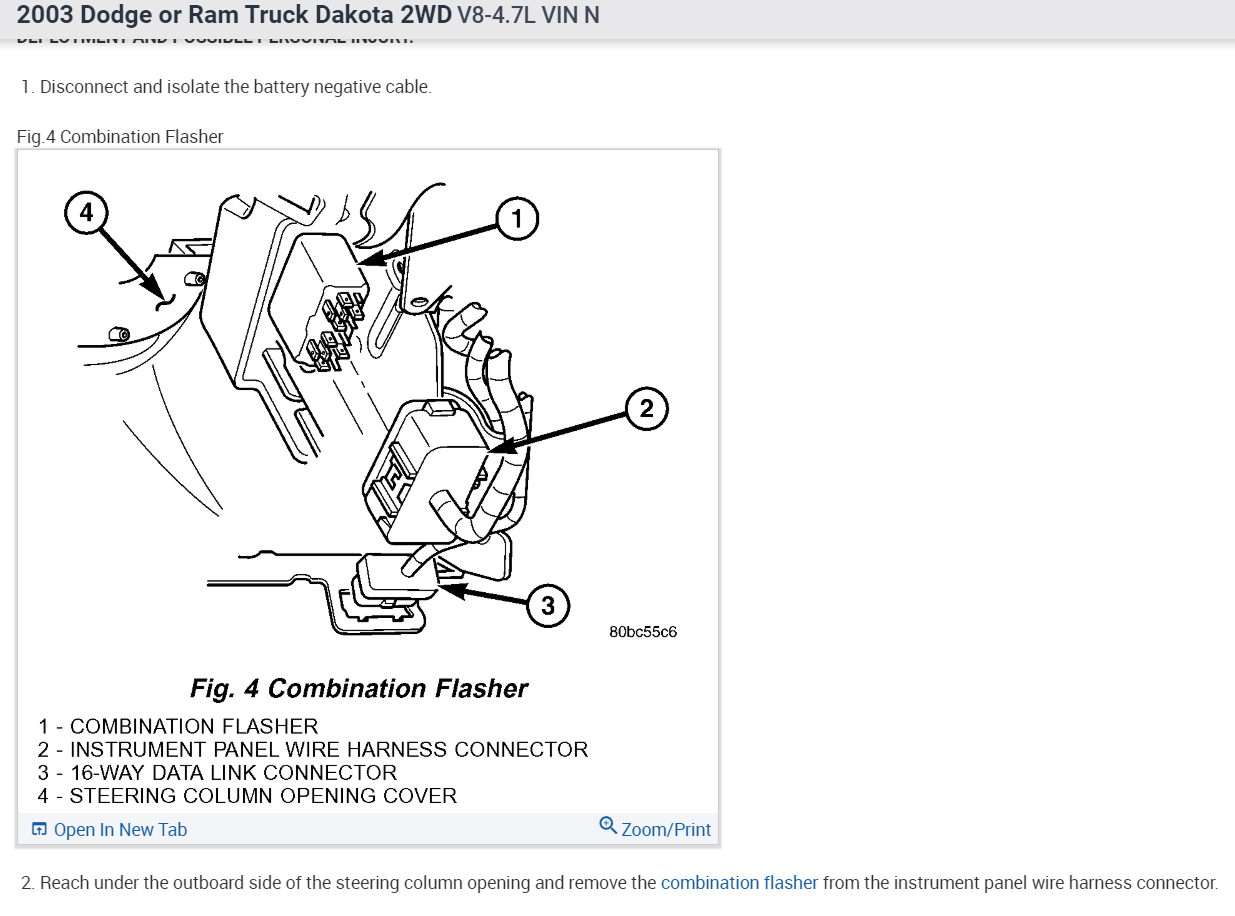

whats going on is i bought this truck and they had trailer wiring hooked up to it and when i turned the turn signal to the left it flashes fast both front and back work i press the brake without headlights or park lights on brake works.I took off the tail light cover on each side and noticed the implemts on the bulb on the passenger side is alot brighter and the passenger side aint. When u turn the lights on the brake light comes on and when u press the brake on the passenger driver side it dont light up. from looking at the plug piece on the wire loom i removed all the tralier wires setup they had and attached the t connection back together still same but on drivers side the piece that plugs into t connection one black wire looks like its cut so im tring to find where that wire goes to.
  • 110,240 POSTS
Check to see if there is any power to the black wire. Something tells me it is a ground. Also, are you sure the bulbs are good? Something to think about. A burnt out bulb causes the signal to flash really fast. On the Dakota, there are two bulbs in the front that flash. If one is bad, the other will still light (and trick you into thinking the bulb is good). However, the burned out one will cause a fast flash too. Just food for thought. I had a similar problem, both front and rear were flashing fast, and I assumed the bulbs were good. However, when I removed the front lens, one of the bulbs was bad and when replaced, everything worked.

the old headlight switch would not always turn the headlights on, so I replaced the switch with a new one from CarMax. now my running lights will not work, everything else works- dash, headlights. can you help
DOCFIXIT
  • 18,828 POSTS

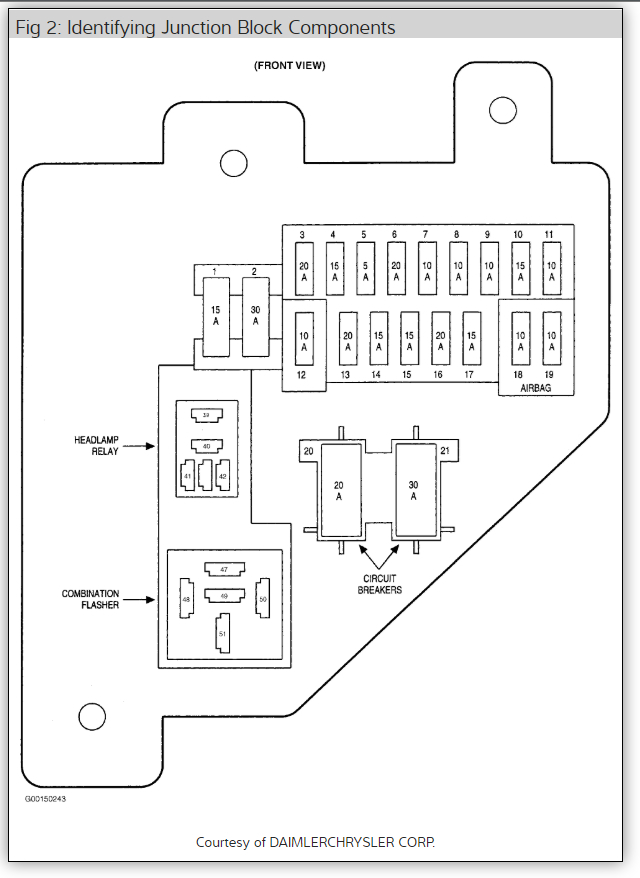

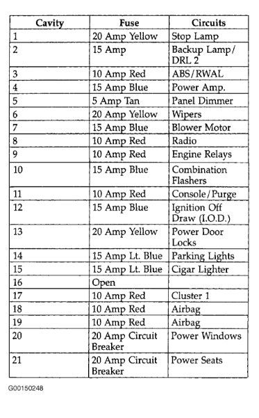

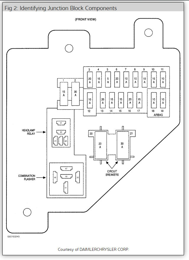

Check fuse #14 in junction box left kick panel

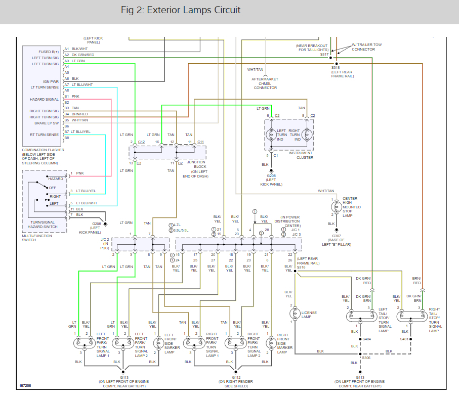

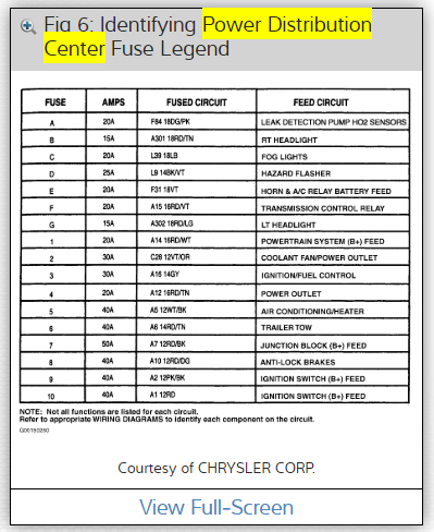

I have a 1997 Dodge Dakota Sport. My dash lights and tail lights do not work. Checked the fuses and it was blown. I replaced it everything was fine for a few days. Today got in truck rode down the road suddenly no dash or taillights. Fuse blown changed it and the fuse blew again. Please tell me how to look for the short or if anyone has any idea how to fix this I would greatly appreciate it . Thank you
Dec 3, 2020 at 2:11 AM (Merged)
CARADIODOC
  • 34,342 POSTS
A simple trick to finding a short is to replace the blown fuse with a pair of spade terminals, then use small jumper wires to connect them to a 12 volt light bulb. A brake light bulb works well. When the circuit is live and the short is present, the bulb will be full brightness and hot so be sure it's not laying on the carpet or against a plastic door panel. Now you can unplug electrical connectors and move things around to see what makes the short go away. When it does, the bulb will get dim or go out.
Check for a chewed up trailer wiring harness.
