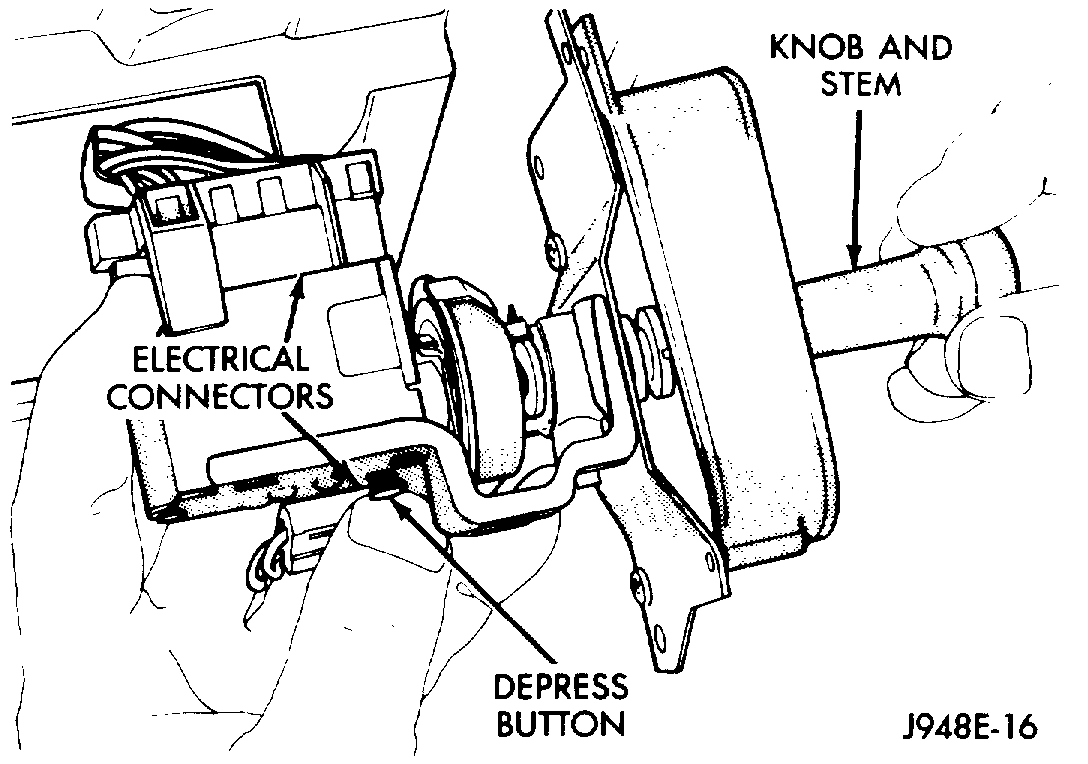

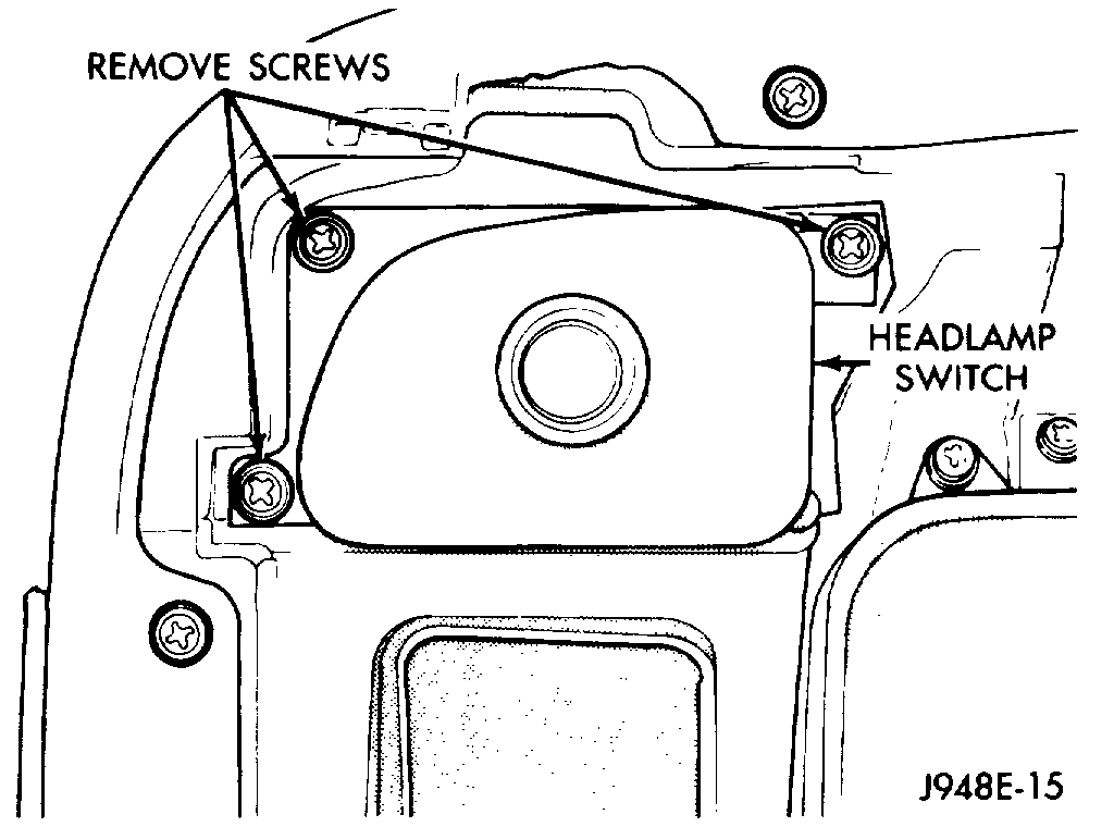

1. Remove the cluster bezel.
Headlamp Switch And Bezel Remove/Install
Pic 1

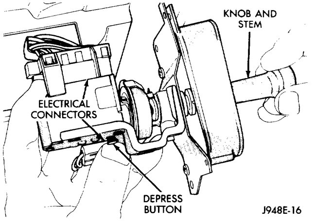

2. Remove the three screws that secure the headlamp switch bezel to the instrument panel.
Headlamp Switch Knob And Shaft Remove/Install
pic 2
3. Pull the headlamp switch and bezel out from the instrument panel far enough to unplug the wire harness connectors.
4. Pull the headlamp switch control knob out to its On position stop.
5. Depress the headlamp switch knob and shaft release button on the bottom of the switch, and pull the switch knob and shaft out of the switch.
6. Remove the two screws that secure the headlamp switch bezel to the switch mounting bracket.
7. Reverse the removal procedures to install.

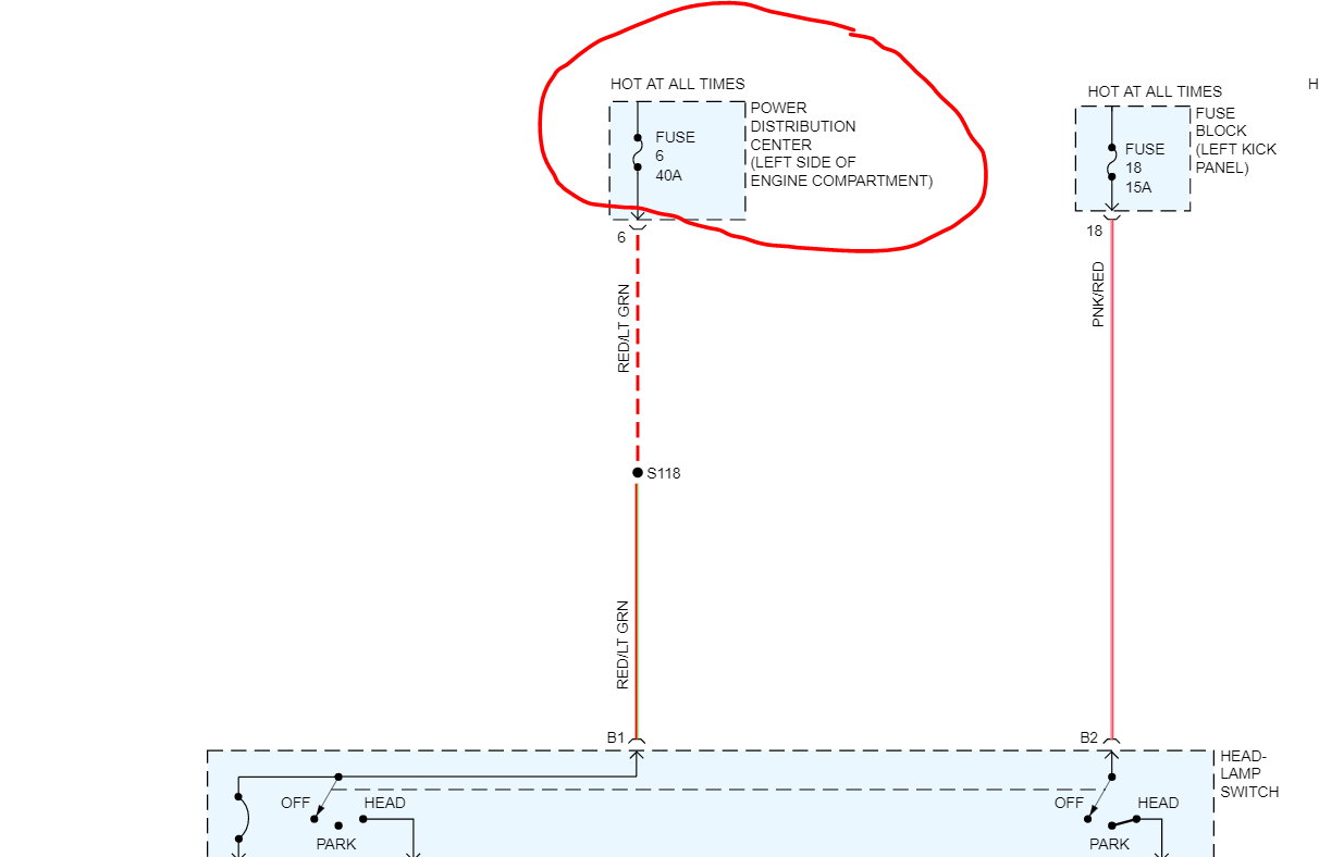

Also, there is a chance the fuse blew for the lights. It is in the power distribution box under the hood. I attached a pic for you to identify fuse number. (pic 3)
