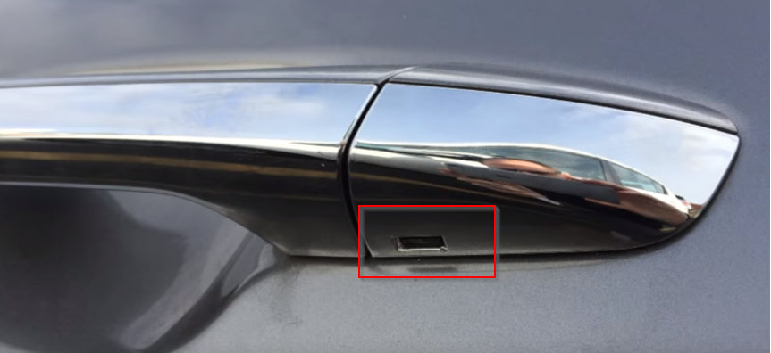

I was told cars with key-less entry always had to have a keyhole for entry without the remote in case the battery dies. This is the first car I've seen where nobody could find a keyhole. I don't want to use the remote but I'm forced to. It uses a key in the ignition though. Is the door keyhole hidden?
Jan 19, 2020 at 6:07 AM

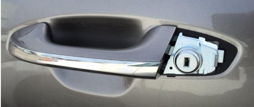

They made a change to this a few years back. It is hidden. You need to put your metal key into the slot on the bottom side of the piece of trim to the right of the handle. Then when you feel the button pressed inside there, just use your other hand to pull the cover up and off. Then you will find the key cylinder underneath.
I don't see that they have changed this so if this slot is no longer there because I have not checked a 2019, let me know.
It is disappointing that your salesmen didn't show you this. Please let us know if you need more info and we will be happy to help. Thanks

I just checked this at a second dealer and that salesman also was clueless about how to get in without the remote. He tried to use the hole on the bottom of the handle and couldn't. This looks like a tremendous disadvantage if one is in a hurry or it is raining since you have to look up at the underside of the handle. It's also a good way to scratch the paint when trying to put the key in nearly flush with the side of the door. He could not do it and had to get instructions from someone inside. When he got the keyhole cover off, he couldn't put it on without it falling off. I asked if it would work if I simply drilled a hole in the cover and he said that would work. A drain hole in the bottom might also be needed to be sure water wouldn't be trapped inside.
Now that I think about it more, the key is not long enough to use with the cover on and to keep the cover off exposes bare metal parts around the keyhole. It looks bad without the cover, like part of the handle has been broken off. Looks like I'll have to design my own cover.

About the keyhole being covered: It looks like I can extend the 'button' under the keyhole cap to stick out the bottom a little so I can push it up with my finger. Then I can keep the cover on but still remove it easily. Even if the cover was kept off, it's made of non-rusting metal. It can be camouflaged by painting it to match the car without having the paint interfere with anything as long as it's kept from the lock tumbler

Kia Corp CR couldn't find anyone at that location who knew enough about how the fobs were made. I went to the dealer telling them Corp says "they should know how to give me a key without a fob." The dealer eventually cut me a new key from a blank not attached to a fob at no charge. The car starts fine without the fob. I keep the cover off the keyhole to make entry easier. If I want to put it on, a short extension of the button allows me to remove it with a finger push. I have the original keys and their intact fobs as spares to sell with the car someday. Thanks.
