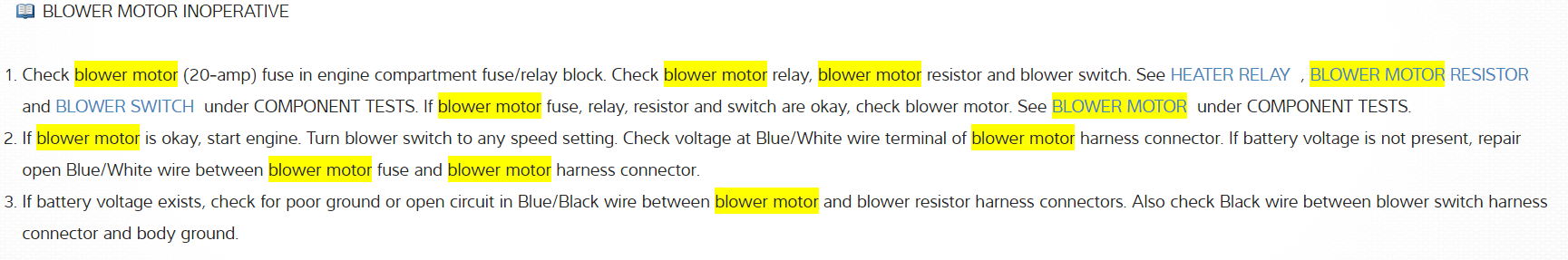

My heater blower or fan would stop blowing the air out of it. I would turn the fan off right away. I would wait five or ten minutes then turn it back on and the fan would work. Well it was extremely cold here in South Dakota and my fan stopped. I shut it off like I have done in the past but the fan still won't turn on. I have heat but no fan. I changed my heater blower resistor and that was not it. So what should I replace to get my fan to work again?

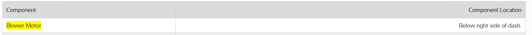

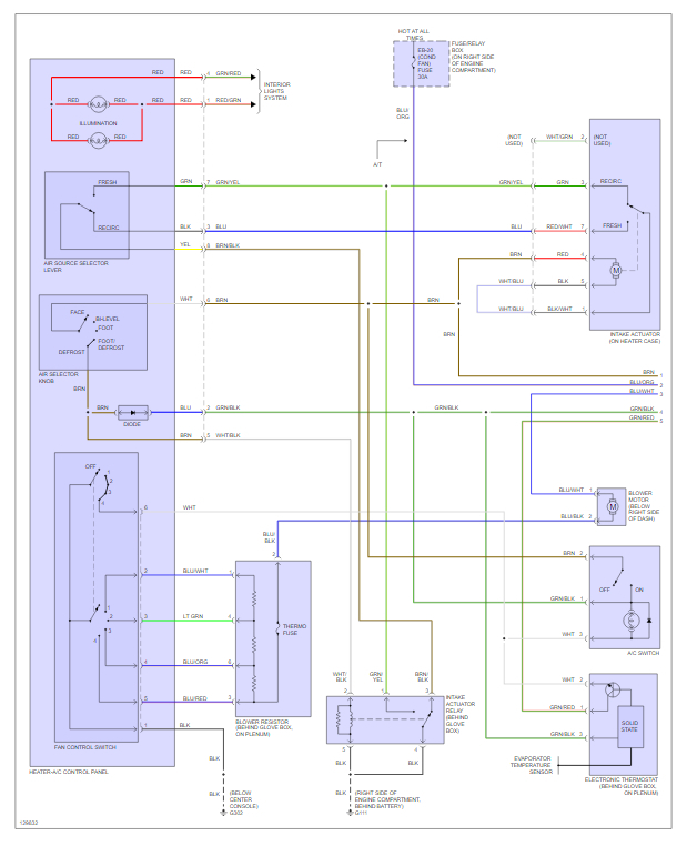

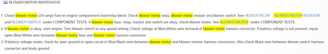

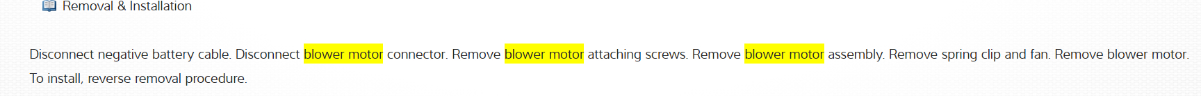

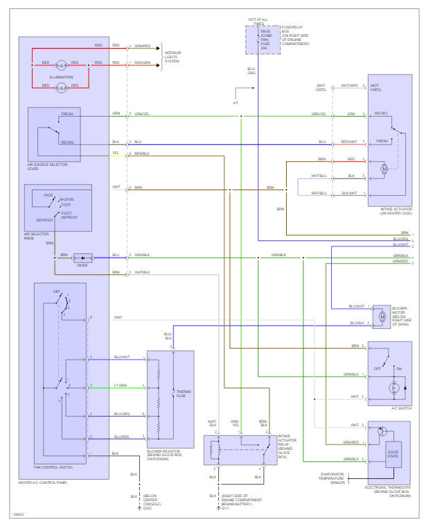

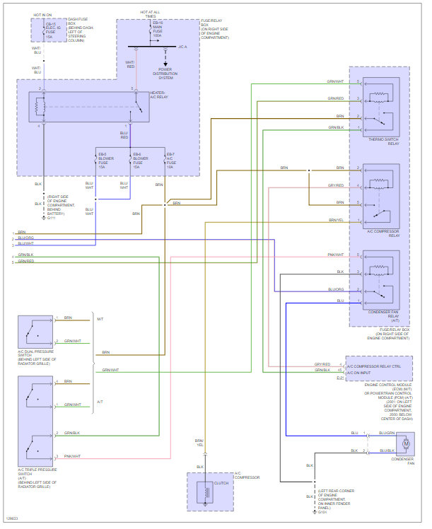

This could be a loose ground connection or the blower motor has gone out. I have included for you a step by step troubleshooting chart and guide with diagrams listed below.
https://www.2carpros.com/articles/blower-fan-motor-works-on-high-speed-only
I have also included component locations for you in the diagrams below as well. Hope this helps, and let us know what you find out.
