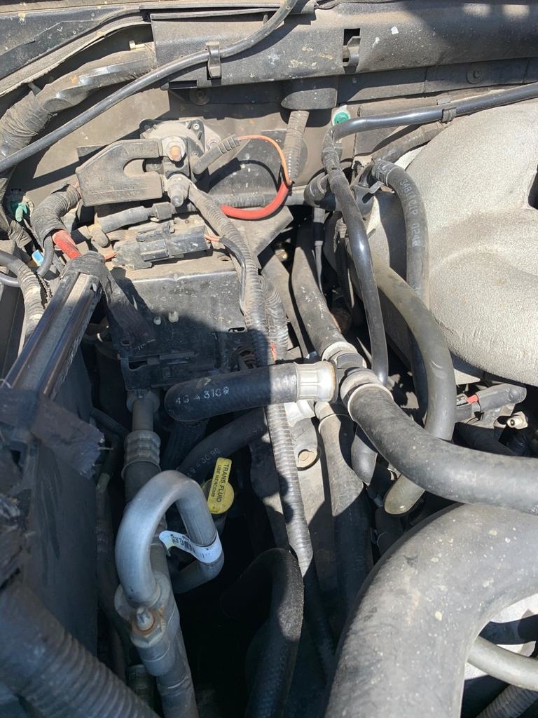

5. There were two heater hoses going into the firewall, one upper and one lower. Each of them is T-eed so that in total, you have 4 hoses going into the firewall. The Navigator has a rear heater, so I am guessing that the split at the T is to let one branch be for the front heater and the other for the rear heater. If this is not correct, please let me know.

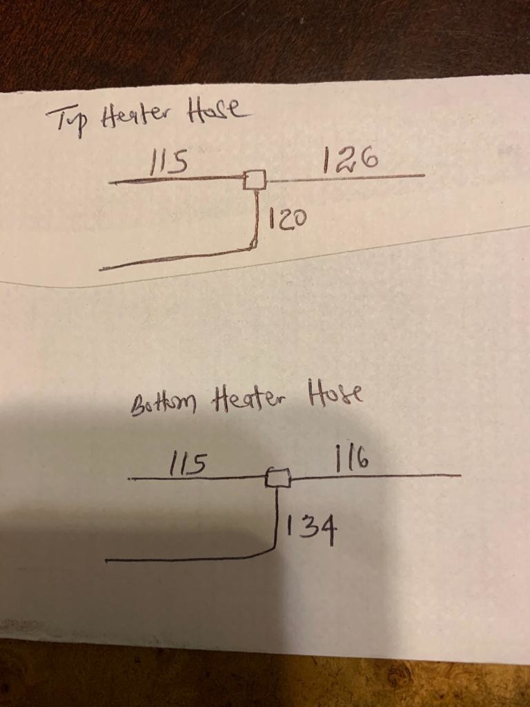

6. All the hoses felt warm to the touch. I used the infrared thermometer to measure the temperatures. For the top heater hose, the temperature for the line between the engine and the junction at the T was 126F, straight on the other side of the junction, it was 115F and on the T side (presumably the hose that goes to the rear), it was 120F.
7. For the bottom heater hose, the temperature for the line between the engine and the junction at the T was 116F, straight on the other side of the junction, it was 115F and on the T side (presumably the hose that goes to the rear), it was 134F.

12. Pictures below show the heater hoses in the hood as well as the temperatures described in paragraphs 6 and 7.

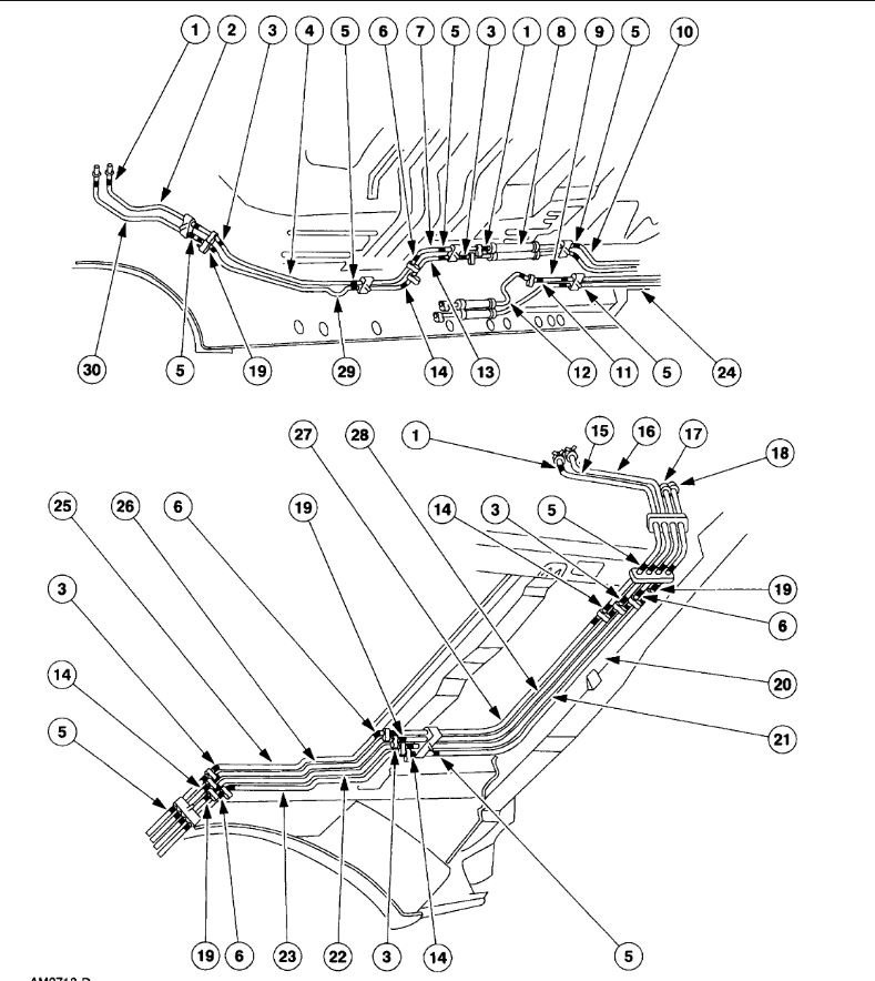

and if the temperature blend door needs replacement here is a guide that can help with diagrams below to show you on your car.

You are correct about the T's feeding the front and rear heater cores. From your description and measurements it sounds like a partially plugged heater core is the problem. Being this is an older design core I would likely try back flushing the core to see if you can restore the flow through it without replacing the core as that is not a fun job. Replacement requires the dash be removed, then the heater case and finally the core. To do a flush you would start by partially draining the cooling system OR you could use some pinch off clamps to clamp off the heater hoses, for that you will want 4 clamps, you need to clamp the hoses on the engine side of the T as well as on the hoses that lead to the rear heater. That way you isolate the front heater core. Now you can remove one of the heater hoses and catch the amount of coolant that will come out. Next disconnect the other hose. Now you will connect a flush gun or a garden hose to the heater core connection and flush water through it in both directions. For this the flush gun works better as it will agitate the water flow and break up anything it can during the flushing. Once you have flushed the core a few times you reconnect the heater hoses, remove the clamps and test the system. The amount of water added this way is minimal and just adding fresh coolant to top up the system will resolve that.

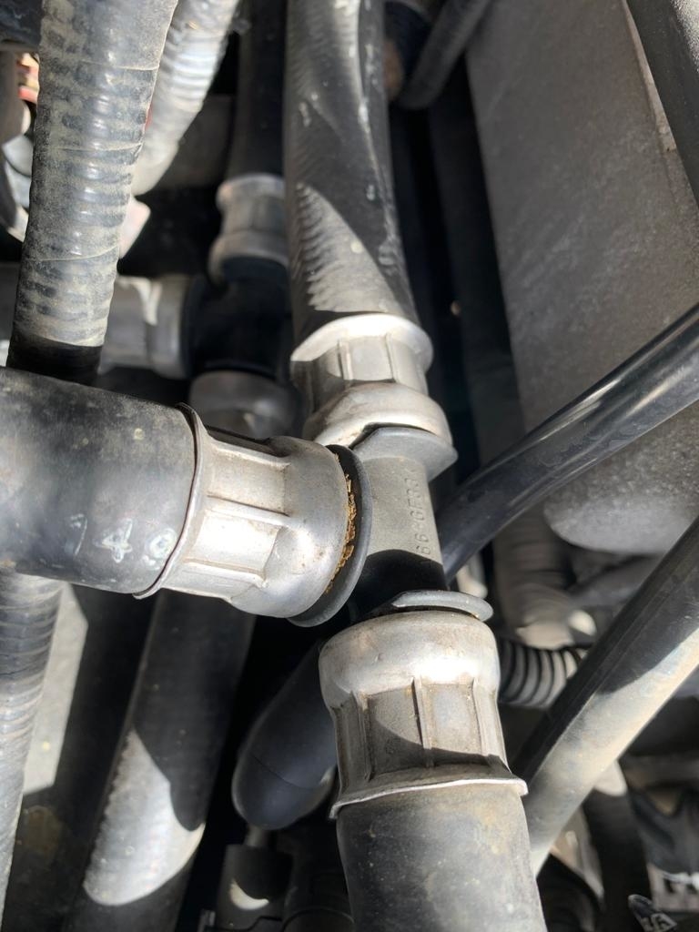

2. Can you give me some advice on how to remove the metal crimps surrounding the hoses near the T so I can connect the hose to flush the system? Or do I have to cut the heater hoses? In the Navigator, I cannot directly see the connections at the firewall and it will be very difficult for me to connect the flush kit there.

The problem with the temperatures being a valid test is that the T connectors make it suspect. On a single core the heat goes in and stops, with the two cores the heat makes it through the rear core and then causes the water on both sides to have the same temperature. If the front core was flowing properly you would have one hose hotter and the other one colder on both cores. You show both of the hoses for the front core at the same temp which shows no flow.
The crimps cannot be removed without damaging the hoses. You would need to remove the lines from the core or the engine side to gain access.

No real diagram of the hoses other than what is attached, the front ones T off and go under the truck to the rear unit. The same applies to the refrigerant lines.

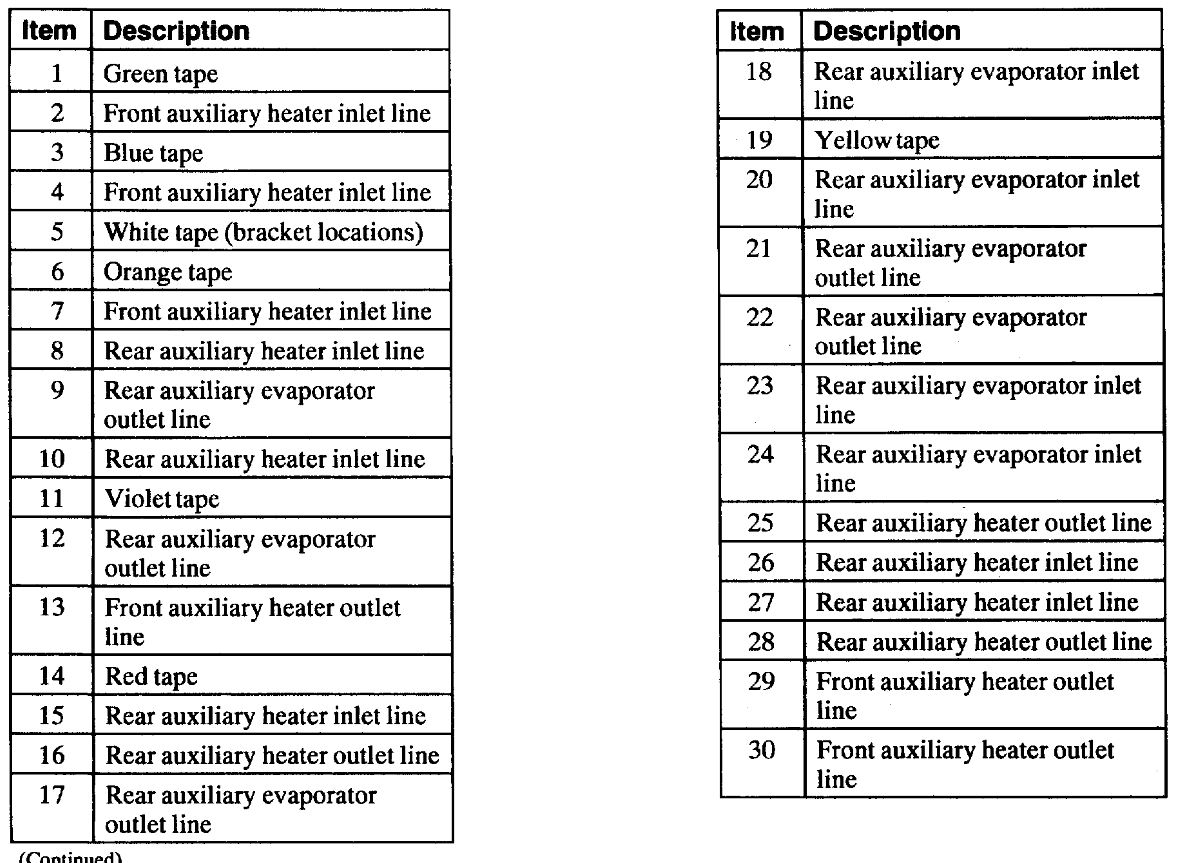

3. Can you include the names of the various parts shown in the diagram that you posted? Thanks.

Can you include the names of the various parts shown in the diagram? Thanks.

It depends on the vehicle but most with automatic controls run both AC and heat to dry out the air coming into the vehicle depending on the exterior temperature and humidity. Hmm, the list was supposed to be attached,. here it is:
