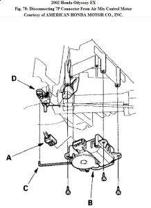

I have the van listed above with heat issue. My van does not have AC. When I turn the heat, cold air comes up. I first took it to mechanic where he changed the the heater valve but still no heat, then he flushed the heater core, the heat came up fine that day but the next day there was no heat. I changed radiator where there was leak and I changed thermostat too. I did not flush heater core when thermostat replaced though. I should mention that both heater core lines are equally hot based on the mechanic, does this that mean I would need to change the heater core? Please help.

If both heater core hoses are equally hot, then that indicates that the heater valve is working and that the core is not clogged. Basically, it implies that the problem is elsewhere. Maybe it is in the blend air door actuator(s), the blend air door itself, or the HVAC control unit (the control board in your console). The blend door (aka air mix control door, as Honda calls it) basically directs the incoming air either to heat it or cool it, depending on your choice. It is not uncommon for the actuator that operates those doors to go bad and have the door stuck in whatever position it happens to be in at the time.

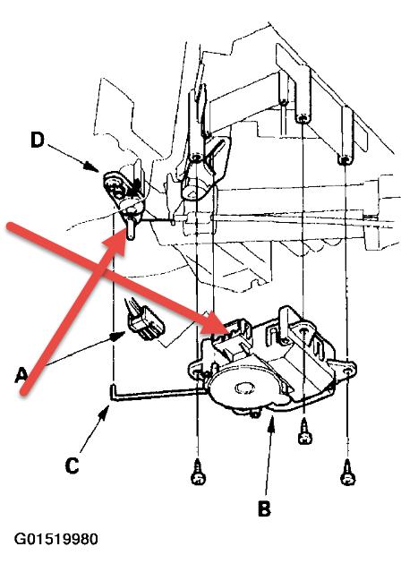

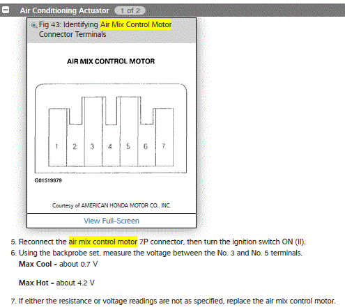

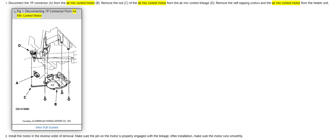

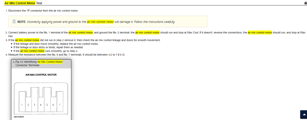

I am attaching a diagram indicating where the air mix control motor is on the HVAC assembly box and some instructions on how to test and replace the motor. If you can get to the motor, then run the test on it and let us know the results. The HVAC box is located behind the center console. Unfortunately, I do not have much information on how to access the air mix door motor or anything like that, so you will have to wing it.

check coolant level first. check to see if your air mix motor works and or the linkage has fallen off check mode door for proper movement. Check out the diagrams (Below). Please let us know what happens.

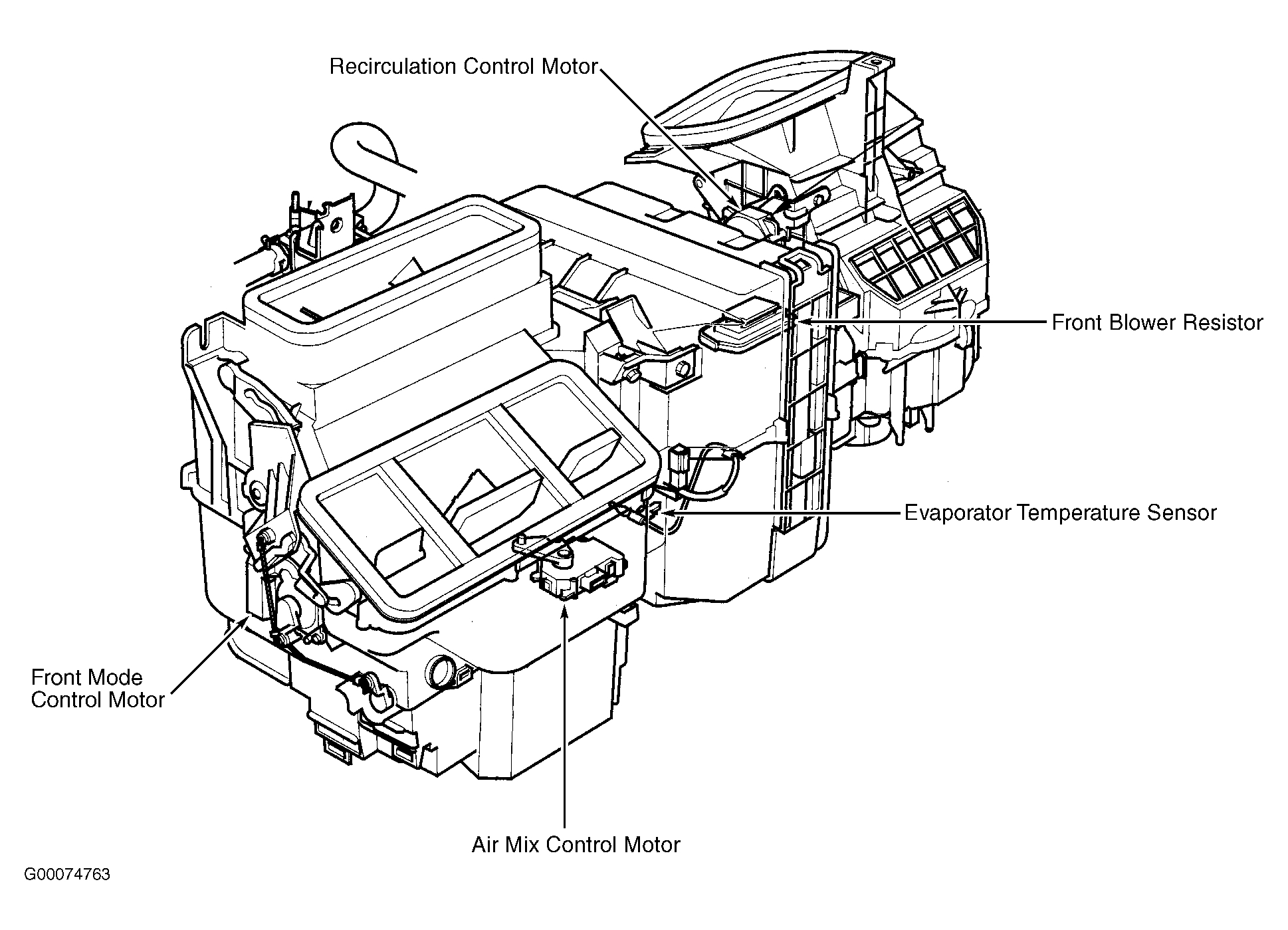

Hi ghondaw, Check if both heater hoses in engine compartment are hot when heater is turned ON. If yes and tyou do not have heat, the most likely cause would be the air mix motor, either it is faulty or stuck.
https://images.2carpros.com/forum/automotive_pictures/192750_AirMixMotor02OdysseyFig78_1.jpg

I have a problem with the heater in front not blowing hot air. The rear works good but the front is Luke warm. I have checked the blend door and the motor, both seem to be working good, I've bled what I think is all the air out of the system when I flushed the radiator. If this helps, when I looked underneath where the blend door is, when the temp is turned up all the way the arm is not going all the way to the end of the track for the blend door. It looks like it is leaving it open just a little. Could this be the motor that controls opening and closing the door or the climate control panel?

Have you checked to see if both the heater hoses going to the heater core at the firewall are getting too hot to hold?

Sorry for not getting back sooner, but no. The hoses are warm but not too hot to touch. Both the front and rear are blowing warm but not hot. Could the heater core be so clogged that I need to flush it itself?

Could be but usually when the heater core is clogged one hose will be too hot to hold while the other hose is cool to warm.

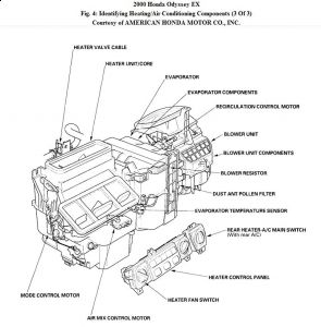

The front air mix doors are not operating correctly causing the problem. Check if the air mix motor is working when the heater is turned on.
Dec 14, 2020 at 11:54 AM (Merged)
KHLOW2008
  • 41,812 POSTS
The air mix motor is located on the heater housing under the dash.
https://images.2carpros.com/forum/automotive_pictures/192750_HeaterAssy00OdysseyFig04_1.jpg
