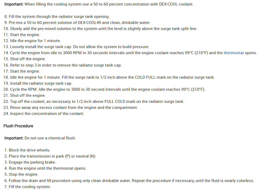

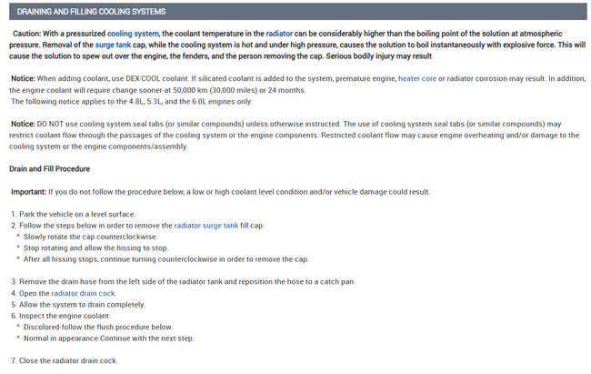

Hello, it sounds like you may have an air pocket stuck somewhere, or the heater core may have become clogged up with the gunk, I'll call it, that can build up in the system. Did you drain the entire system and when refilling did you go through any type of air bleeding procedure? I will post the service info on the 'Drain and Refill" section for you.
Just make sure to never open the cooling system when the vehicle has been running, you can be seriously burned, don't ask how I learned that hard lesson a long time ago.

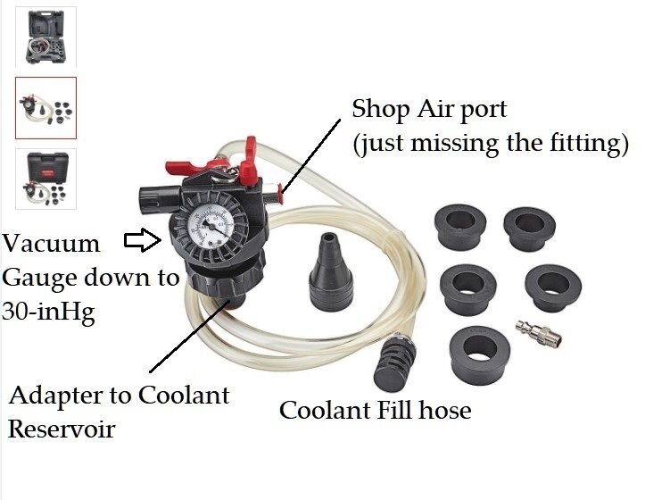

These are the refill procedures, but really the best fastest and easiest way is to buy a vacuum cooling system refill kit, it works with shop air, pulls all the air out of the cooling system and holds a vacuum for a couple of minutes to verify there are no leaks, then you just put the hose from the unit into a gallon jug of coolant and the vacuum the system is under will just draw all the coolant right into the reservoir in just a couple minutes, with no air in the system at all. I will never go back to using any other method unless it's for some unknown reason.
This is the unit (3rd diagram).
