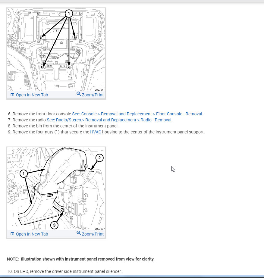

Engine comes up to operating temperature and vehicle has no heat in cabin. Other days it heats up just fine. On a day it did not have heat I accelerated very hard and moments later I had heat and continued to have heat that day. Next day no heat.
Nov 22, 2019 at 3:19 AM

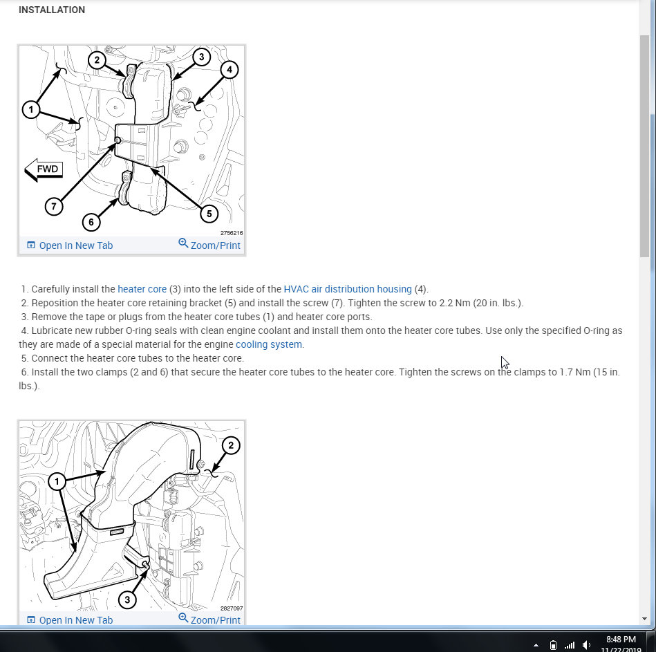

This is one of two things in my mind. Either the heater core is plugged partially or the blend door actuator is not working all the time. The fact that you accelerated hard and it started working makes me think it is a heater core issue but it could just be a coincidence.
https://youtu.be/SNRb6pSwYuU
Here are the procedures for both but I would suggest starting with the actuator and go from there.
Nov 22, 2019 at 9:53 AM

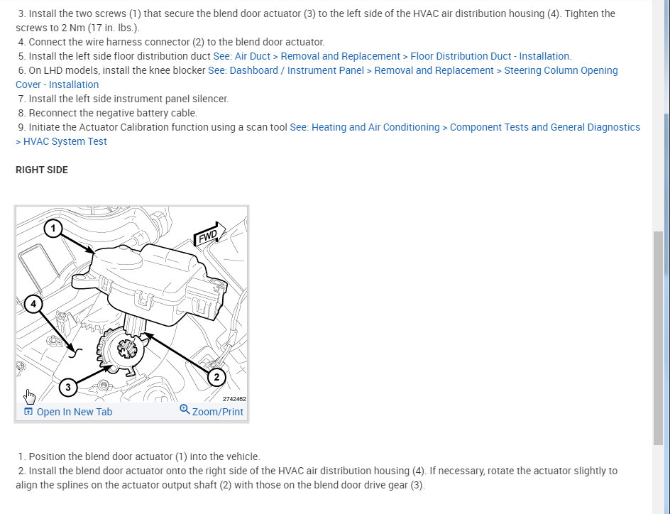

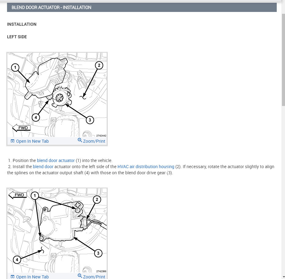

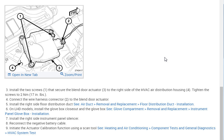

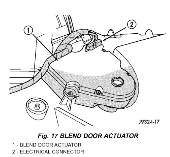

Hello, I'm Danny

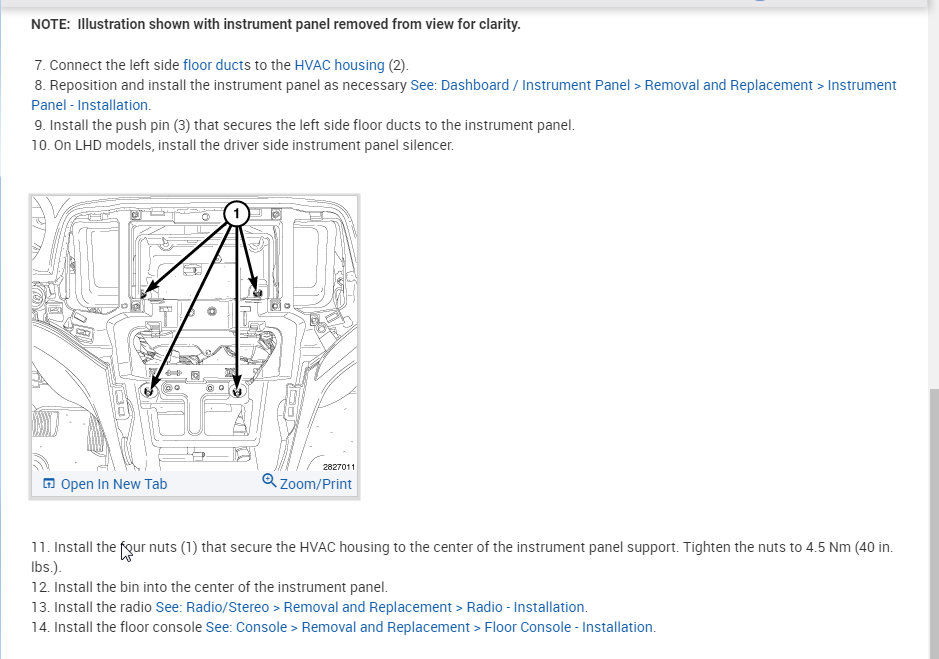

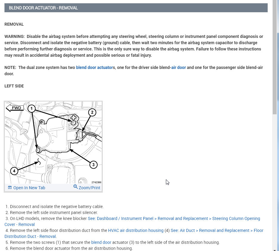

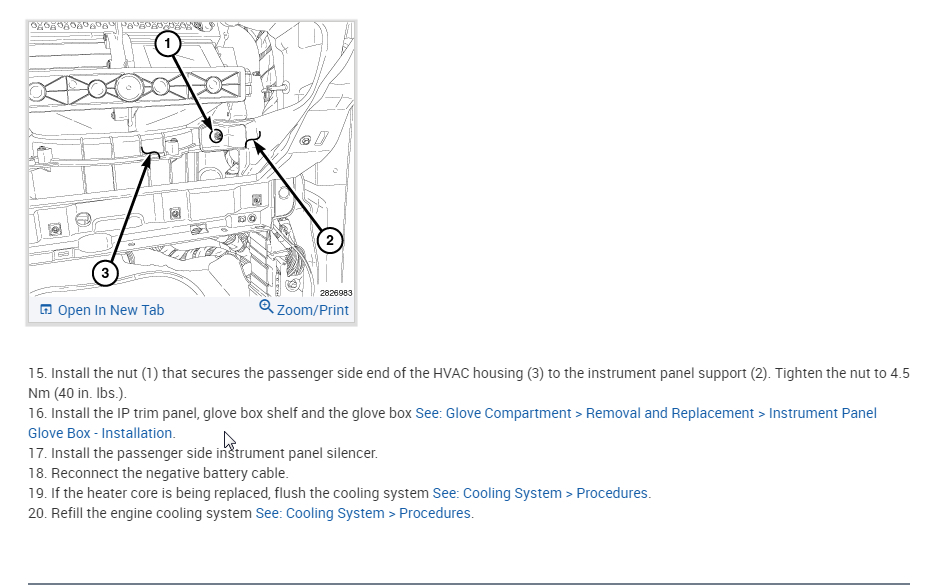

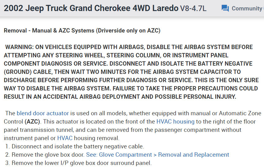

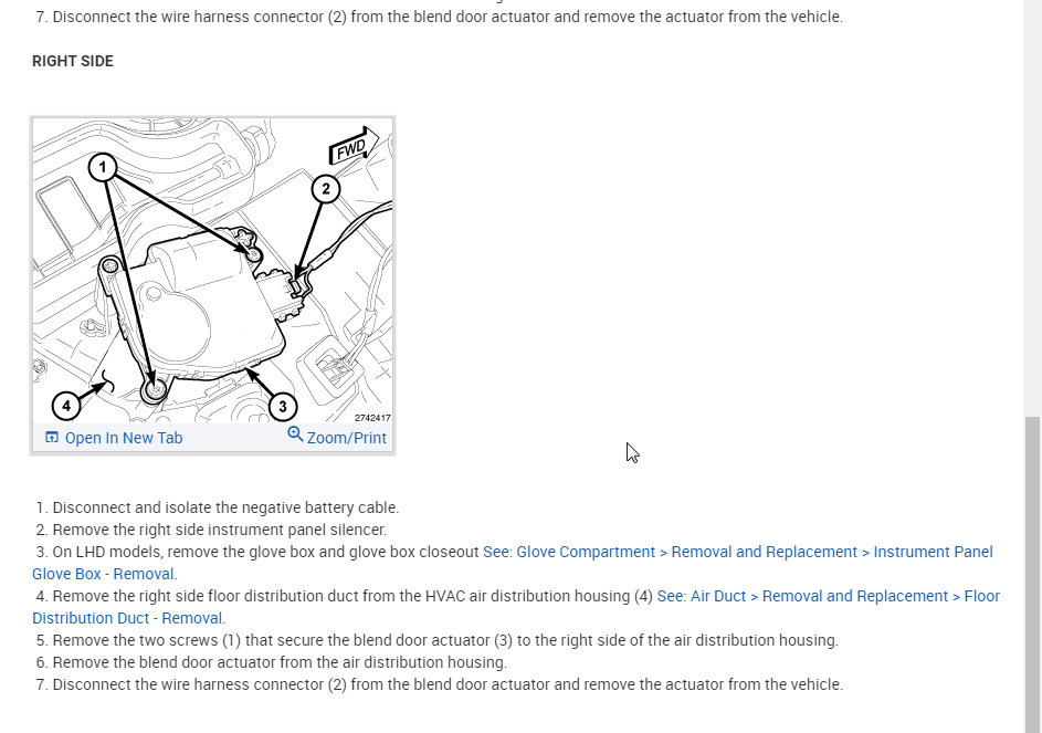

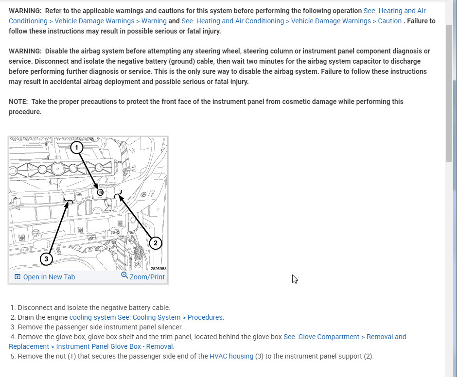

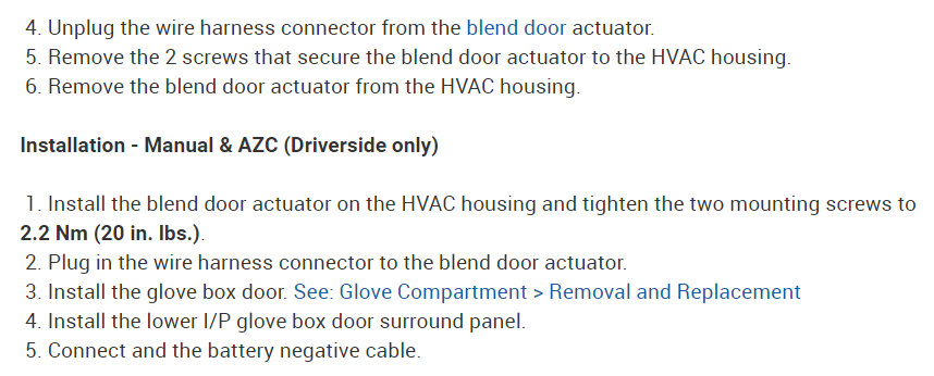

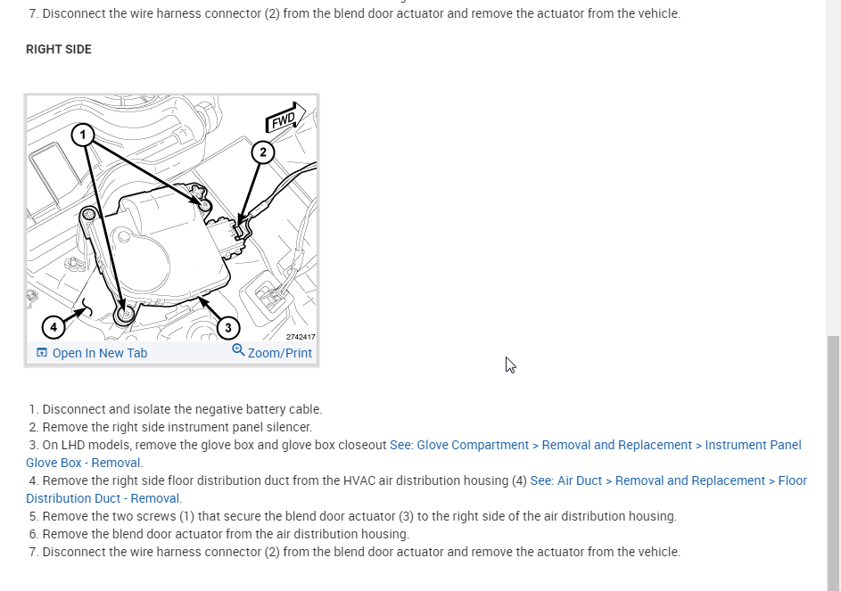

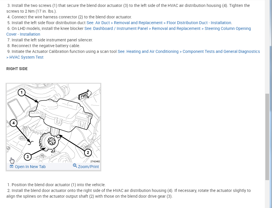

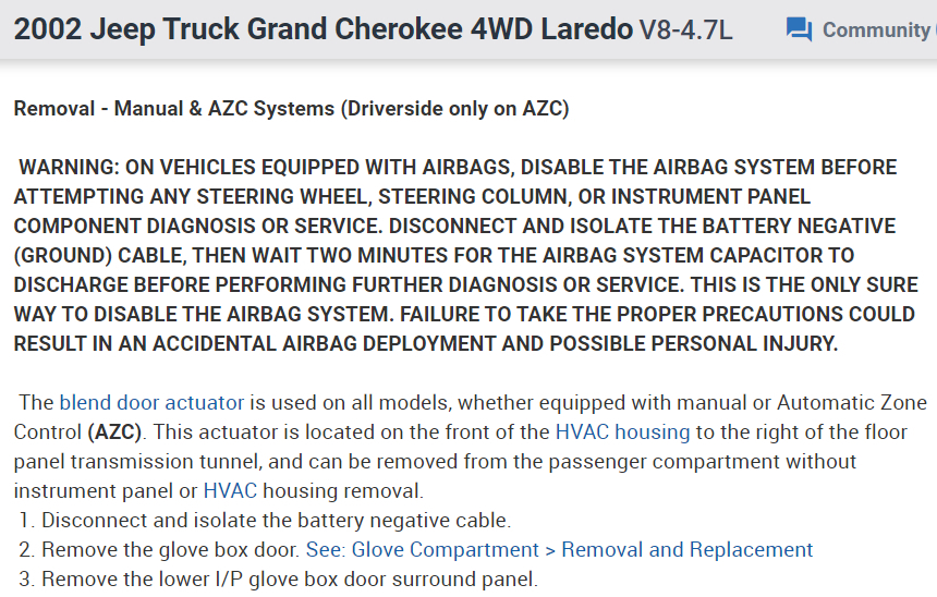

It sounds like you are having an issue with the blend door actuator. It's a small electric motor that opens and closes a door to flow hot air throughout certain air ducts. This actuator is mounted on the hvac box which located under the dash board on the right side. Here is a tutorial showing how to replace the blend door actuator.
I've attached picture steps below for the replacement of the blend actuator on your Jeep. Hope this helps and thanks for using 2CarPros.

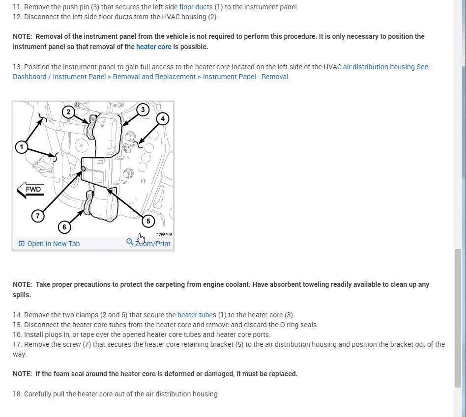

  • 110,240 POSTS
Check both heater hoses to make sure they are hot. If they are, check the blend air door. If only one is hot and the other warm and the coolant is full, chances are the heater core needs flushed.

  • 110,240 POSTS
Check to make sure the heater core isn't partially plugged as well as check the blend air doors.
