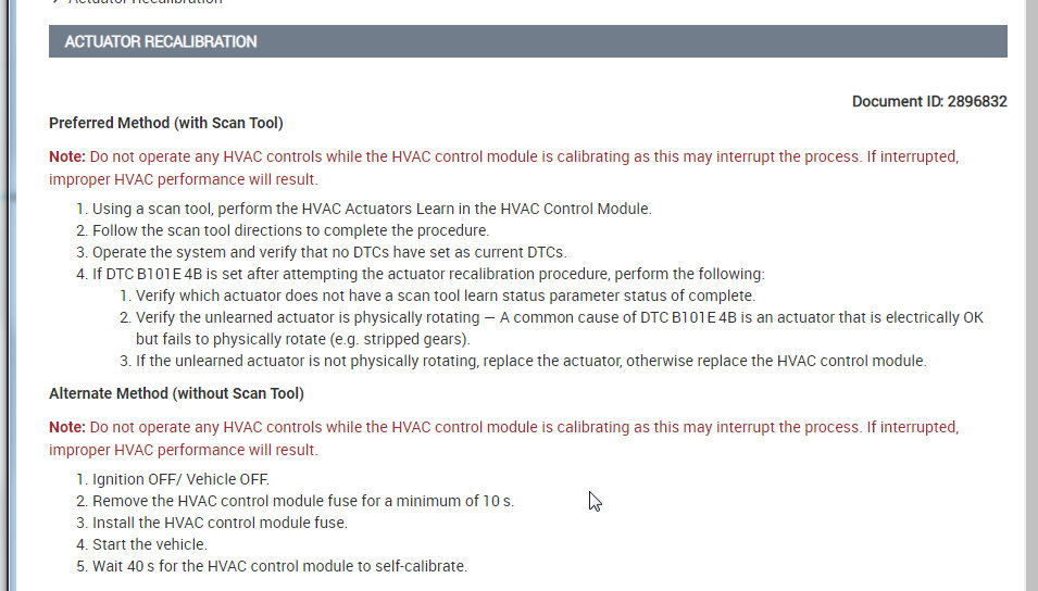

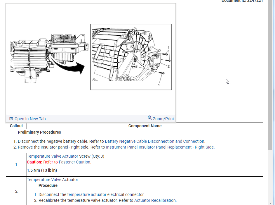

Below you will find the process on how to replace the actuator which is what I suspect this is. However that may change when we find more out about the fan. Thanks
