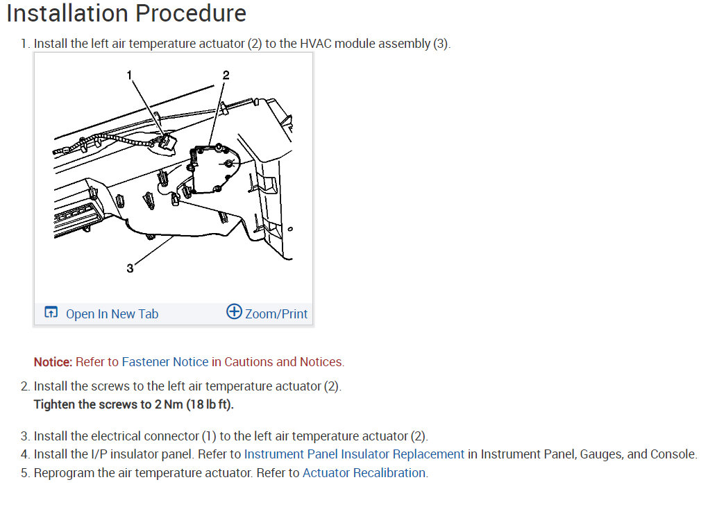

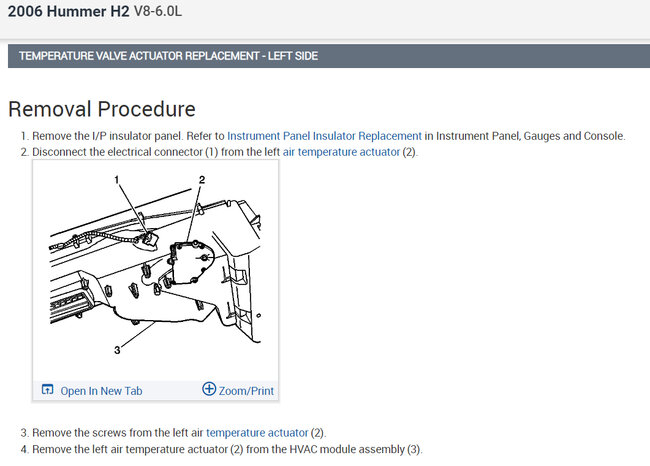

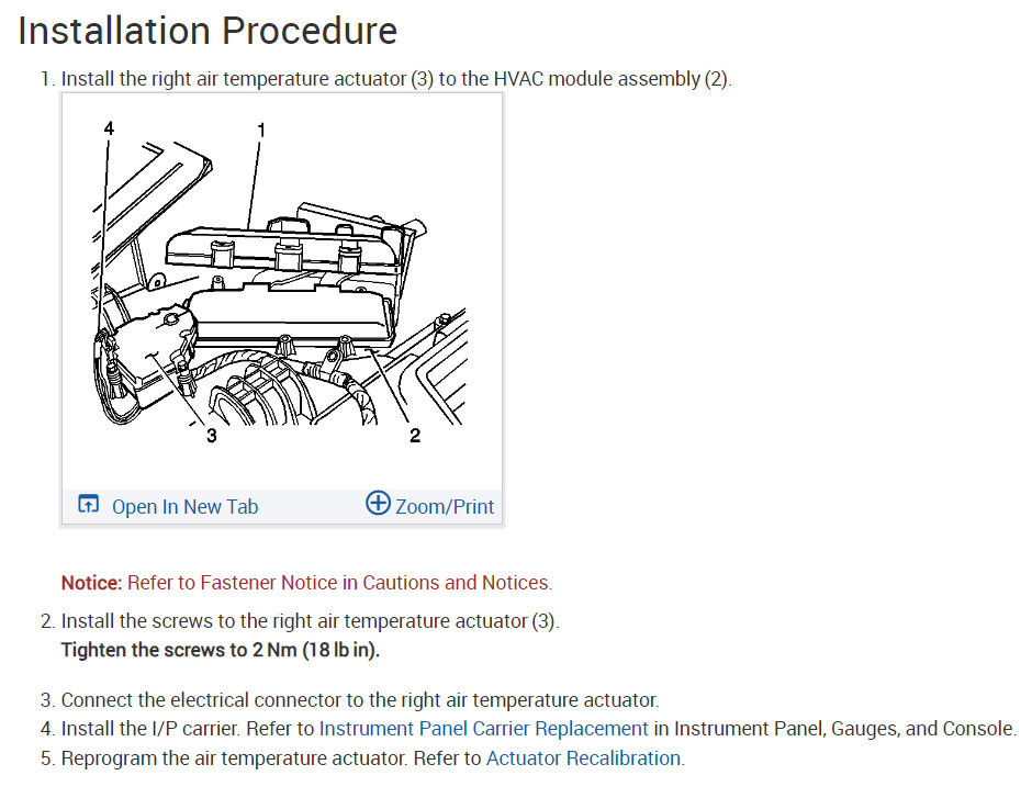

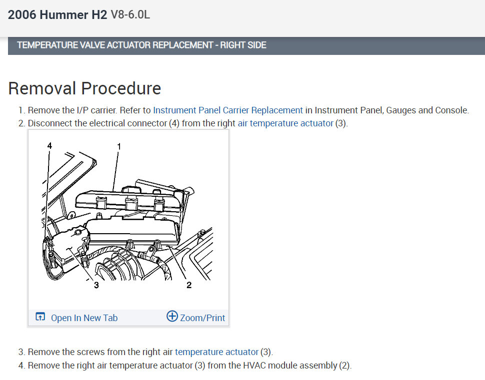

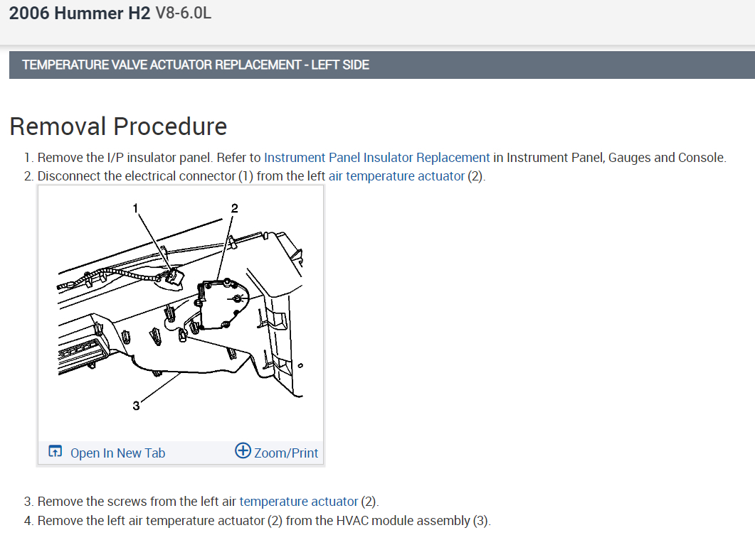

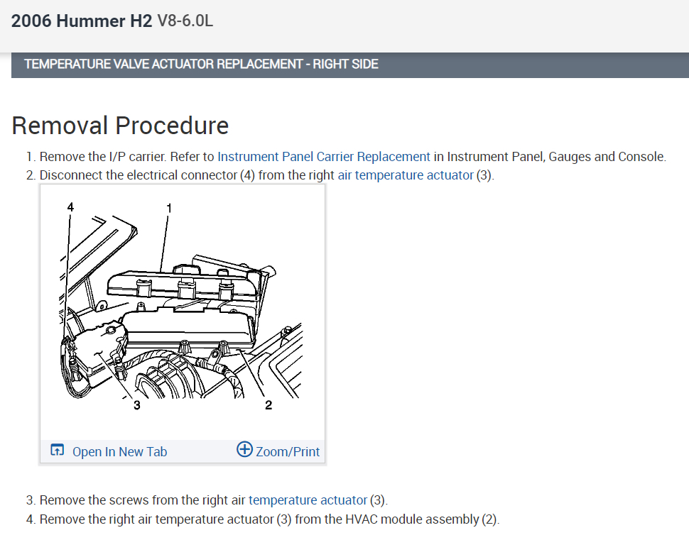

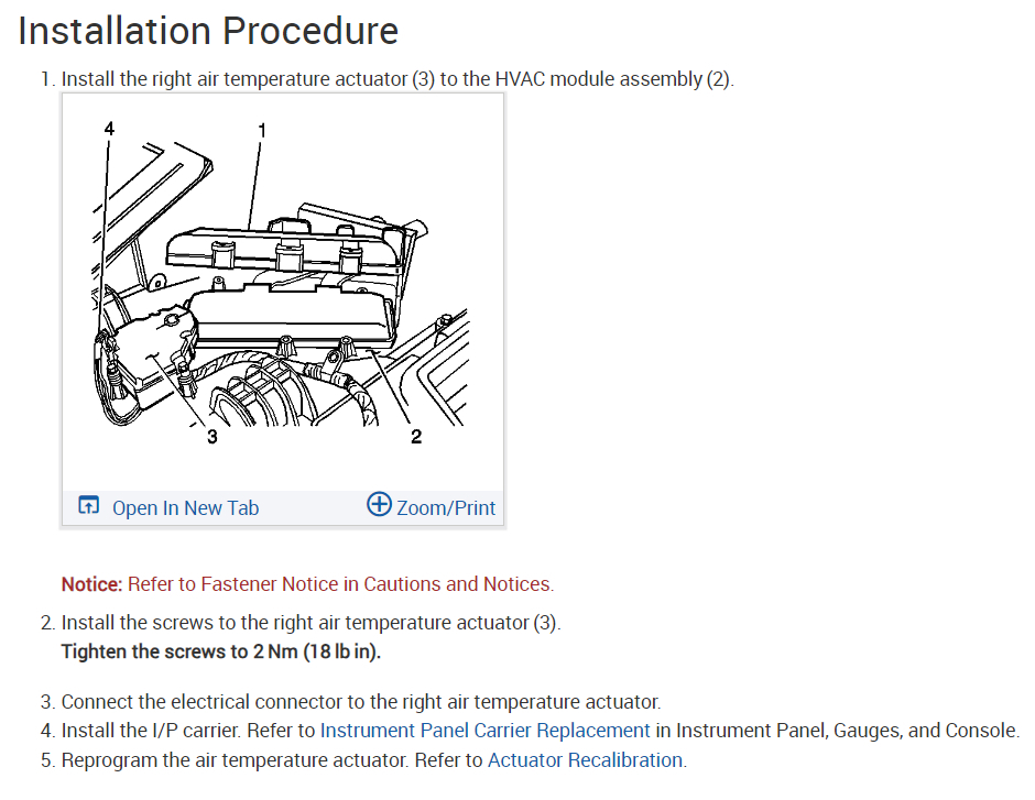

There is no heat going to the heater and defrost?
117,000 MILES • 6.0L • V8 • 4WD • AUTOMATIC
RICHARD ARNOLD
A/C works great but no heat either side or defroster.
Feb 7, 2024 at 10:47 AM
  • 55,721 POSTS
The first thing I would do is wait until the engine is cold and then check the coolant level, here is a guide and video of what you should do as a preliminary inspection:
and
https://youtu.be/SNRb6pSwYuU?si=dUsW2xPbLmqeVxXW
If everything looks okay here is the temperature blend door actuator which sounds like it is not working. There is one for each side.
Please check out this guide and the images below.
Check out the images (below). Please upload pictures or videos in your response to the problem so we can see what's going on.
