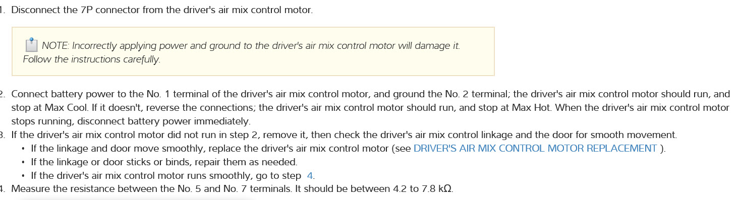

I have no heat no matter how I adjust the controls. The air conditioner works great but when I try to get warm air I only continue to get cold. I have checked the relays, fuses and air mix motors. I would greatly appreciate any advice.

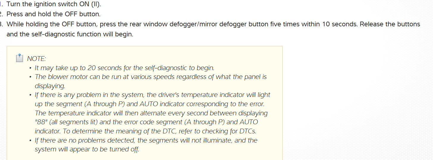

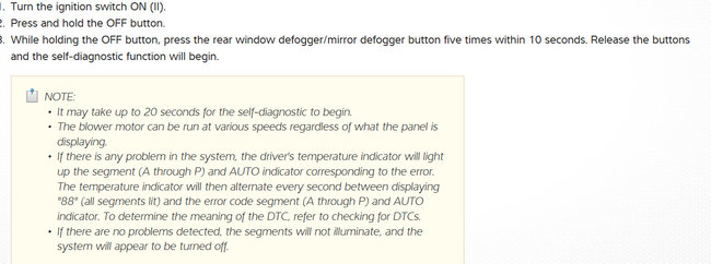

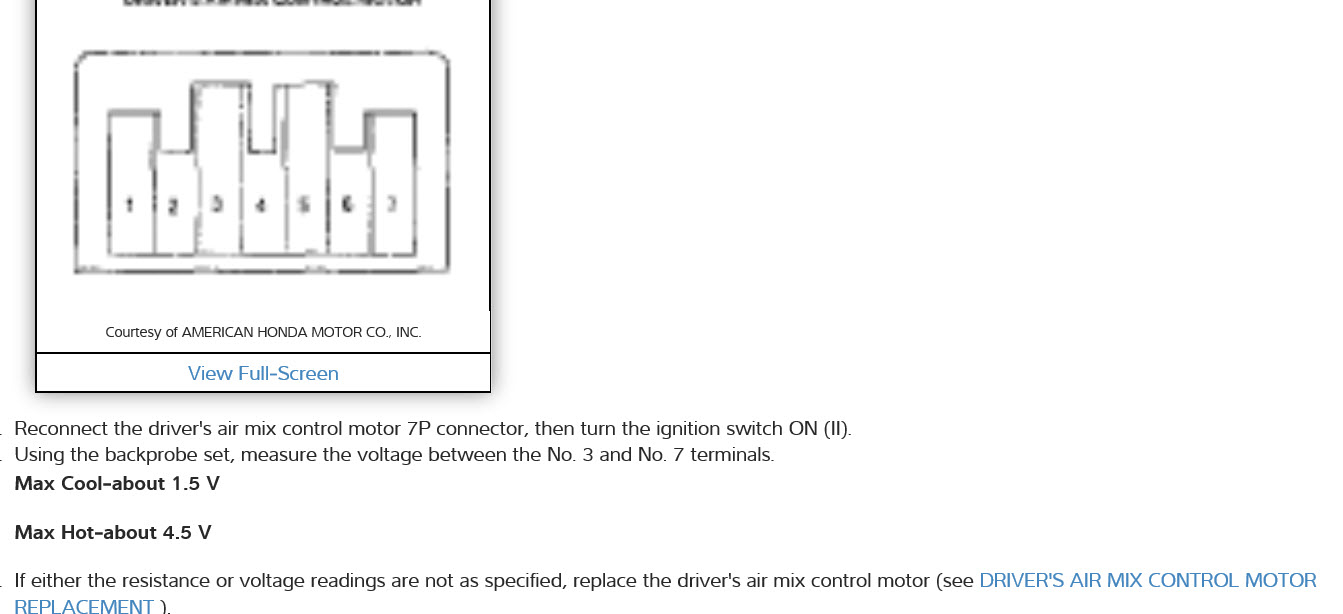

try pulling HVAC fuse inside car for sixty seconds with key on then reinstall it may reset the actuator then see if you get heat. if this is auto temperature control where you set temperature then follow what is in picture and get back to us so we can help figure it out. we will need the codes so copy them.

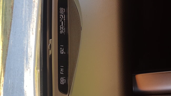

BAMABOY0911

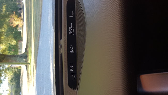

I ran the self diagnostic and these are the images that appeared
Oct 22, 2016 at 7:01 AM
HMAC300
  • 48,601 POSTS

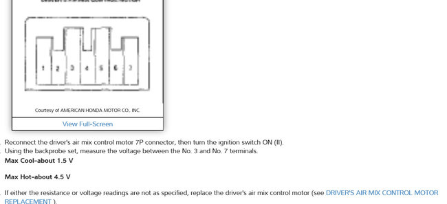

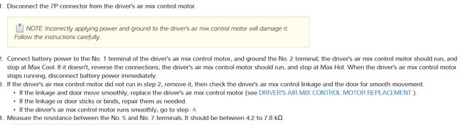

try redoing it again as no codes are showing. see pics for testing air control motor.
