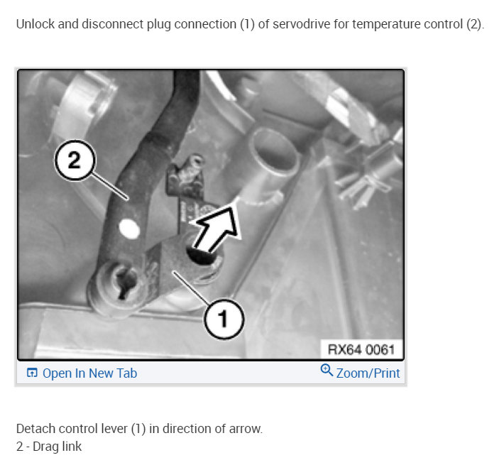

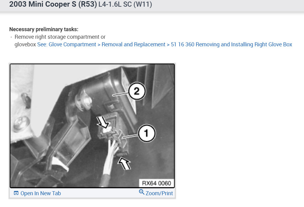

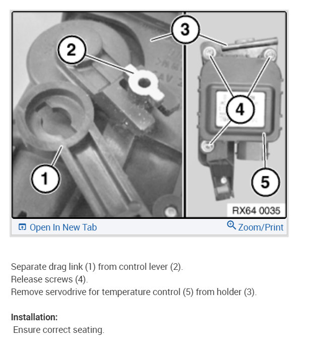

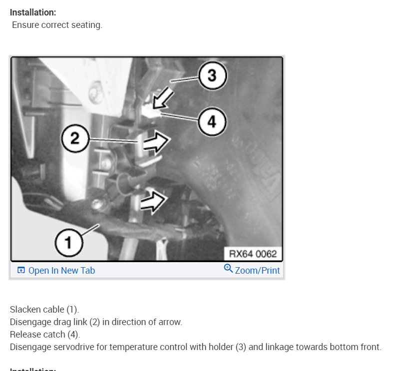

  • 55,399 POSTS
It sounds like the blend door actuators are closing? Can you remove them to check the operation?
Oct 30, 2019 at 9:49 AM
NASER NASER
  • 836 POSTS
I can try the passenger. can you give some instructions on removing it?
Oct 30, 2019 at 10:17 AM
  • 55,399 POSTS
Here are the instructions for removing the actuator. Check out the diagrams (below). Please let us know what happens.
