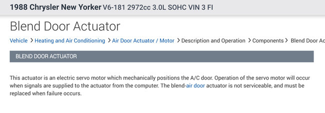

The heater is blowing no heat is kicking out. I did change the climate controller and the thermostat, both heater core hoses are running hot but still no heat.

Yes, I do hear the doors move when I go from AC to heat. the air blow strong just no heat is coming out. both of my heater core lines are hot. do you think it could be one of the small vacuum hoses that are located by the heater core hose?

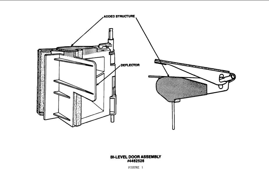

I found there was an update for the deflector door or the blend door on the heater box.
I attached the TSB for it and a picture.

Technical Service Bulletin Date 10/17/88 is being revised to include Figure 1. Figure 1 was inadvertently left out during the original printing and distribution of Technical Service Bulletin 24-02-88.

This repair procedure involves replacement of the bi-level air door and vacuum actuator which will reduce the temperature and the volume of the demister air anytime the system is in the A/C panel mode.
1. Consult the appropriate 1988 service manual for the proper procedure and then remove the A/C evaporator housing from the vehicle.
2. Using the procedure as outlined in Group 24 of the service manual, remove the bi-level air door and vacuum actuator from the evaporator housing.
3. Replace the existing bi-level air door with service replacement door, PN 4462526, as shown in Figure 1. Replace the vacuum actuator with service replacement actuator, PN 4462918.

I do not hear the door when I switch from air to heat.

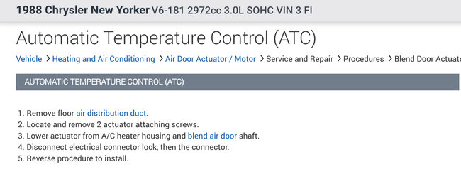

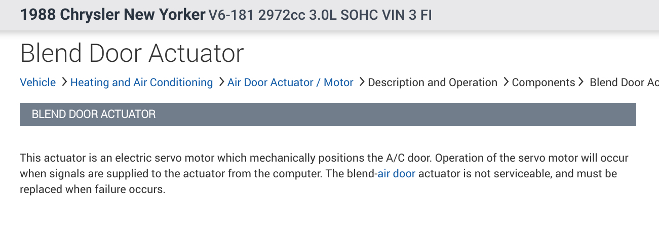

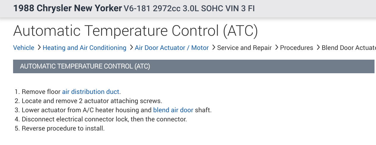

This could be a problem with your mode door actuator. Your vehicle's Heating Ventilation and Air Conditioning [HVAC] system uses little plastic motors called actuators to move the doors of the system to route heat and air into different ducts. In the diagrams down below I have included instructions on how to replace your vehicles blend door. Here is a generic guide explaining how to replace an actuator motor in the link below:
Please go through these guides and get back to us with how everything turns out.
