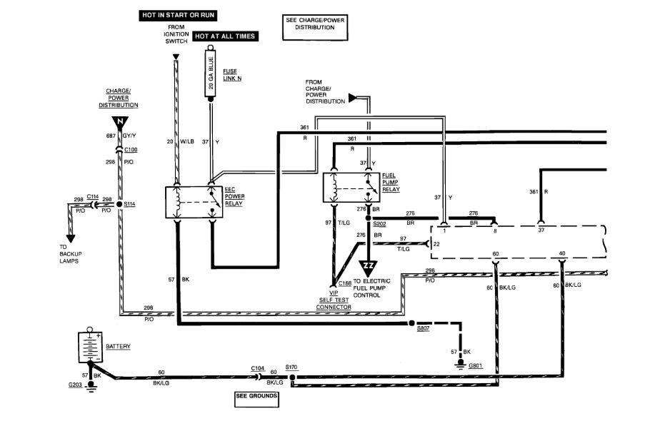

Truck has sat for a year or two.
Ran fine when parked.
Has dual fuel tanks.
Not getting pressure to the fuel rails.
I don’t think either tank fuel pump is turning on.
Replaced fuel filter on frame in front of the high pressure pump on frame rail under drivers side cab.
Replaced fuel pump relay.
When I turn the key to run position the relay clicks and the high pressure pump comes on for about three seconds and shuts off.
When I try to start it the high pressure pump comes on again until you stop trying to start it.
I’m lost from here, can anybody help?

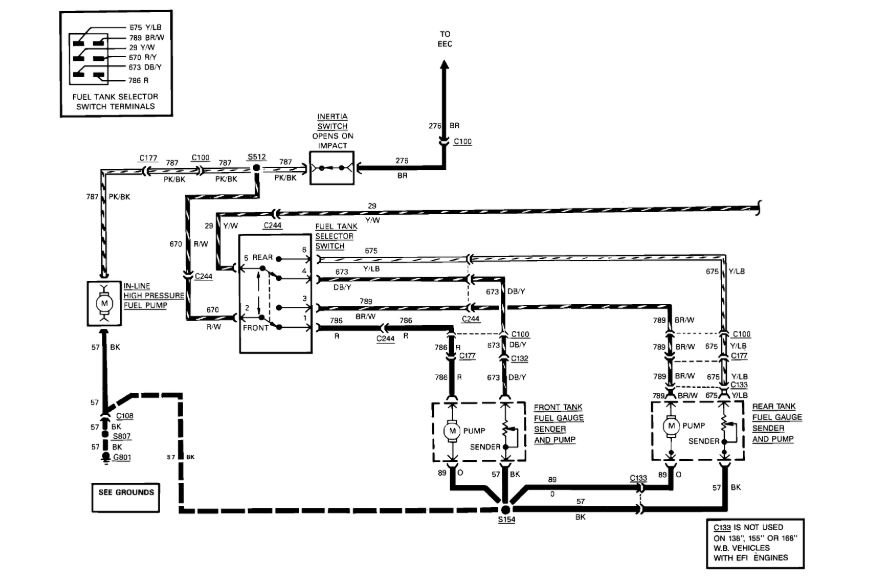

Do you hear the pump run with the key on?
Jun 23, 2019 at 10:04 AM
MRBIGDOG
I cannot hear either tank pump run with the key on no matter what position the fuel tank selector switch is in.
Jun 23, 2019 at 1:12 PM
Okay, I attached a couple of diagrams for you to view for the circuit for the pumps. You will need to test for power to the pumps to verify the wiring is good.
