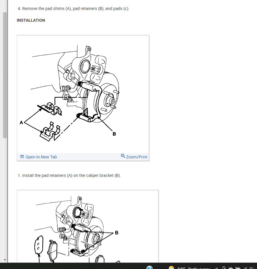

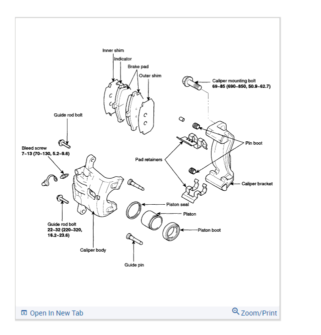

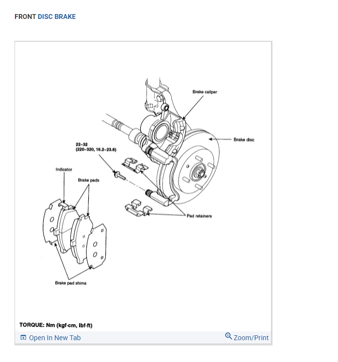

Hi, my front brakes are not working I think the pads are gone, I need to do brake service.
Jan 17, 2019 at 12:54 AM

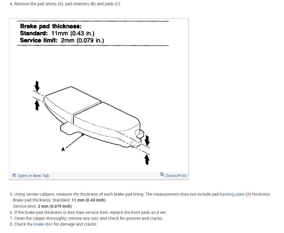

By the brakes not working, I suspect you mean they are not stopping well or grinding when you press the pedal. If that is the case then yes, you need to replace them.
Here are a couple guides that will help with this:
When replacing pads and rotors, it is a good idea to flush the system and get new fluid in the lines.
Here is a guide that will help with this:
https://www.2carpros.com/articles/how-to-bleed-or-flush-a-car-brake-system

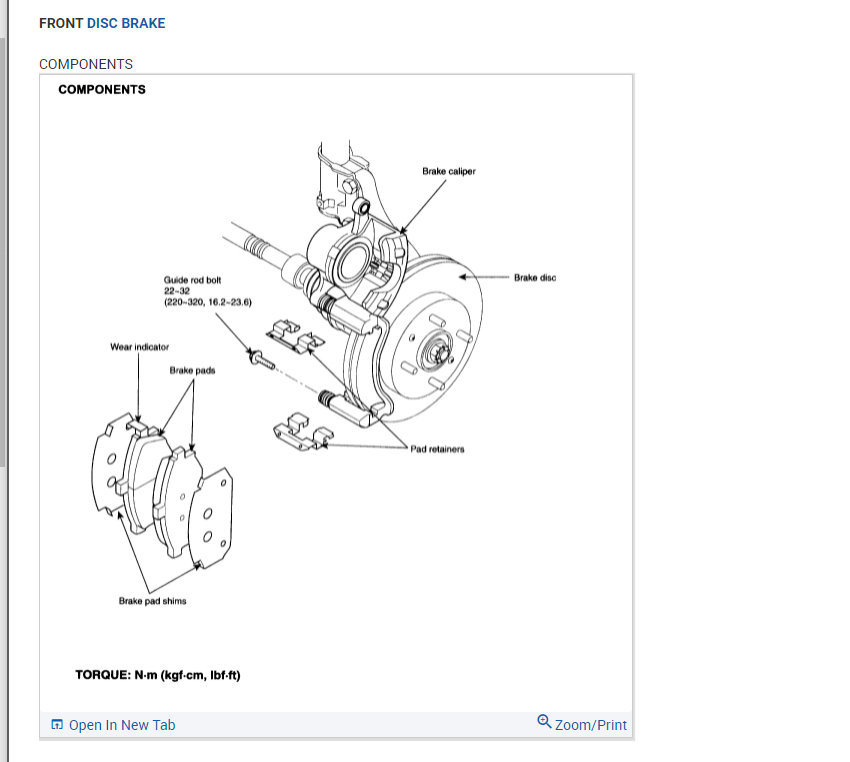

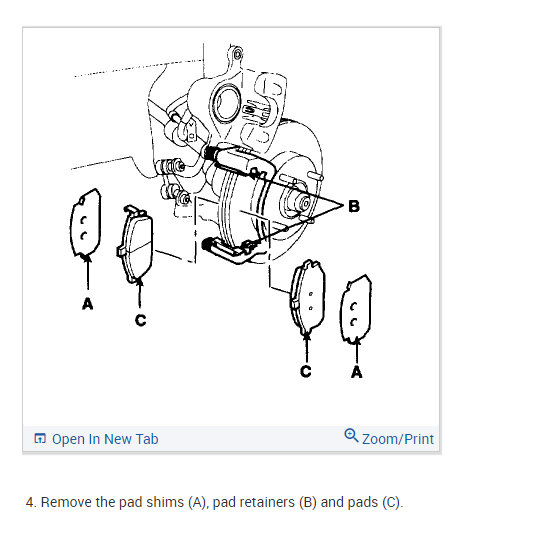

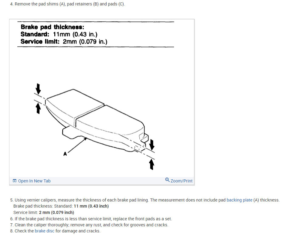

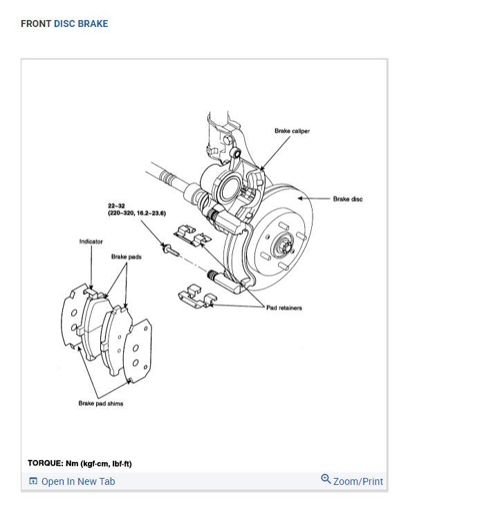

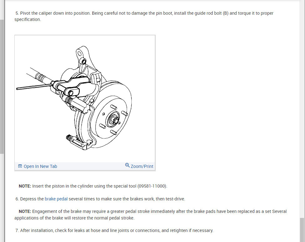

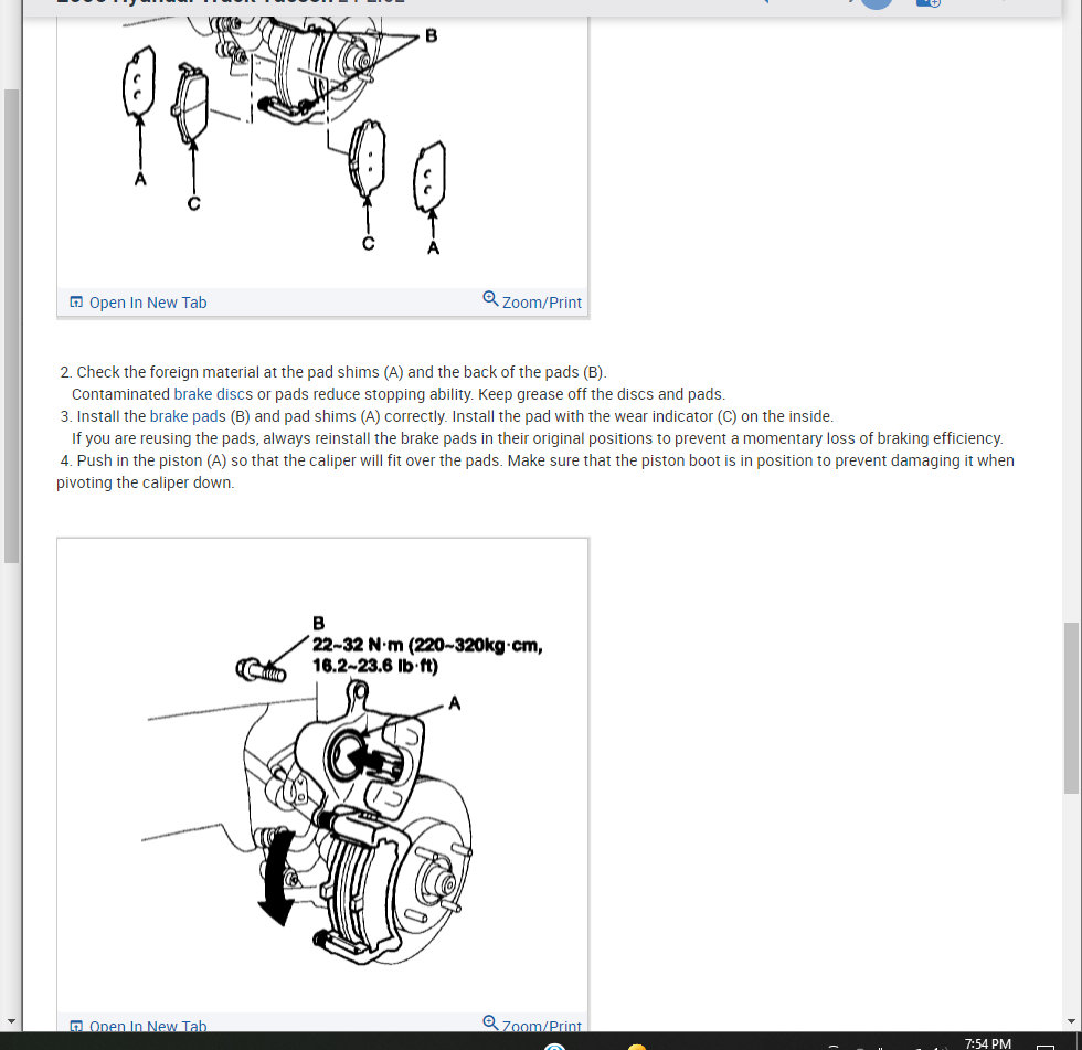

Below you will find the process from the manual that will provide the info needed to complete this.
Please let us know if you have other questions. Thanks

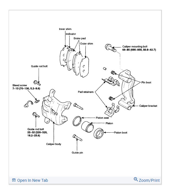

Hi, sorry for the late reply. No actually the pads are not gripping to the wheel when i am pressing the brakes.
Aug 17, 2021 at 7:51 PM

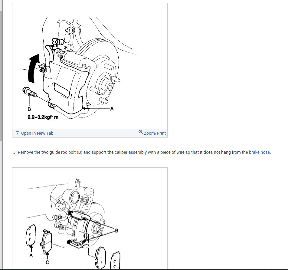

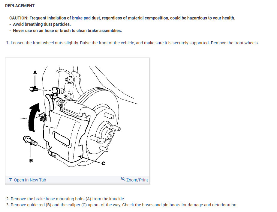

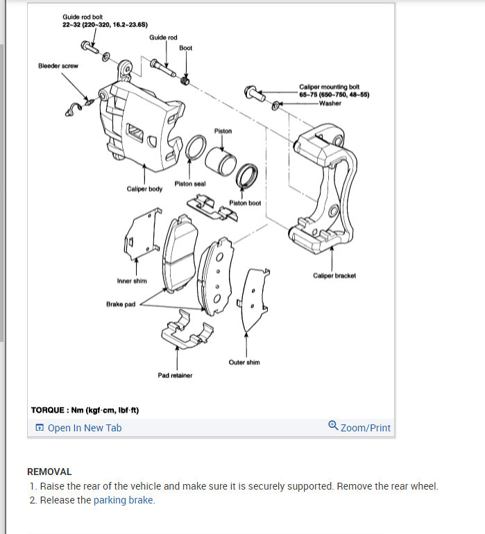

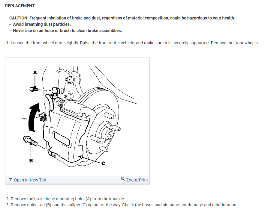

Good morning,
If the pads are not contacting the rotor then it is either the calipers or the master cylinder not sending fluid to the calipers for activation.
https://www.2carpros.com/articles/brake-caliper-replacement
I attached the procedure for you for the replacement.
Aug 17, 2021 at 8:24 PM
