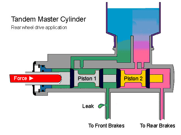

I have adapted the GM hydro-boost to the vehicle and cannot get the front brakes to work. New master cylinder, new brake lines, new calipers. I have eliminated the apportioning valve, tried both ports out of the master cylinder, rear brakes work with normal pedal if one port is blocked. If both front and rear are hooked to master, you can pump them up but when you let the pedal up for a bit then it goes back to the floor. But block one port and the rear brakes work with solid pedal. I have bled from top and pressured up from bottom, cannot think it is air. With engine running power assist works as does power steering. With just the front brakes hooked up with one port blocked, same situation, you can pump up to solid pedal, no leaks, but when you let up, pedal returns to the floor.

Hi and thanks for using 2CarPros.com. I ask that you bear with me since it is a modification which has been done and not the OEM set up.
I have to be honest, it sounds like the master cylinder is bad or you still have a tone of air in the system. The master cylinder is a two stage system. One of the reservoirs holds fluid for the front and the other for the rear. To me, it sounds like you have one piston working and the other bypassing. Hence, you can pump it up and the next time, it goes to the floor. I found a picture online which indicates the design and how it works. Take a look at it and let me know your thoughts.
