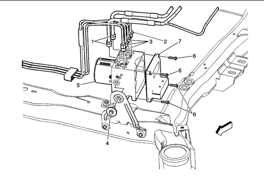

No fluid pressure from the modulator with the break line recovered for the left rear wheel. Replace all break parts from the modulator back. Three wheels have pressure but one does not. Foot goes to the floor and can't bleed that line.

The first thing I would do is to bleed the ABS module of all air as this may be the reason you have no pressure at the wheel.
https://www.2carpros.com/articles/how-to-bleed-or-flush-a-car-brake-system
https://www.2carpros.com/articles/brake-pedal-goes-to-the-floor
If you do this procedure and continue to have the issue, then the module itself is the issue and must be replaced.
https://www.2carpros.com/articles/how-to-replace-a-abs-controller

Important: Before performing the ABS Automated Bleed Procedure, first perform a pressure bleed of the base brake system. Refer to Hydraulic Brake System Bleeding (Manual) Hydraulic Brake System Bleeding (Pressure). The automated bleed procedure is recommended when one of the following conditions exist:
Base brake system bleeding does not achieve the desired pedal height or feel
Extreme loss of brake fluid has occurred
Air ingestion is suspected in the secondary circuits of the brake modulator assembly
The ABS Automated Bleed Procedure uses a scan tool to cycle the system solenoid valves and run the pump in order to purge any air from the secondary circuits. These circuits are normally closed off, and are only opened during system initialization at vehicle start up and during ABS operation. The automated bleed procedure opens these secondary circuits and allows any air trapped in these circuits to flow out toward the brake corners.
Performing the Automated Bleed Procedure

8. With the scan tool, establish communications with the ABS system. Select Special Functions. Select Automated Bleed from the Special Functions menu. The Automated Bleed function will take 5 to 20 seconds.
