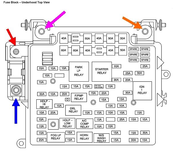

It looks like there's up to four nuts to check. All I have to go by is this drawing. I can't find any model listed with a 5.7L engine. This is for a 5.3L. They show two batteries. Am I seeing that right?

It is a 5.3L, my bad! I am thinking it was the small positive cable going to the fuse block. I disconnected it to be able to raise the fuse block and check the wires under it. Even though the connection was tight and looked free of corrosion, disconnecting it and reconnecting may have done it. So far so good. If it happens again, I'll go directly to that positive cable first. Is adding dielectric grease recommended to help prevent corrosion?

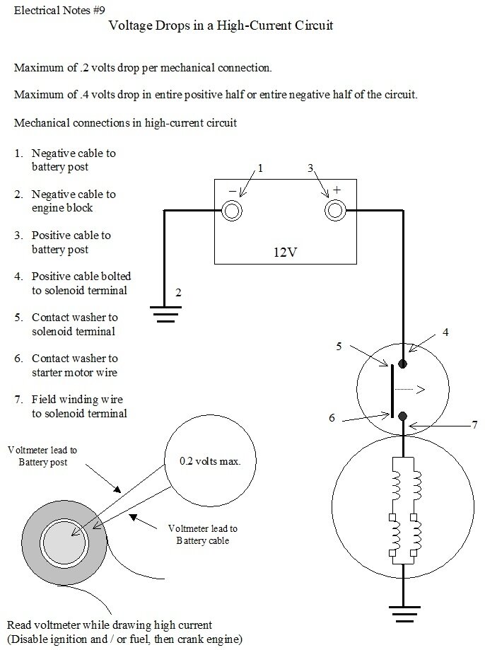

For this test to work, you have to turn on at least one high-current circuit, even when nothing is working. The purpose is we need to have current trying to flow, otherwise no voltage drop will ever show up. The most common high-current circuit is the headlights. If you don't have a computer-controlled heating system, you can use the heater fan instead. When the defect is occurring, whatever you have turned on will not be working. The goal now is to keep it that way. Don't wiggle and fiddle with anything in an attempt to get it to work.
The voltage drop test is done by measuring the voltage on the two parts of each mechanical connection. It doesn't matter where you start, but I like to start at the battery. Place one meter probe on the positive cable clamp, and the other probe on the positive battery post. (The two probes will be about 1/4" apart). Those are the same place in the circuit, so the voltage should be the same at both points. The voltmeter should show 0.00 volts. If that mechanical connection is less than perfect, you'll find some voltage drop there, but again, only when current is trying to flow through it.
Now do that same test at the negative post and cable clamp. If they both show very close to 0.00 volts, move on to the better suspects. That's those wires bolted to the fuse box. This gets a little trickier. One meter probe must go on the terminal on the end of that wire, not on the nut. The other probe must go to the stud that nut is on. If you find anything substantial, that is the connection that must be cleaned. You're supposed to find 0.00 volts there. Do the same test for any other fat wires bolted to that fuse box. To be fair, you can expect to see a little voltage drop, say in the order of a few hundredths of a volt. Normally when a connection is bad enough to cause something to be dead, you're going to find well over four volts, and maybe even the whole 12 volts.
The last mechanical connection is where the smaller negative battery cable is bolted to the body sheet metal. I had this one break due to rust on the coldest winter day in Wisconsin a few years ago.
This is the same test we do in starter circuits, although those bad connections are usually easier to find. An older Ford or GM starter wants to draw up to 300 amps until it gets up to speed. Once spinning, that drops down to around 200 amps. With current that high, it takes far less resistance than we can measure to stop the circuit from working. A misguided continuity test will falsely show everything is okay. While we can't measure resistance that small, we can measure the RESULTS of that resistance. That is this voltage drop test. The industry standard is we're allowed up to a maximum of 0.2 volts per mechanical connection, and no more than 0.4 volts for the entire half of that circuit. The other half is the negative battery cable where it bolts to the engine. You have one mechanical connection between the battery post and the negative cable clamp, and a second one between the other end of that cable and the engine.

The drawing below is of a "Notes Page" I handed out in class. This is for starter circuits, but the idea is the same with fuse boxes.
