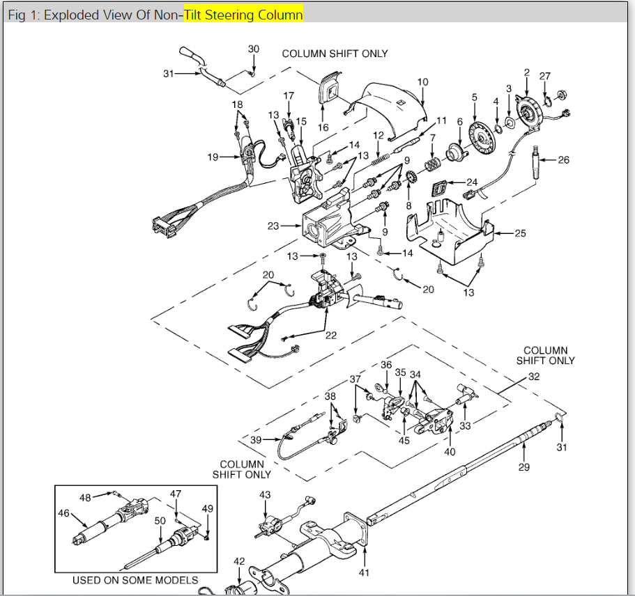

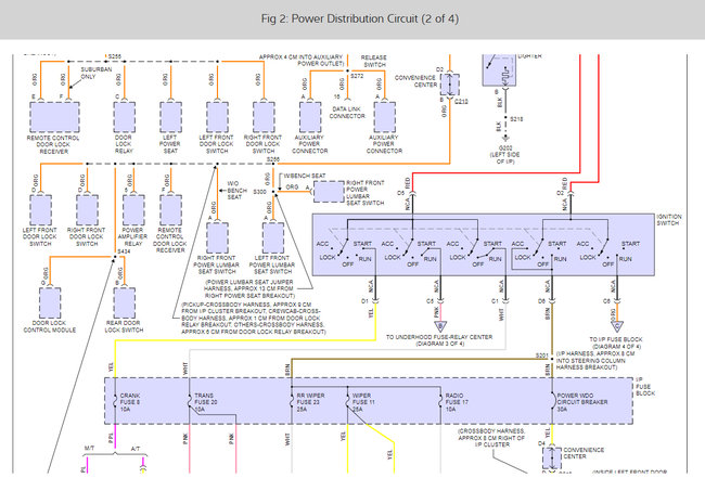

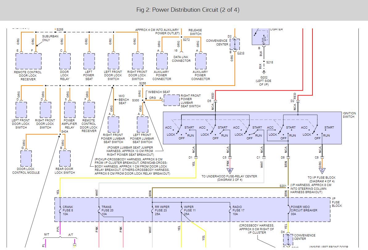

I came home one day turned off my truck went inside to do something came back out tried to start it and I have no power to the starter the fuel pump or my gauges. The radio has power the courtesy lights have power. I have checked all grounds and positive cables. I have checked all fuses and relays. What am I missing?
Aug 12, 2018 at 6:50 AM
  • 55,402 POSTS

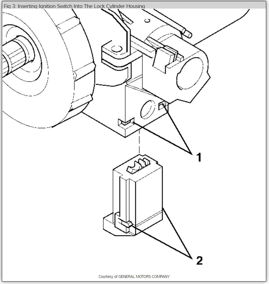

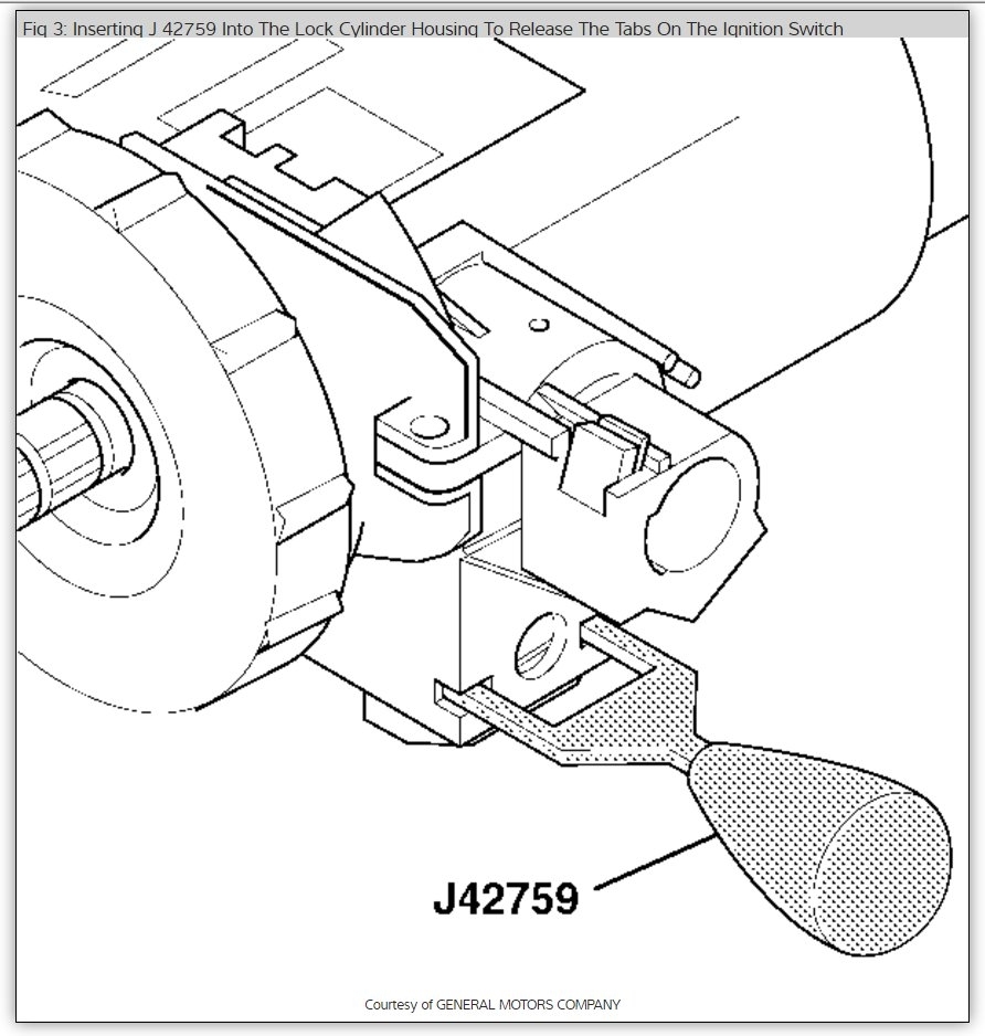

It sounds like the ignition switch is not working right. To confirm the issue here is a guide to help you check for power and the wiring diagrams to help you see which wires to test:
Check out the diagrams (below). Please let us know what you find.
