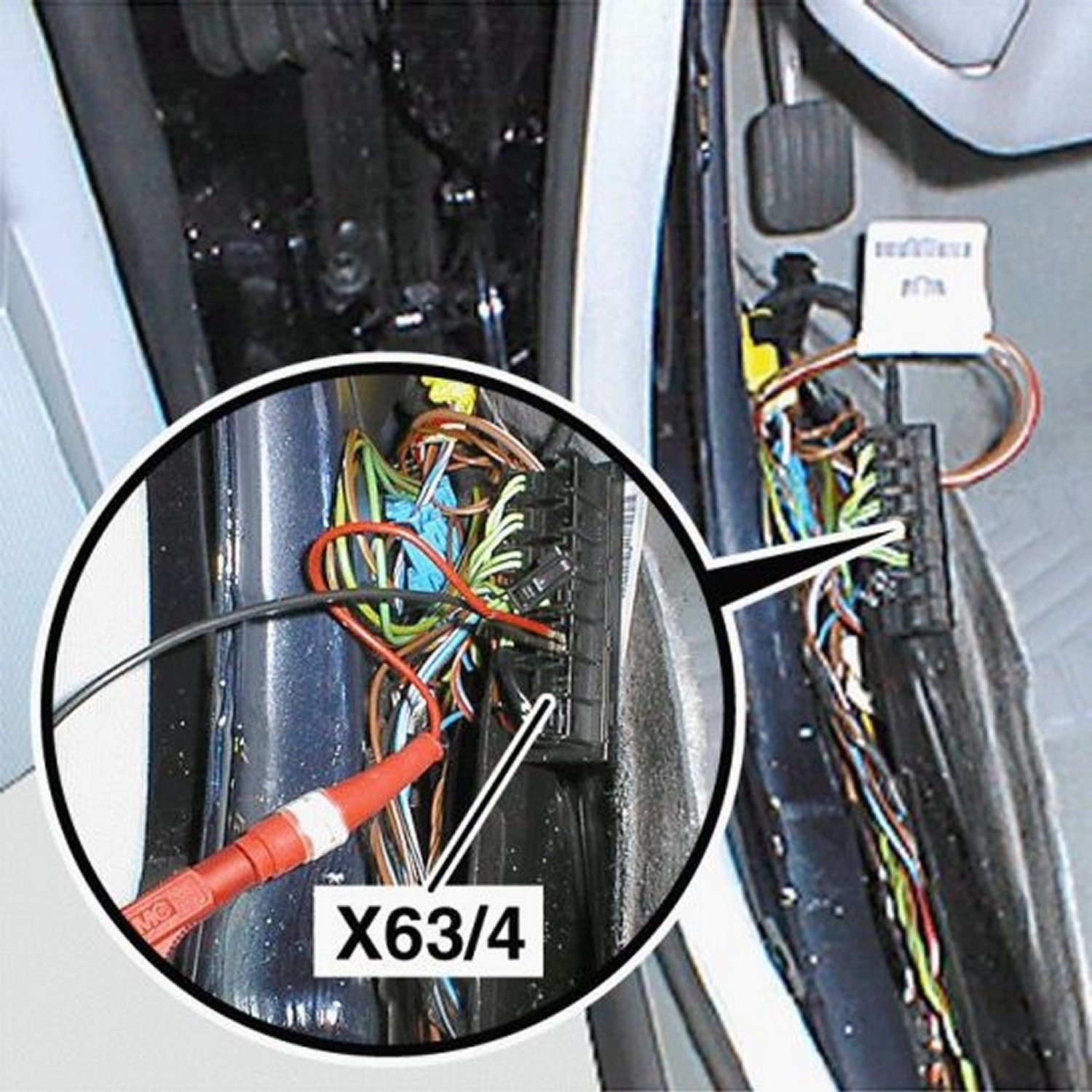

No crank, no start, transmission gear selector stuck in p and multiple codes
2003 MERCEDES BENZ C230
185,789 MILES • 4 CYL • 2WD • AUTOMATIC
KINGSLEY2019
  • 22 POSTS
The car doesn't crank neither start nor the gear selector come out of p.
Retrieved codes: p0620,p0128,p0562,p0410,p0171,p0600 and p0500.

You have your hands full with this one. I reviewed the codes and the one that stands out is the P0500. That is indicating a breakdown in the CAN bus system. I would suggest checking total resistance in the under hood can system. I have a feeling there is an open circuit.
____________________
Here are the directions for testing. The attached pic correlates with the directions.
___________________
2003 Mercedes Benz C 230 (203.040) L4-1.8L SC (271.948)
Test 4A1: Perform Measurement at Component X63/4 (CAN Databus Adapter Connector, 2-Pin)
Vehicle ALL Diagnostic Trouble Codes ( DTC ) Testing and Inspection P Code Charts P0500 [1] CAN Message From Control Module Traction Systems, Vehicle Speed Signal Implausible Test 4: Resistance Test of Engine Compartment CAN Test 4A: Test Total Resistance of Engine Compartment CAN Test 4A1: Perform Measurement at Component X63/4 (CAN Databus Adapter Connector, 2-Pin)
TEST 4A1: PERFORM MEASUREMENT AT COMPONENT X63/4 (CAN DATABUS ADAPTER CONNECTOR, 2-PIN)
Perform measurement at component X63/4 (CAN databus adapter connector, 2-pin)
Test total resistance of engine compartment CAN
Figure legend
Pic 1
- X63/4 (CAN databus adapter connector, 2-pin)
Test sequence
- Switch off ignition
- Measurement with multimeter
- (X63/4) 2.22.1 (X63/4)
- Adapter cable no. W220 589 00 99 36 may be used.
Specified value
- [55...65] ohms
Question: Is the measured value within the specified value range?
- The measured value is not o.k.
Possible cause and remedy
- Cable from component N3/10 (ME-SFI control module) to component X63/4 (CAN databus adapter connector, 2-pin)
- Test terminating resistor of component X63/4 (CAN databus adapter connector, 2-pin).
- Test terminating resistor of CAN element in control module N3/10 (ME-SFI control module).
**End of test**
- The measured value is o.k.
**End of test**

After days of tracing the problem, I shook the wires running under the trim (left hand side) at the CAN adapter connector, then the gear selector could move out of p and the car started.
Thank you so much.
Nov 1, 2020 at 1:37 PM
  • 110,240 POSTS
Glad to hear it's running. Was the connector loose or corroded? Regardless, glad it's running.
Nov 2, 2020 at 9:59 AM
KINGSLEY2019
  • 22 POSTS
It was corroded.
Thank you one more time.
