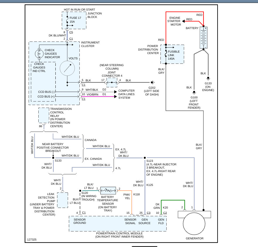

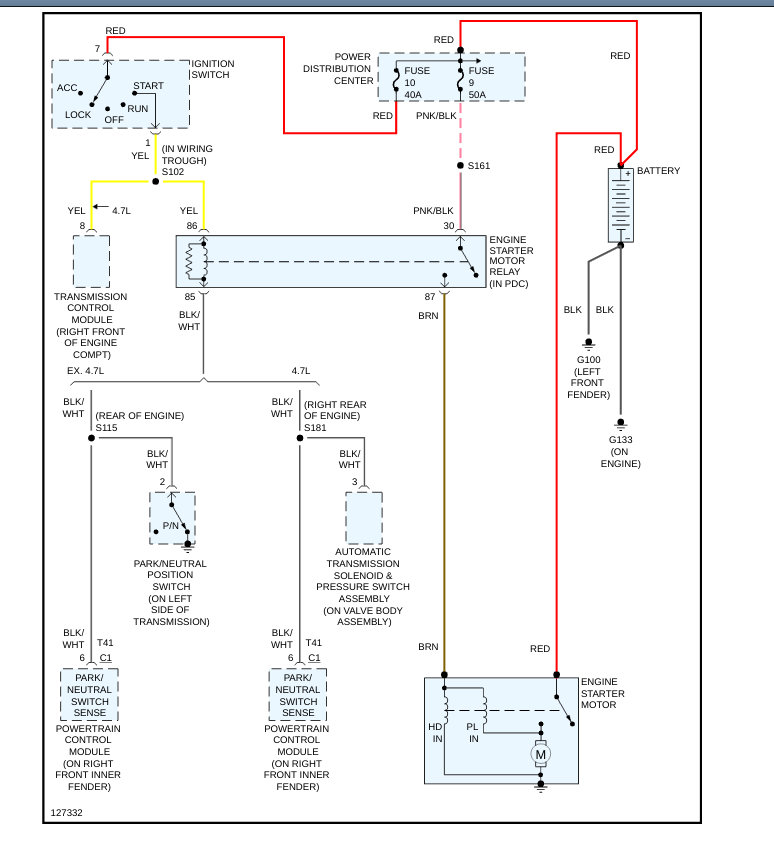

Was running fine. Next day I went to start and no crank and no start. New battery so that's not the problem. Hooked it up to code reader and nothing showed. Any idea what is going on?
Monday, January 27th, 2020 AT 12:51 PM
SCGRANTURISMO
  • 4,897 POSTS
What exactly does your vehicle do when you turn the ignition key? Does it do nothing, does it click, does it sound like a machine gun going off? Please get back to us with your answer, and then we can go from there. In the diagrams down below I have included a wiring diagram of your vehicle's charging and starting system for your reference.
