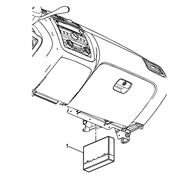

Okay, has the body control module connection been checked? I attached a pic below to help you locate it. Since the gauges are going crazy, check that if it hasn't.

The connections seemed fine from what I could tell nothing seemed wrong with it.

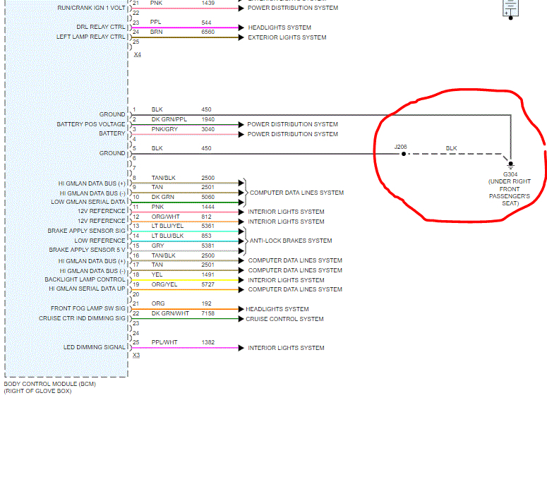

There is a body ground located under the passenger side seat. Can you check there to see if there is a corrosion issue or if it is loose or damaged?

I can’t see a ground wire under the passenger seat.
Mar 5, 2021 at 11:45 PM
  • 110,240 POSTS
Interesting... That is where the schematic is showing it. Have you checked around the seat? Normally, it wouldn't be placed where it would be hit by peoples' feet, but anything is possible.
Also, make sure there is no evidence of the black wires indicates and nothing appears broken. Please realize it won't be on the seat itself. You may have to lift carpeting to locate it.

I found the ground under seat. I’m going to check it and I’ll let you know. thanks for your help.

I just want to say thank you so much I have spent over $1,500.00 trying to figure this car out. I’ve been to several shops and not one apparently checked my grounds the one on top of my motor was a little nasty looking. I’ve had it off before but apparently I didn’t clean it off but this time I did and my car has not messed up one time. I am ecstatic. thank you again for your advice on checking and knowing where my grounds were at.
