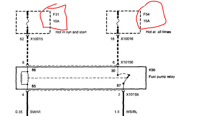

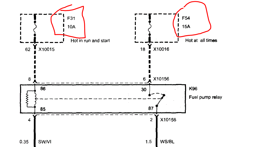

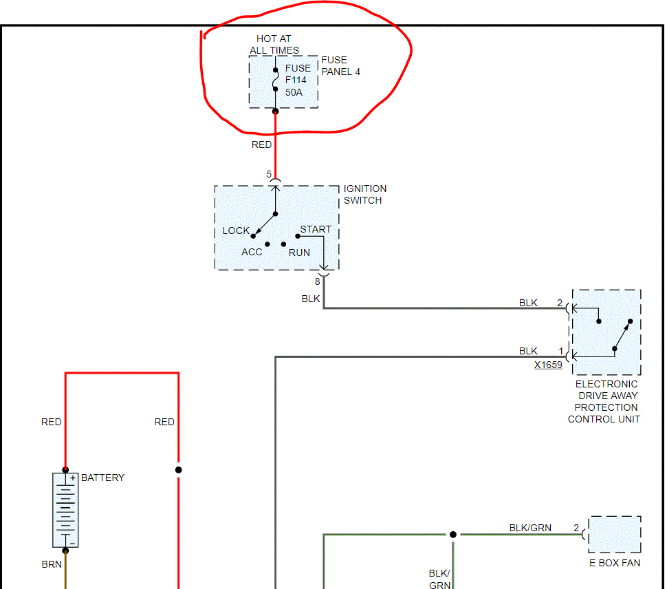

I attached two pictures below. First, make sure the fuse I circled is good. The two pics are with wiring schematic for the starter. I had to break it in two so you could read it. I did overlap it so you could follow it.
Picture 3 is the schematic showing the fuel pump relay. Check for power to it and check the relay itself. Here is a link that explains how it is done:

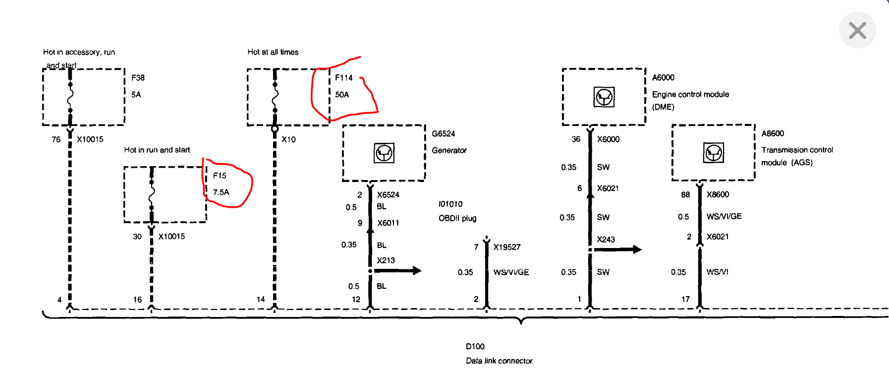

Picture 4 is for the data link connector. There are two pins and two fuses you need to check for me. See the picture. I circled them.
Picture 5 shows the two fuses that power the fuel pump relay. Check them as well and let me know what is found.

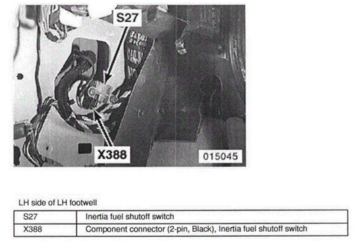

Last, there is an inertial fuel cut switch in the left kick panel. Check it as well. See picture 6.

Thanks, first the fuse number f114 is good, i think at least i found the right fuse, i found in in the rear of the car direct connected to the battery, and it as fine, the f15 was also good, and if it was blown should i be able to see how far the car has gone? As i see it also give's power to the brain of the car, or is that stored in the cluster?
Also the fuses for the pump f31 and f17 was okay, i don't know if the f17 is very important or not, but i saw they shared the same component, i checked most fuses with continuity test using a multi-meter.
On the last picture you sent, do you believe that shut off switch would make the obd and the starter not work? Sorry for "dumb" questions, i am terrible with schematics, also where have you found these schematics? Anywhere to download?

No, I don't feel they would prevent the starter from working. Please feel free to ask any question. There is no such thing as a dumb question.
