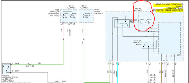

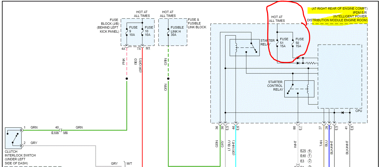

First, will the vehicle start in neutral? If not, I need you to check the two fuses in pic 1. They are in the under hood fuse/relay box. In addition to just checking the fuses, make sure there is power to them.

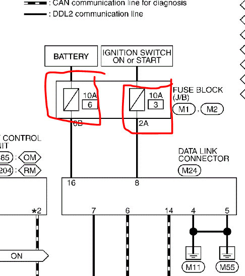

If you look at pic 3, it shows the fuses that power the DLC. Check the two fuses there as well.

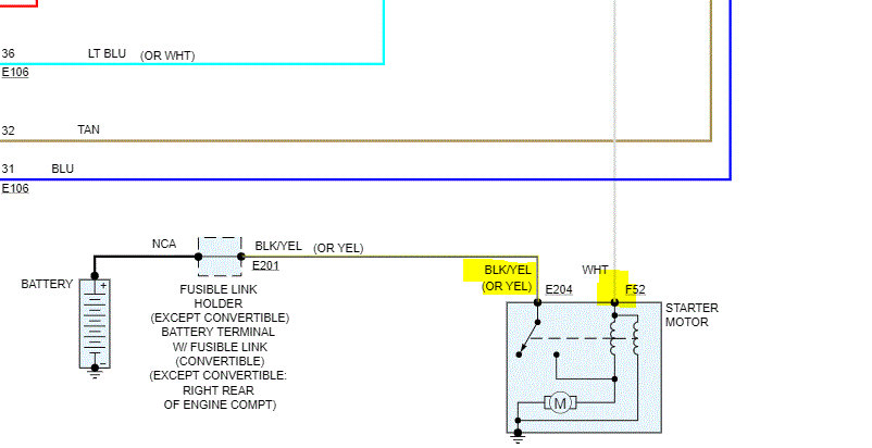

Next, check for power to the black/yellow (larger wire) at the starter. It should have 12v all the time. If there is no power, suspect the fusible link has failed. If there is power, then you need to check for power to the white wire when the key is in the start position.
