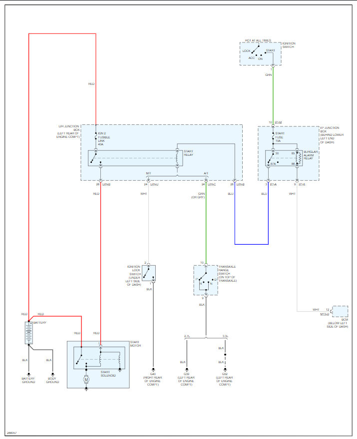

Swapped engines. It started. Turned it off and went to eat now it won't even crank to try to start.

Next we need to check voltage at the starter trigger wire and power feed wire. You should have 12 volts when cranking the engine on the trigger wire so if you don't, and don't have codes and the theft light is not on then we need to find out if there is a relay or fuse issue.

Below is the wiring diagram. Please run through all this material and let us know what you find. Clearly if there are codes or the theft light is on, just let us know that and we can go from there. If not, test the starter as described. Thanks
