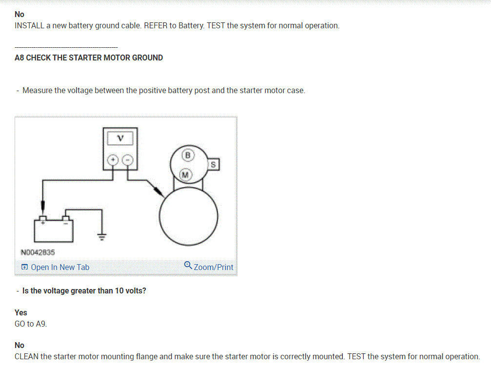

Does the starter engage when you turn the key or does nothing happen? The only thing in the passenger compartment is the smart junction box (fuse box). It's under the left side of the dash. Is there any possibility that it got wet? Also, what was disconnected under the seats?

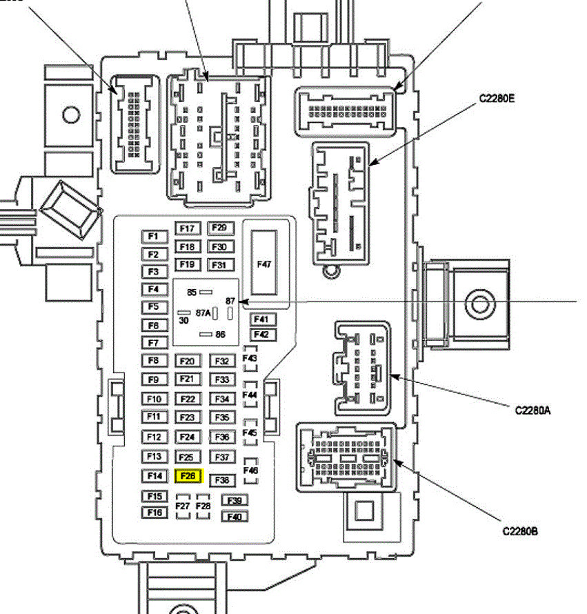

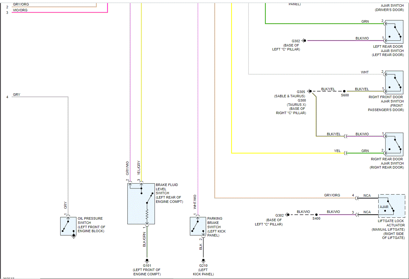

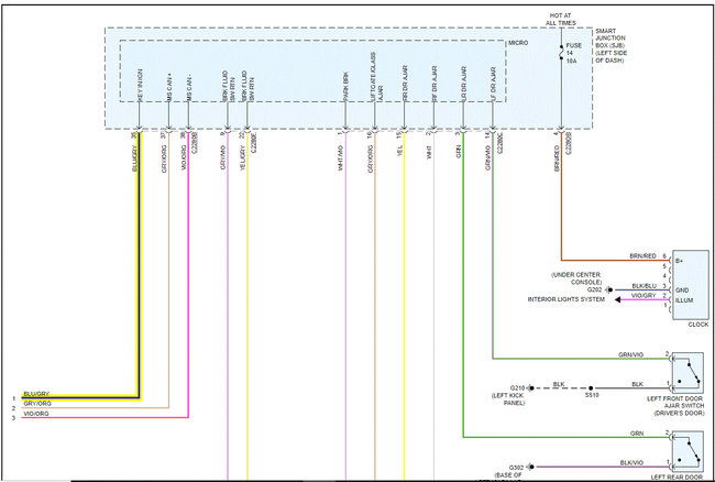

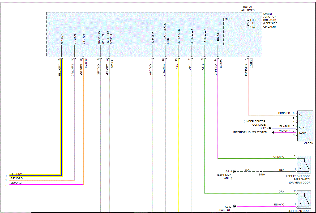

If you look at the first two pics below, it shows the entire schematic for the instrument panel. In the first pic, I highlighted a fuse. I need you to check it. In addition to checking the fuse, make sure there is power to and from it. Here is a link that you may find helpful:

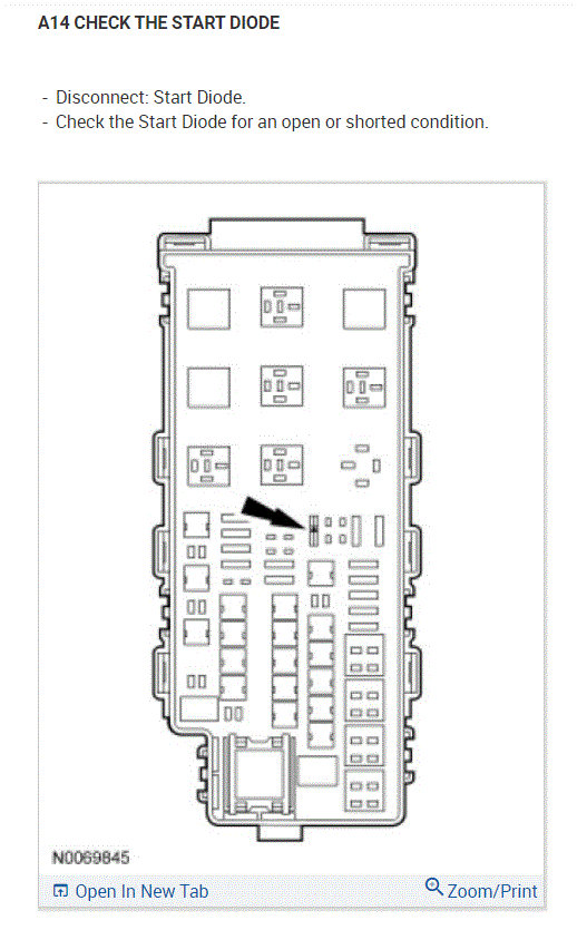

Also, pic 3 shows the fuse location in the SJB.
If the fuse is good, I next need you to load test the battery. There is a chance in someway it was drained with things disconnected. It's just a thought at this point. Here is a link that shows how to load test the battery.

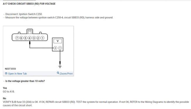

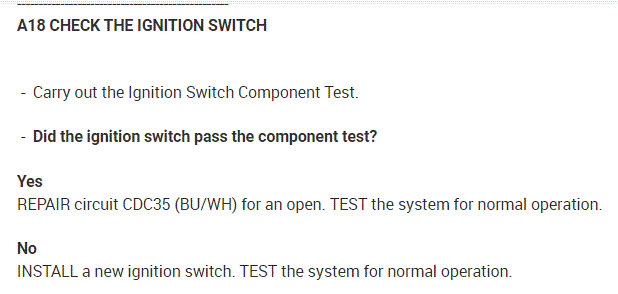

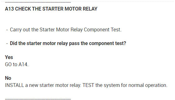

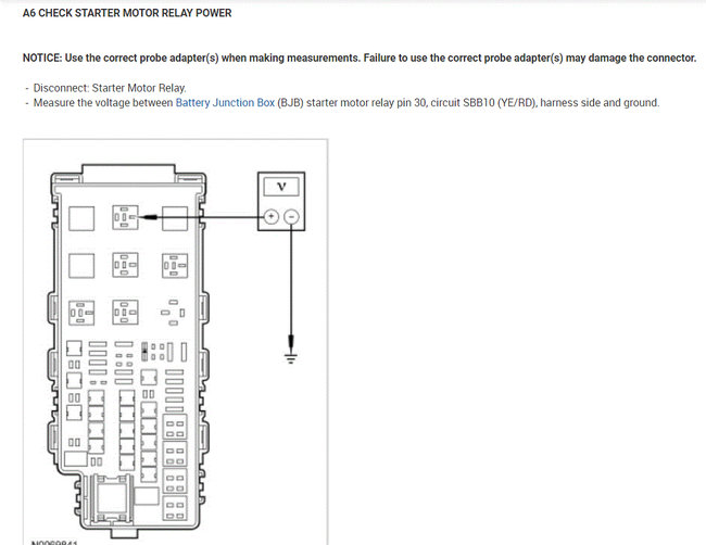

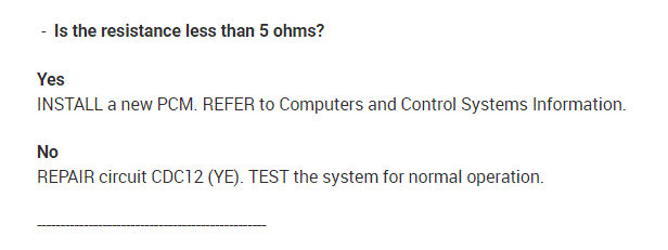

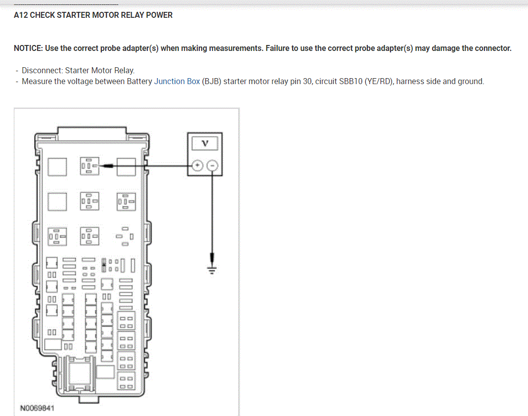

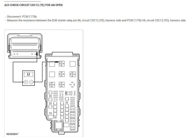

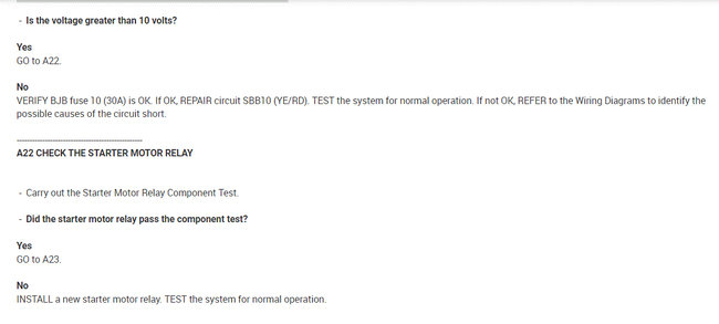

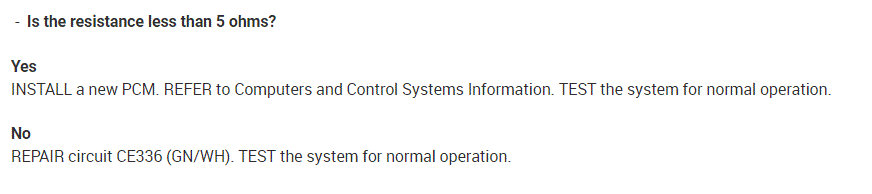

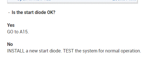

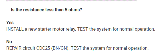

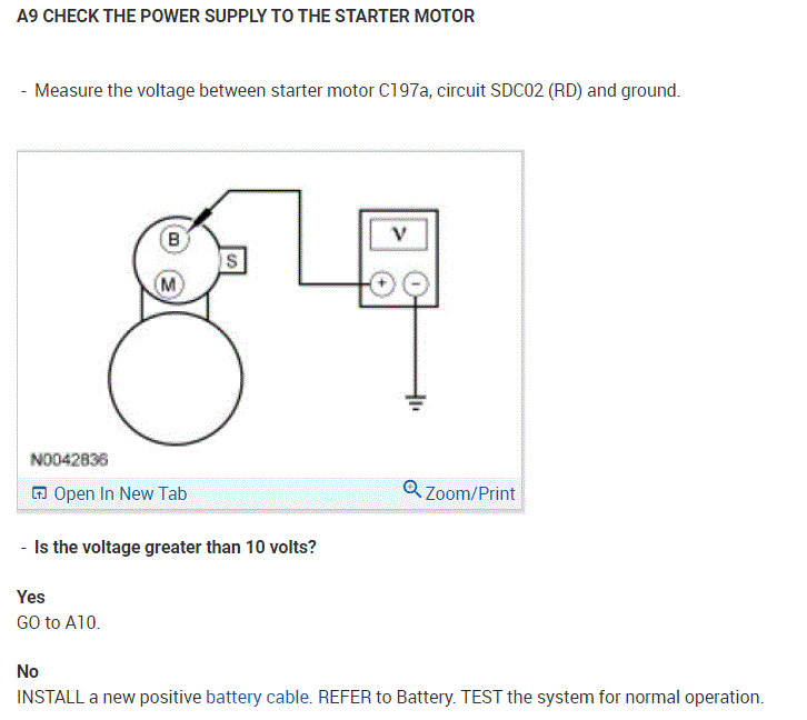

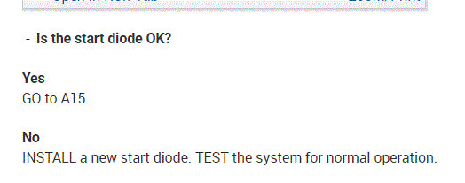

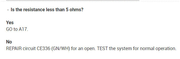

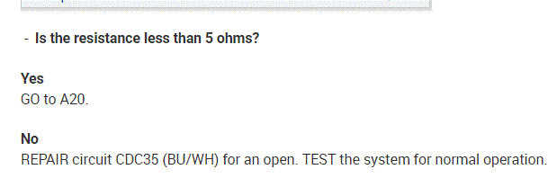

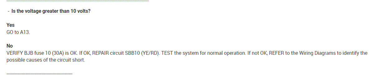

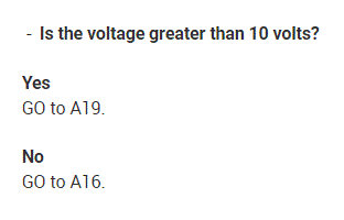

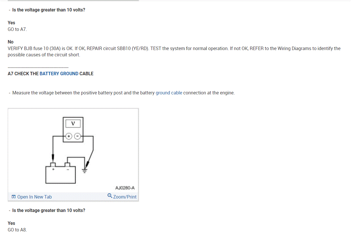

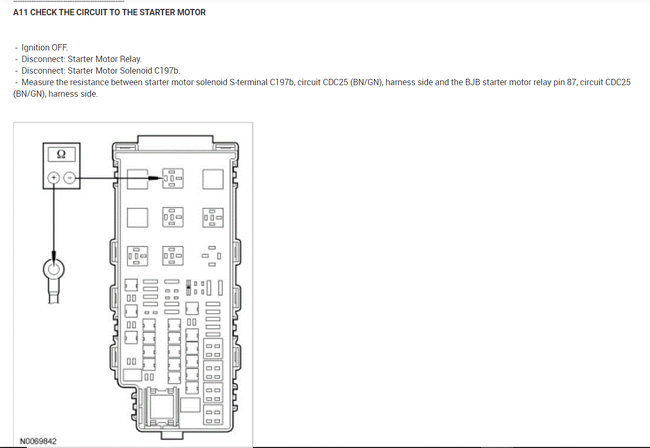

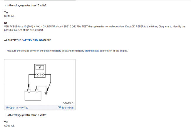

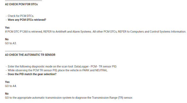

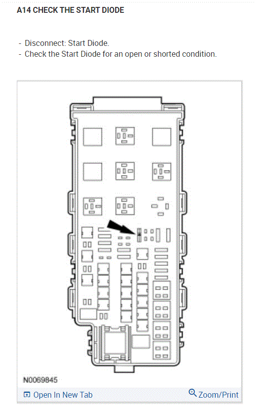

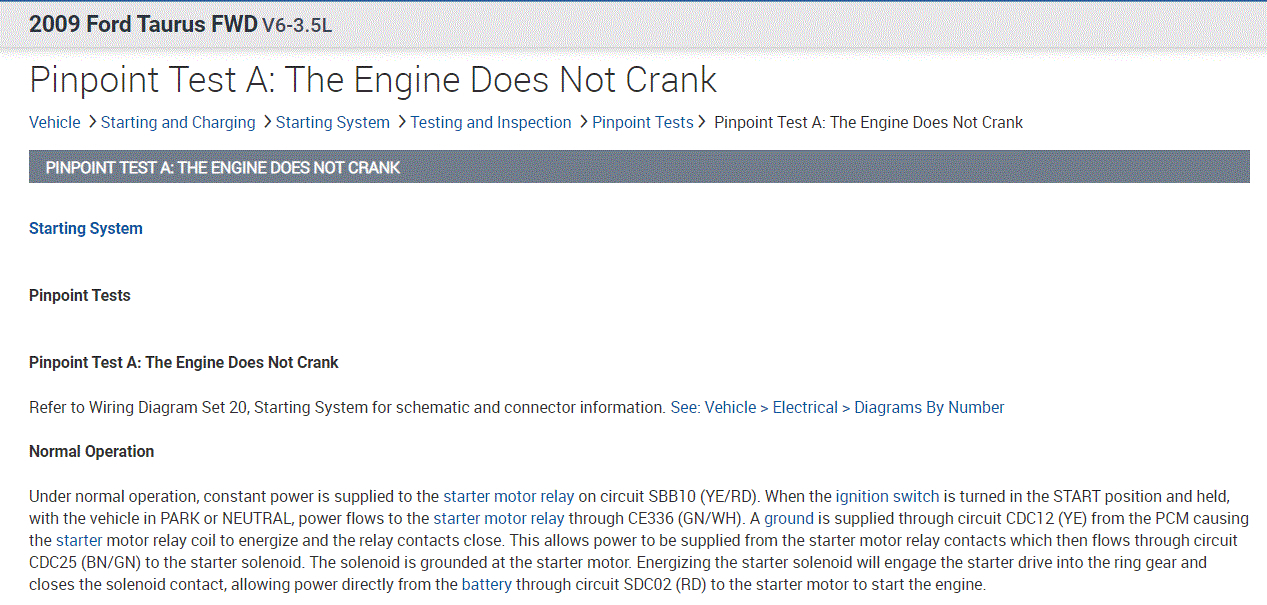

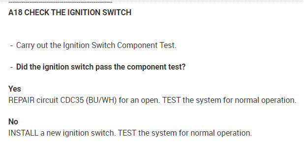

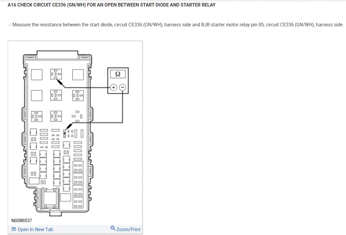

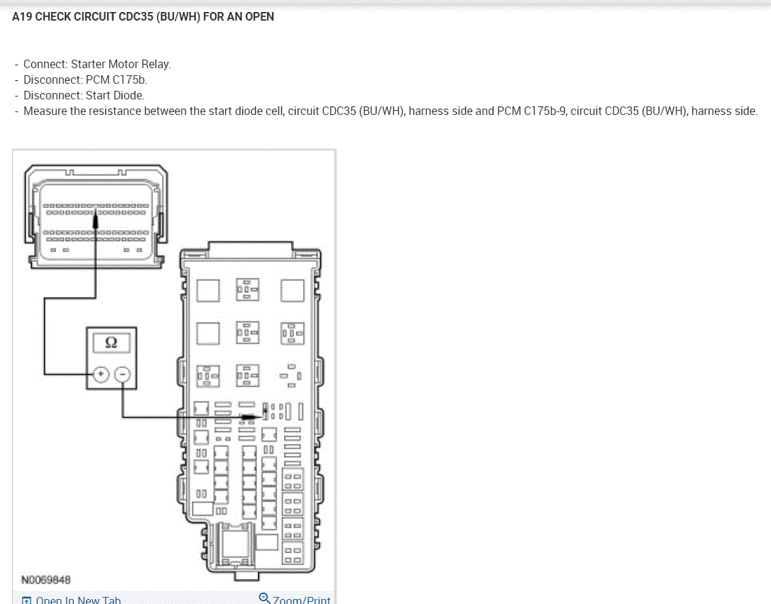

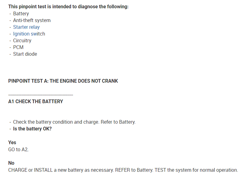

Honestly, this is a tough one simply because you did nothing to cause the problem.

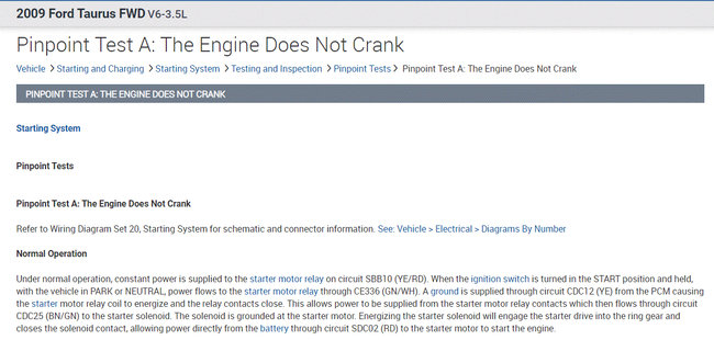

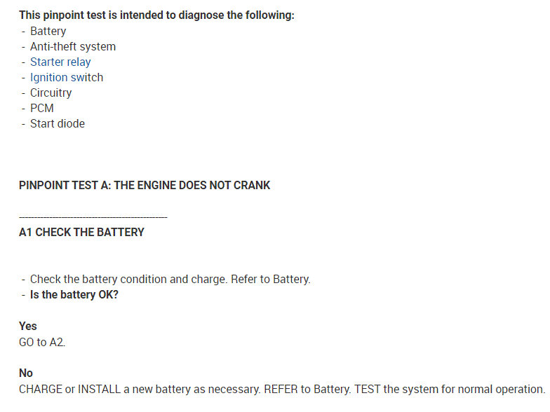

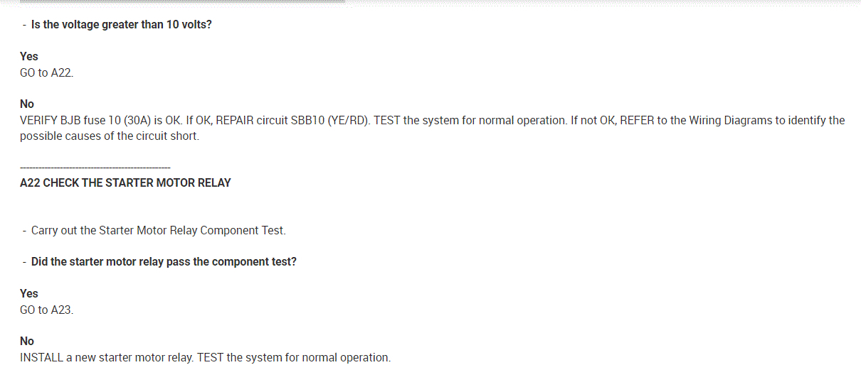

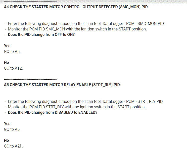

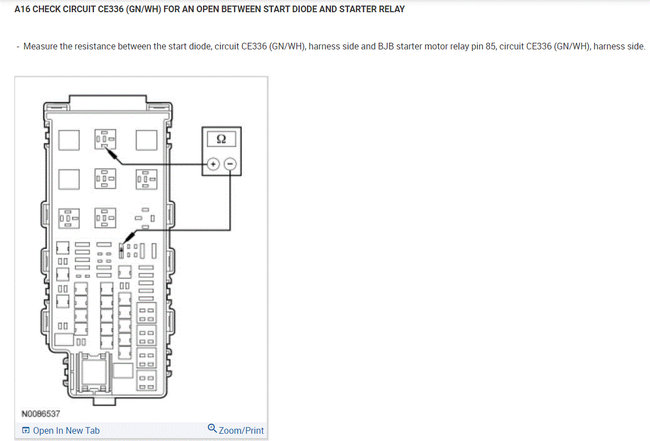

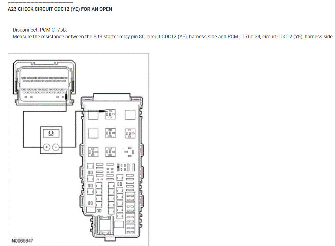

If I had your vehicle in my shop, I would start at the beginning of the diagnostics for a no-crank condition. They are extensive, but hopefully, you find the problem before getting to the end.
Take a look through them and let me know if you are comfortable performing the directions. Do one thing at a time to confirm there is no problem.
To help, here is a link that focuses on a no-crank condition:

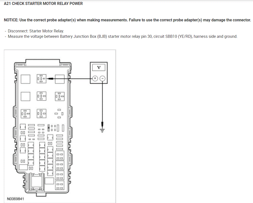

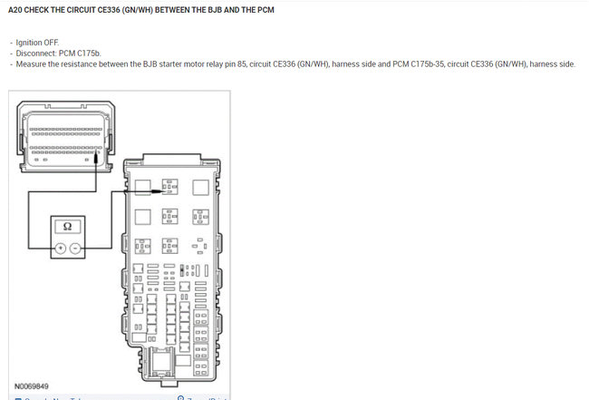

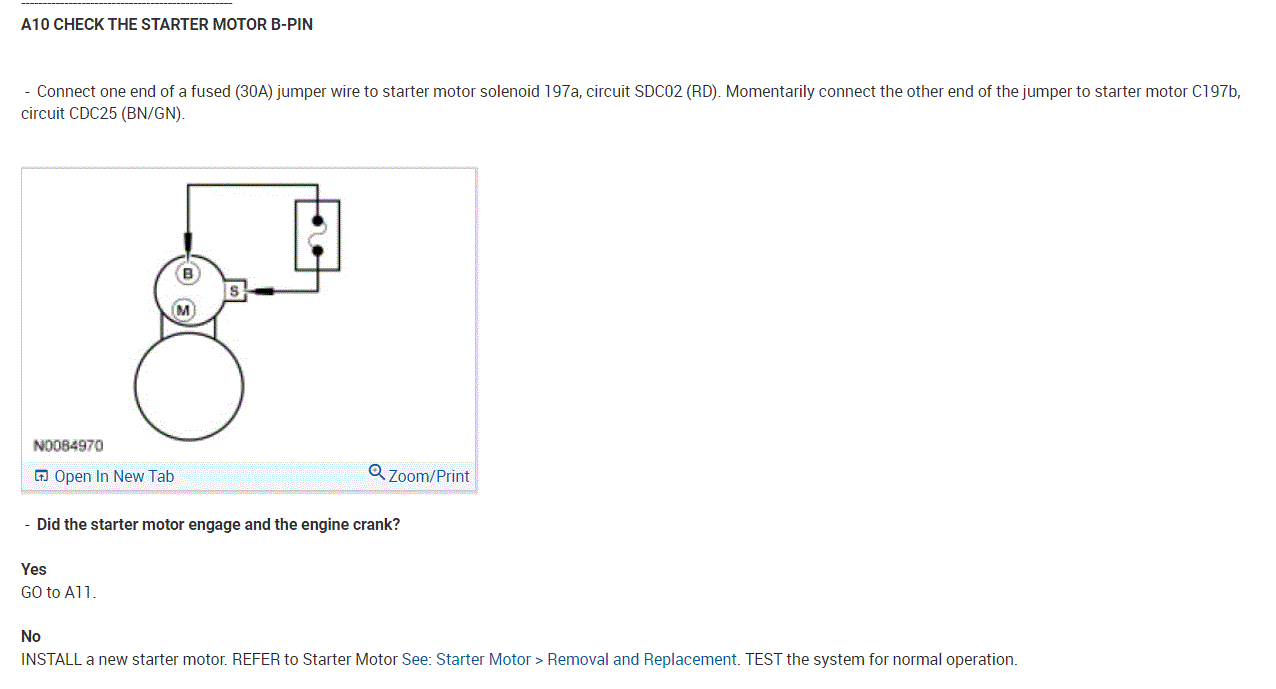

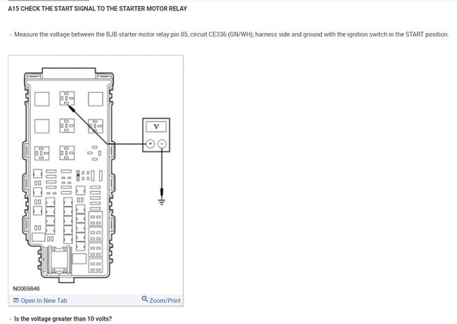

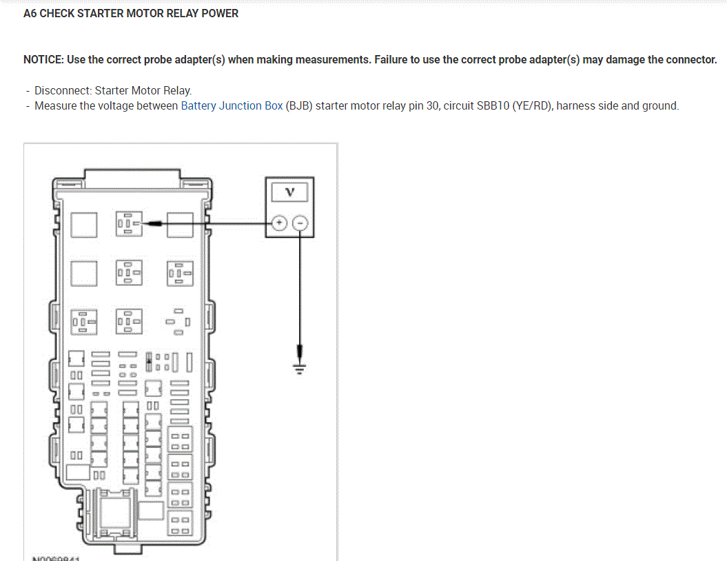

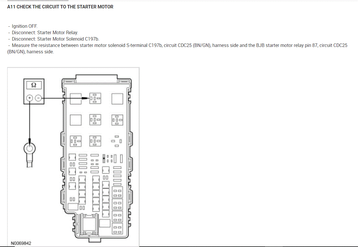

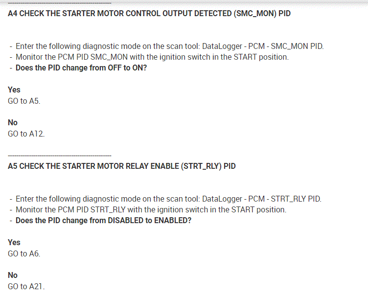

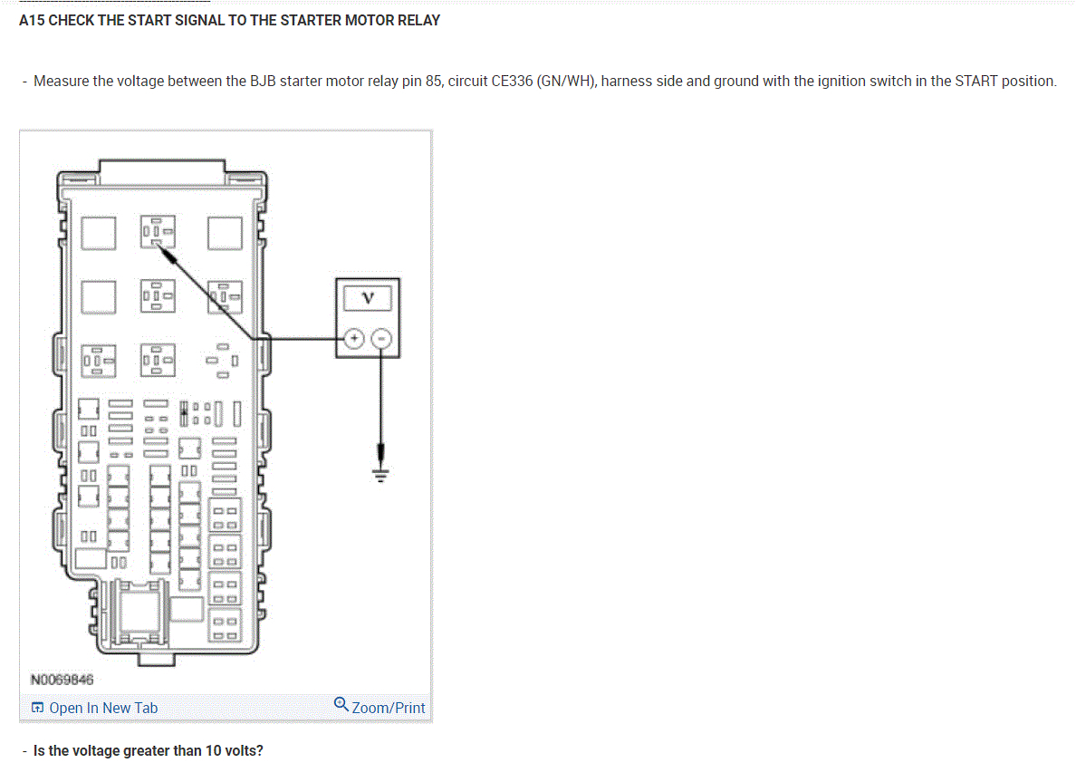

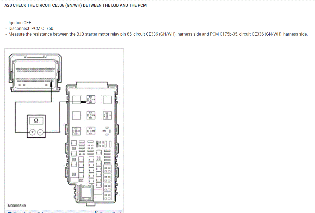

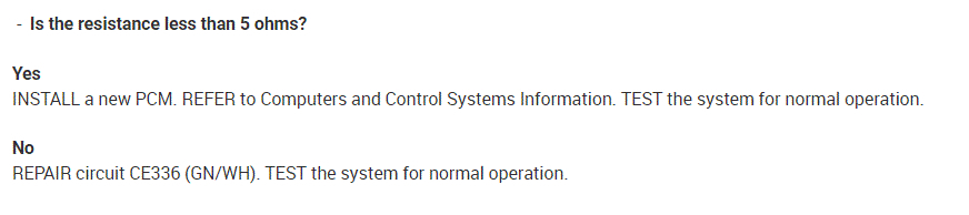

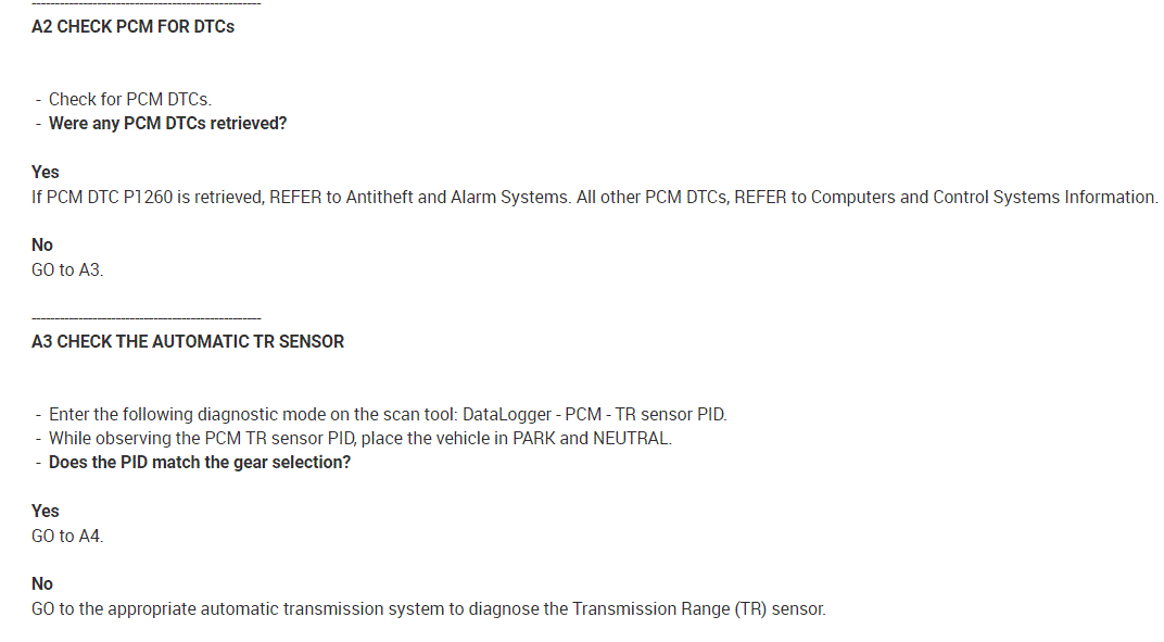

If you look at the attachments below, I included the diagnostics specific to your vehicle. It is extensive. However, a few of the things you have already done.
Let me know if this helps.
