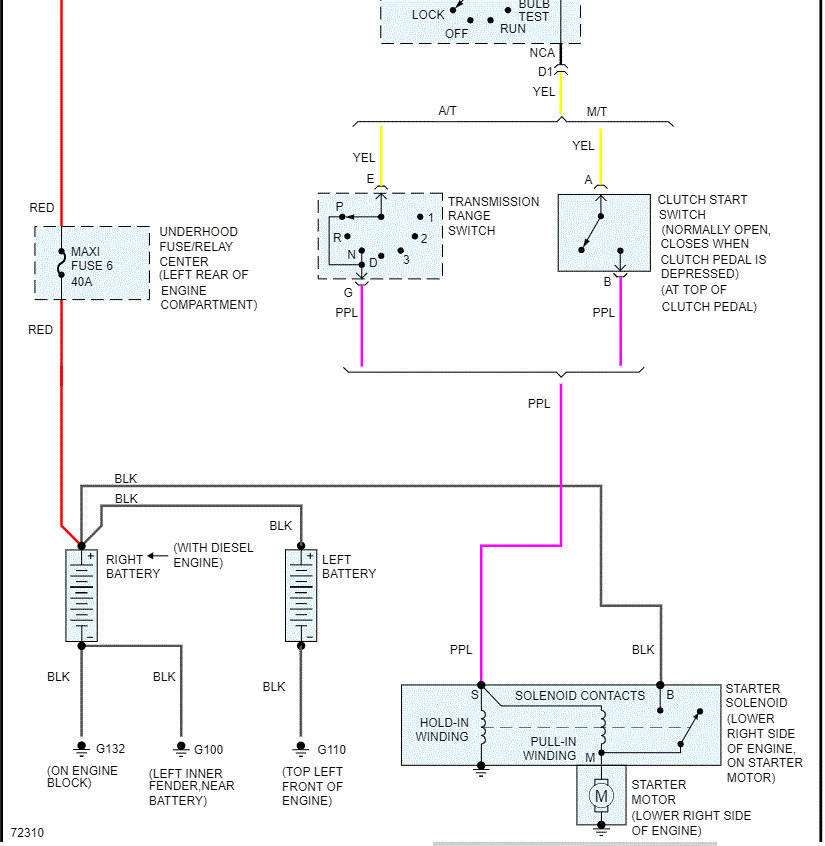

New starter, new battery, no crank, only clicks one time. cleaned cables.
Aug 1, 2020 at 11:21 AM
  • 110,240 POSTS
Have you made sure the main ground to the engine block is in good condition?
If so, I need you to check for power to the purple wire going to the starter solenoid. It will only have 12v when the key is in the start position. You will need a helper to check that. Also, reconfirm that the wires on the new starter are tight.
I attached a pic of the wiring below. Just for the heck of it, see if it starts in neutral. Also, take a look through this link. It explains how to test the starter.
The idea that you get one click usually indicates either a weak battery or a poor connection. Since you have already replaced both the starter and battery, I have a feeling it is a connection unless there is a chance the engine is locked up.
Let me know what you find.

Thanks Joe, cleaned ground mounted on stud on intake and it turned over and started faster than I ever heard! I drove it 14 miles with no accessories on. Turned off engine and it started right up. Let it sit 2 minutes.. no start (engine turnover) again! Only 1 click now?

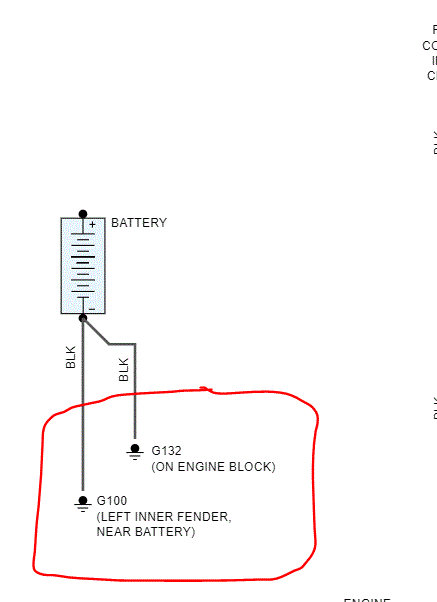

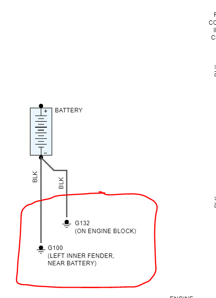

As far as the grounds, from the battery there are two. One of them goes to the engine block and the other is grounded to the inner fender close to the battery. See the attached pics.
Aug 4, 2020 at 3:25 PM
MARK UNDERWOOD2
  • 24 POSTS
Hey Joe, disregard the statement about the tiny fitting on ground cable for I guess I am okay, old and blind! Lol The fitting I was referring to was not a fitting at all! It was a ring terminal mounted on stud! Wasn't very dirty but cleaned it anyway and viola! Engine turns over, runs, etc.
