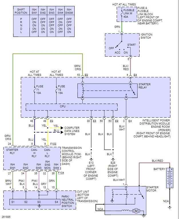

I have no crank at all when trying to start. I have checked the battery,12.4 volts. The connectors are good as well. I have checked the starter and its good too. When I turn the key I am not getting a signal to the solenoid.

Check the fusible link M in the fuse & fuse link box, near the battery and out your finger tips on the starter relay in the IPDM and feel if it clicks 1 time when the key is turned to start.
