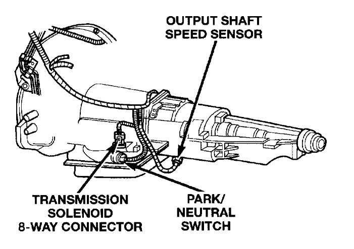

Hello, so looking at the wiring diagrams for the transmission, you had just the harness from the transmission to the PCM replaced? The PCM controls the transmission but there is a section of harness that runs to the transmission for the valve body control.
There is an 8-wire connector to the Transmission which has a 5volt Reference feed to it, and if these 5vRef wires get shorted due to a sensor or to ground it can cause the PCM to shut down. So, there's some things we can check. I'm going to see what else uses this same 5vRef. Because many times it is shared inside the PCM and goes out to sensors on the engine.

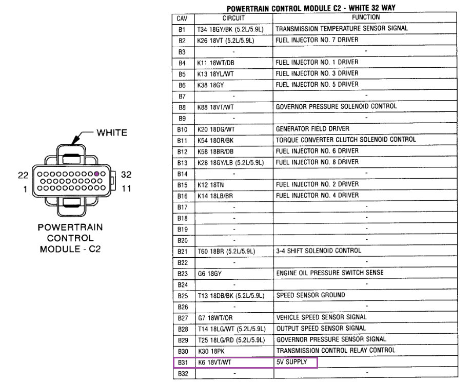

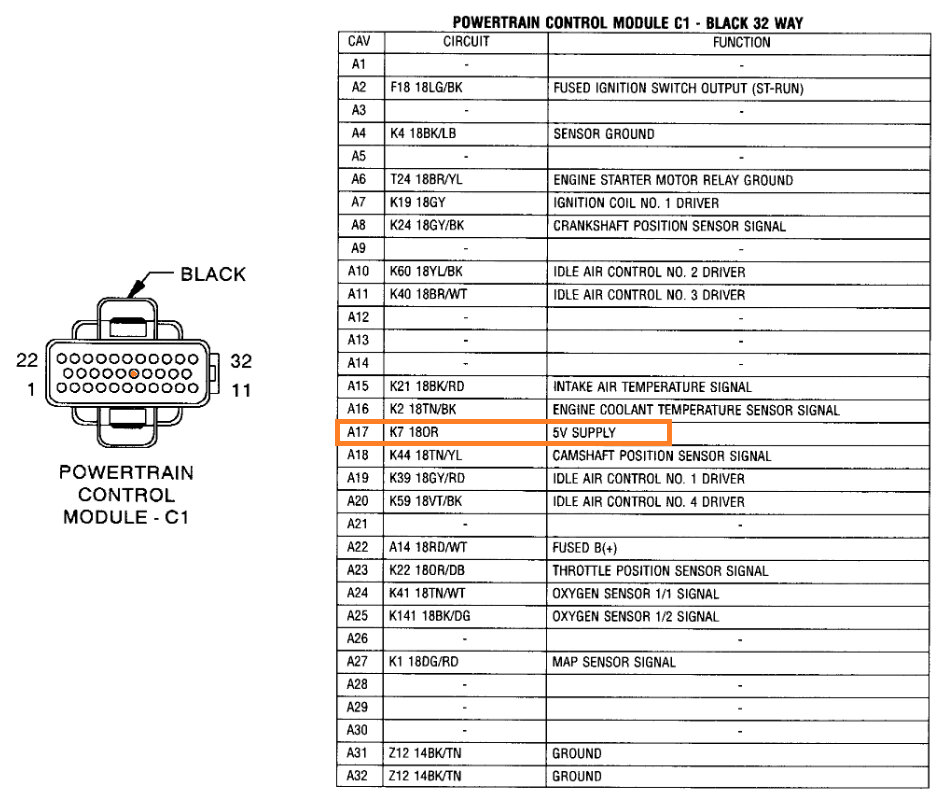

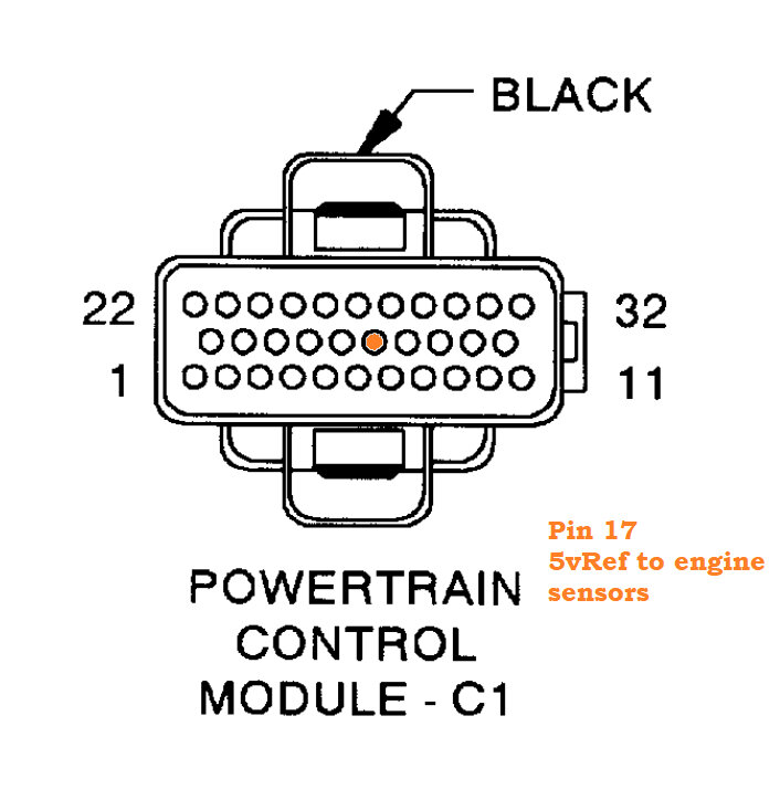

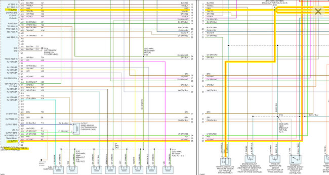

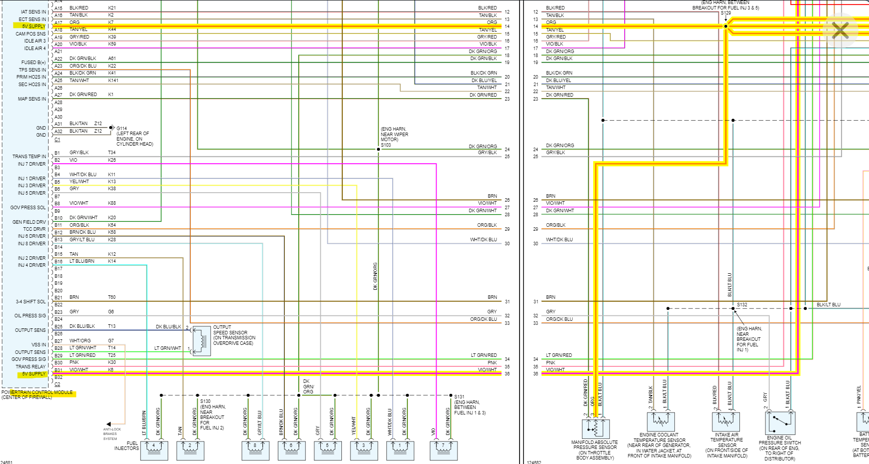

Yes if a 5vReference gets shorted out it can cause the computer to shut down or not communicate. Let me get a diagram for you to check the 5vRef. Some vehicles have multiple reference circuits that are not shared inside the computer but on these older vehicles most are shared inside the computer from the same voltage regulator.

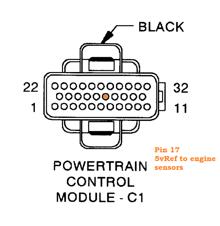

As an example, here you can see two 5vRef circuits. The bottom one (pin B31) is the circuit that goes to the Transmission. The upper 5vRef circuit goes to the engine sensors (MAP, TPS, CrankSen, and to the Cam Position sensor inside the Distributor.
So, with the Key On, engine Off the Throttle position sensor or the MAP sensor are probably the easiest to get to. If you unplug either 3 wire sensor- 1 wire will be a 5vref, a 2nd wire will be a Ground and the 3rd wire will be the signal wire to the PCM.
If this problem only occurs when the engine is hot, then you'll have to catch the issue at that time. Checking to see if the 5vRef is either missing or is lower than it should be.
Since we don't know if the 5v is shared internal to the PCM you should be prepared to check them when the fault happens. If the sensor 5volts is ok, then check the 5v going out from the PCM to the Transmission.
Do you have a multimeter and how long does the fault last when it occurs ?

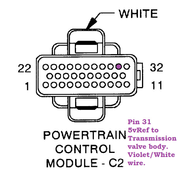

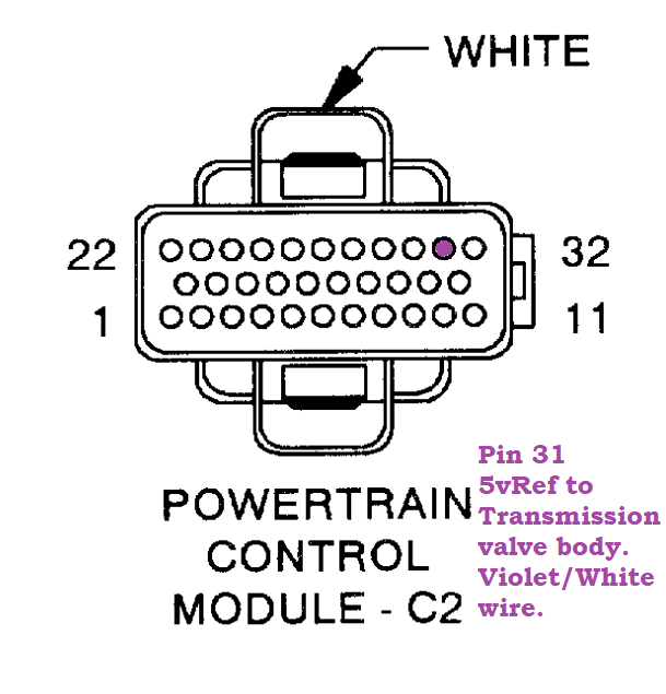

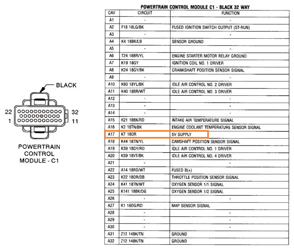

These are the PCM connectors that have both 5v feeds, The C1 connector pin 17 is an Orange wire and feeds the engine sensors.
PCM connector C2 pin 31 is a Violet/White wire that feeds 5vRef to the Transmission valve body.

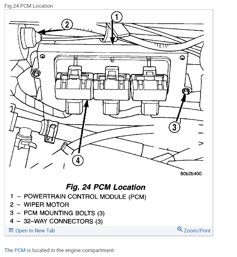

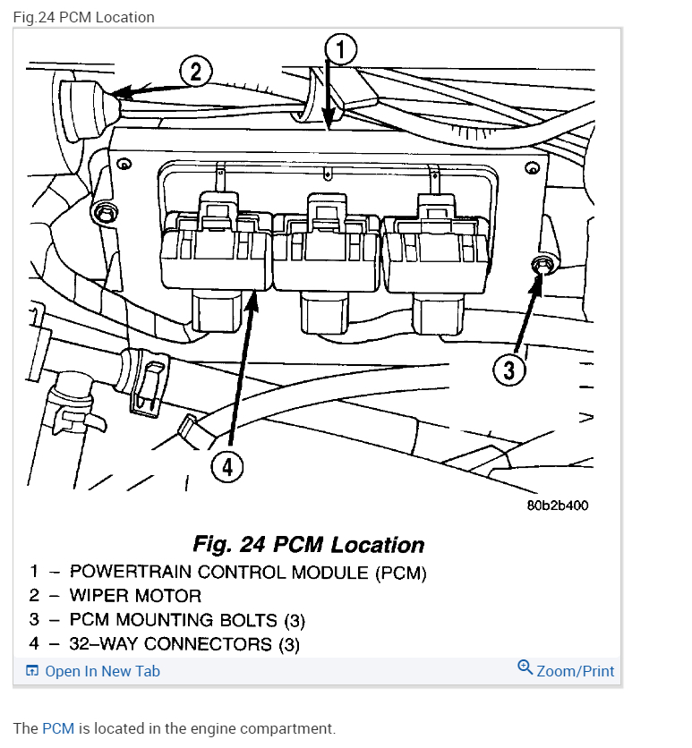

the PCM is mounted on the center of the firewall in the engine compartment. Hopefully you can get to it, The 6th diagram shows the PCM, the plastic covers on the back of the connectors can come off to access the back of the connector and wires. Or you can go
to the throttle body and check the throttle position sensor 5volts.

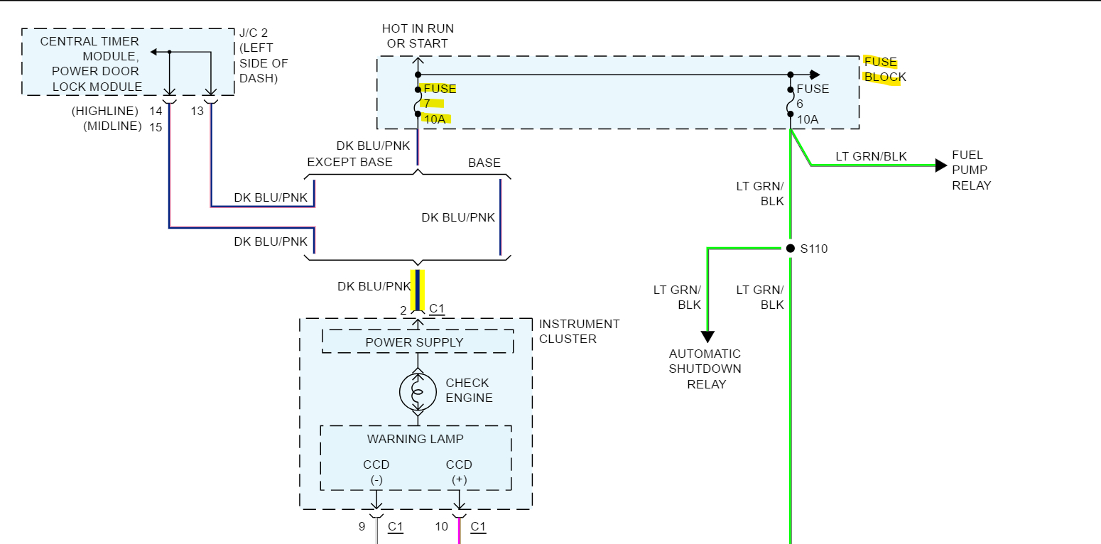

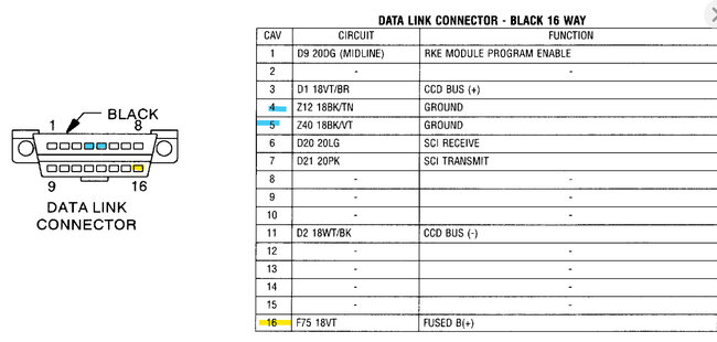

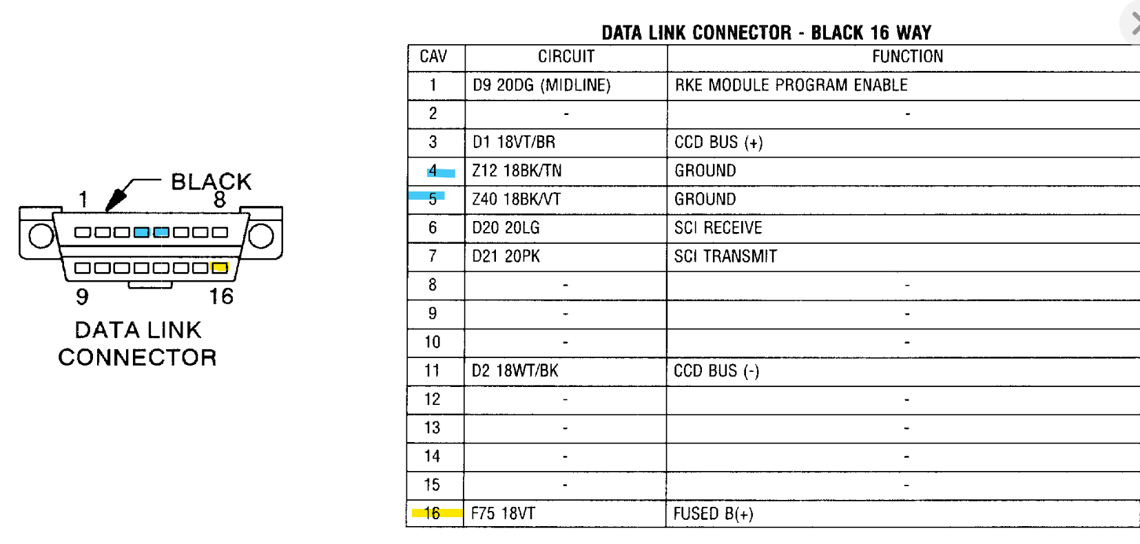

This is the Data Link Connector that you plug your scan tool into. With the Key On engine off. Check if you have power on pin 16, using first pin 4 as Ground and then use pin 5 as Ground. Don't push the meter leads into the connector, just touch the pins lightly, so the connector pins dent get spread. Let's see if there is power and both grounds there. I'm wondering if they forgot to tighten a ground wire or didn't put on in the correct place when replacing the harness section.
Check this Fuse 7 as well.
