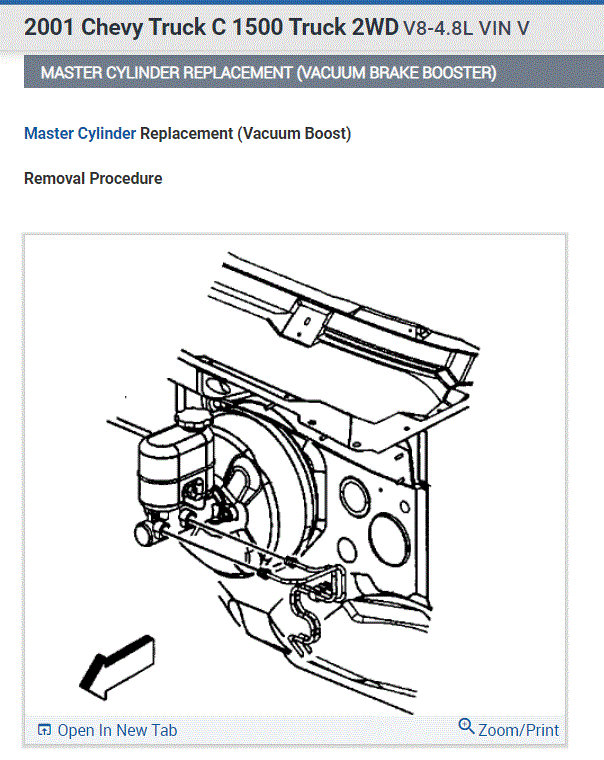

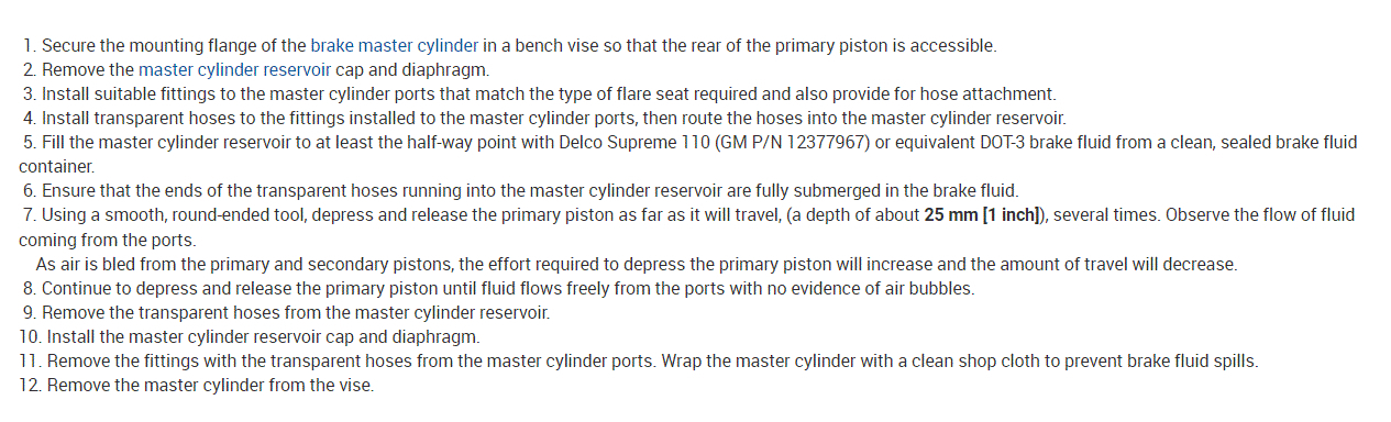

Replaced pads, rotors, calipers and bled the brakes but no brake pedal.
Jul 10, 2020 at 7:51 AM
  • 110,236 POSTS

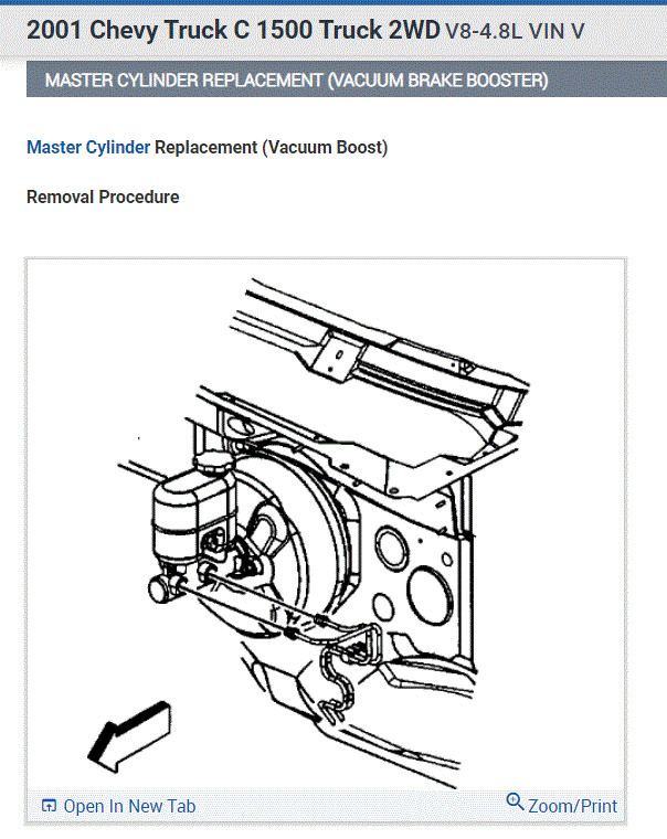

The brake master cylinder isn't too hard to replace. It will require a few different steps, but nothing too hard.
To get you started, here is a link that explains how one is replaced in general. You can use this as a guide.
https://www.2carpros.com/articles/how-to-replace-a-brake-master-cylinder

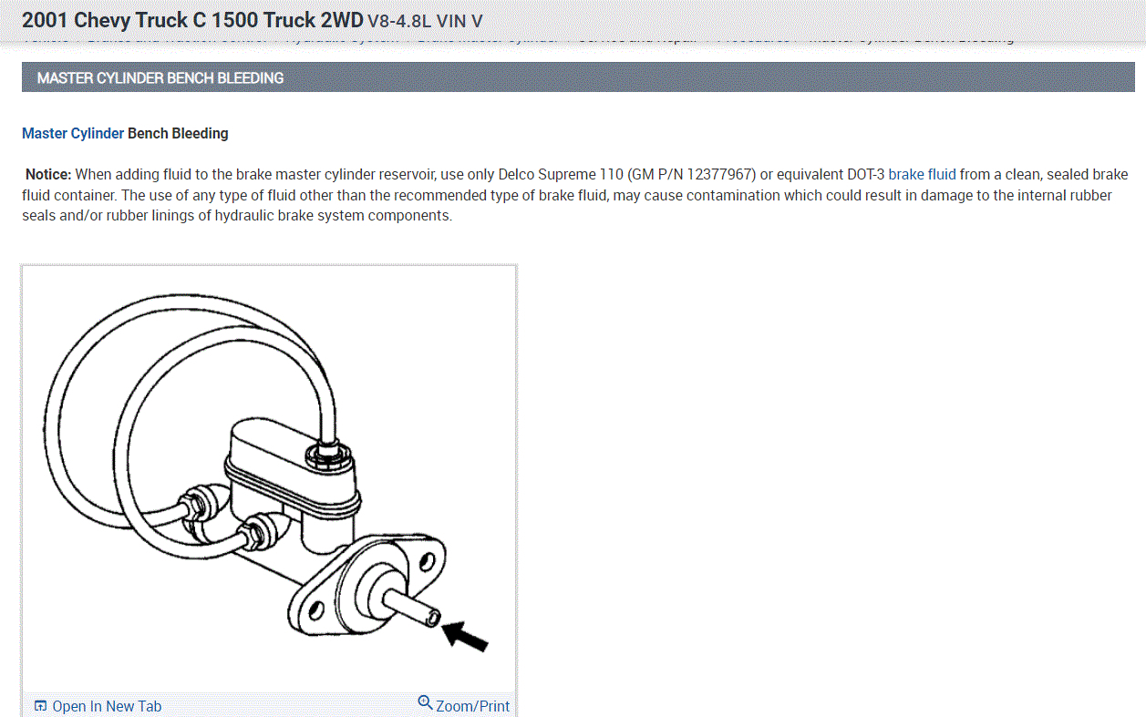

Next, here is a video showing how to bench bleed a new master cylinder. You will need to do this before installing it.
https://youtu.be/WDxvEQrMkBg

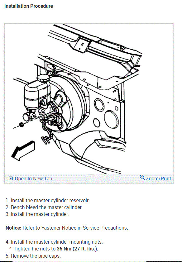

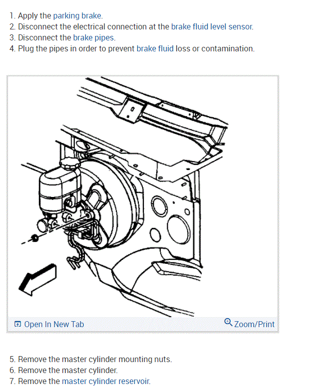

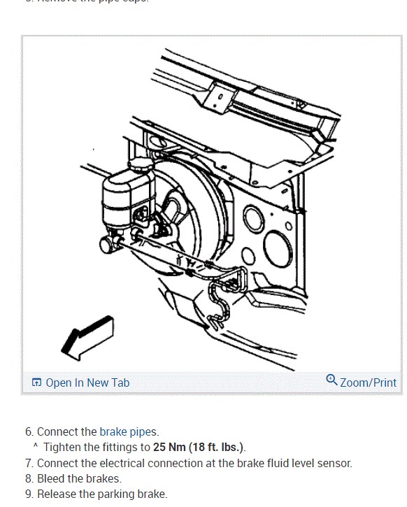

Now, if you look at the attachments below, I included the directions specific to your vehicle for bench bleeding and removal and replacement. The pics correlate with the directions.
See pics below
