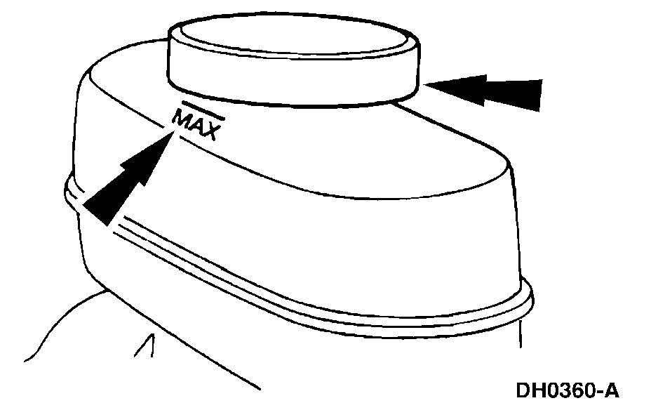

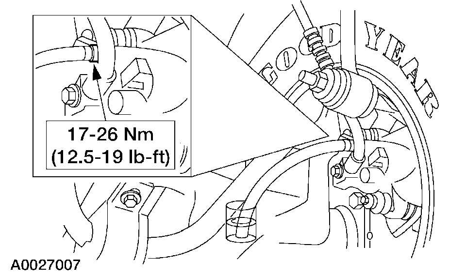

No brake pedal.Bleed brakes but the front two would not bleed. Why wouldn't the front 2 bleed? How do I get a pedal ? What is wrong ?
Aug 8, 2019 at 11:33 AM
  • 110,194 POSTS
Welcome to 2CarPros.
It sounds like the master cylinder is bad. There is a primary and a secondary plunger in it. One my be allowing the fluid to bypass. The primary (for the front brakes) must be bad.

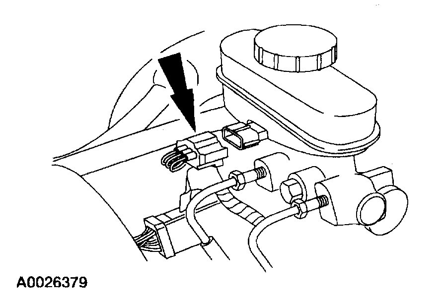

Removal
pic 1
1. Disconnect the brake tubes.
pic 2
2. Disconnect the brake master cylinder fluid level switch connector.

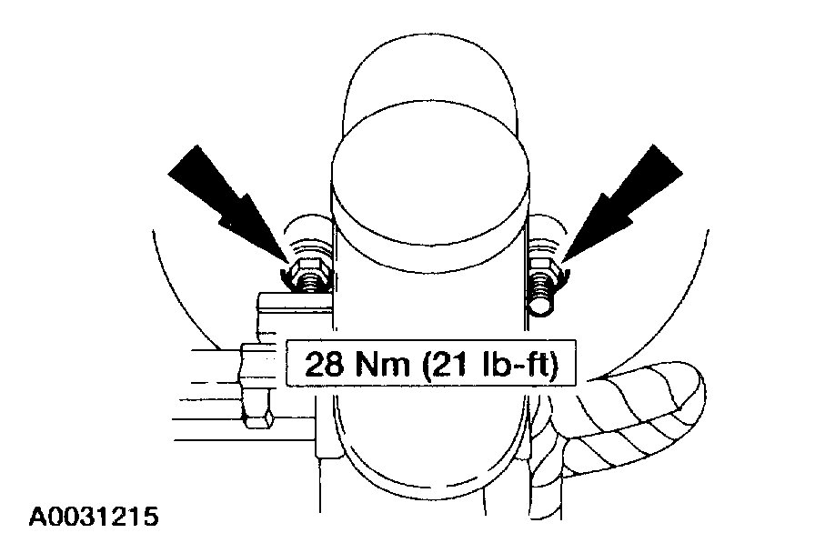

pic 3

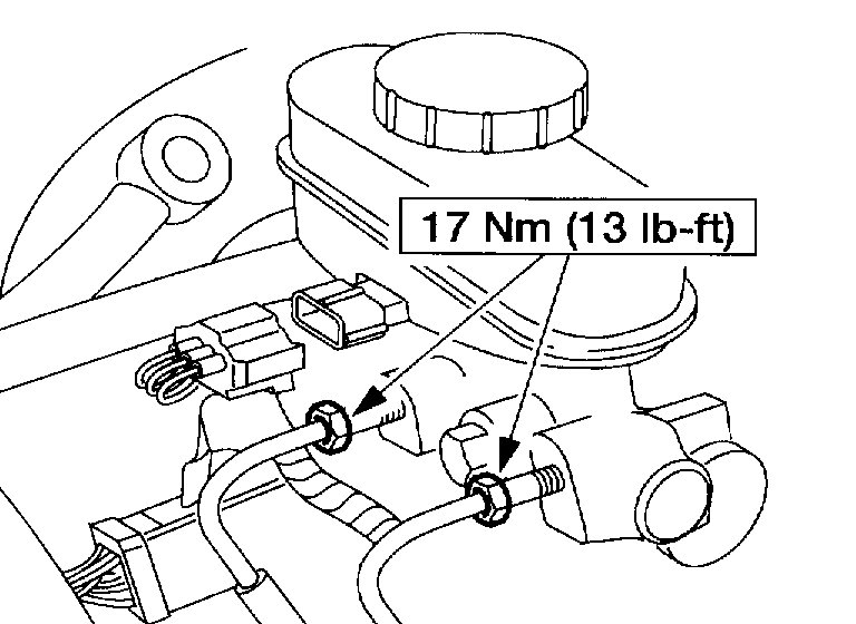

3. Remove the brake master cylinder nuts.

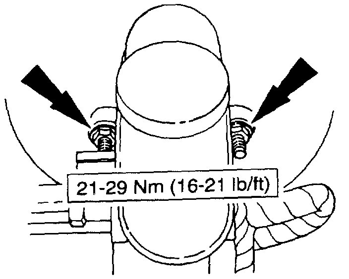

pic 4

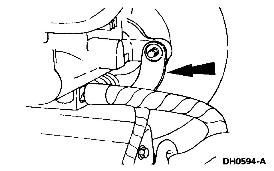

4. Remove the wiring harness bracket and position aside.
5. Remove the brake master cylinder.

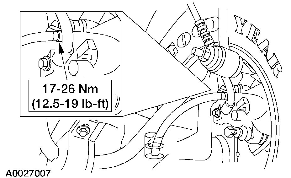

Installation
pic 5
pic 6
1. To install, reverse the removal procedure.

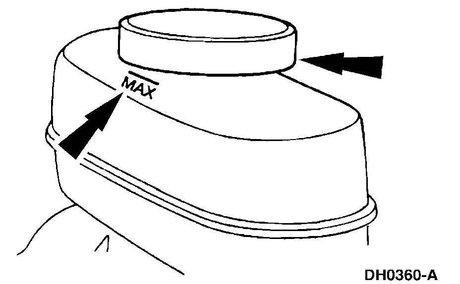

pic 7

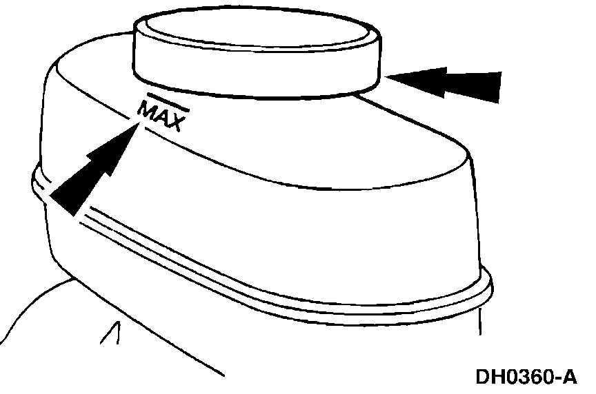

2. Clean all dirt from and remove the brake master cylinder filler cap and fill the brake master cylinder reservoir with the specified brake fluid.
3. NOTE: For ABS vehicles only, open the master cylinder bleed screw until clear, bubble-free fluid flows from the tube into the cup.

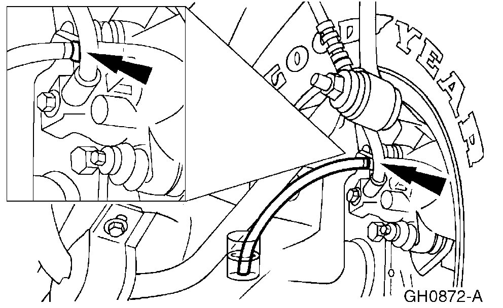

NOTE: Bleed the brake system in the order displayed on the scan tool or bleed from the longest to the shortest brake line.
pic 8

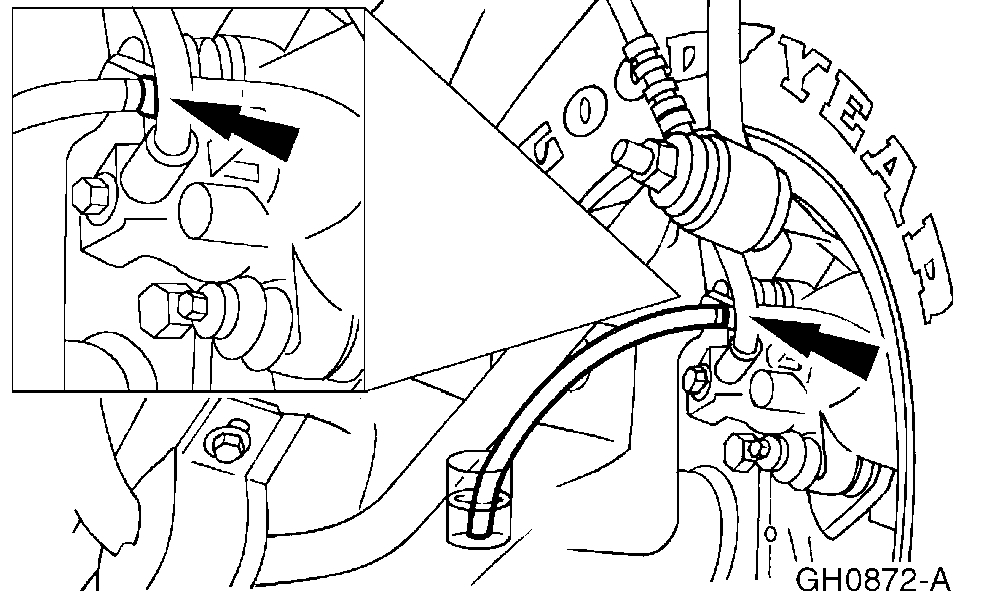

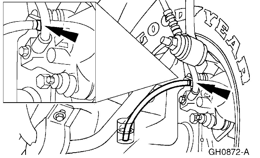

Place a box end wrench on the bleeder screw. Attach a rubber drain tube to the bleeder screw and submerge the free end of the tube in a container partially filled with clean brake fluid.
4. Have an assistant hold firm pressure on the brake pedal.
5. Loosen the bleeder screw until a stream of brake fluid comes out. While the assistant maintains pressure on the brake pedal, tighten the bleeder screw.
^ Repeat 3 times until clear, bubble-free fluid comes out.
^ Refill the brake master cylinder reservoir as necessary.
pic 9
6. Tighten the bleeder screw.
7. Repeat Steps 3, 4, 5 and 6 for the remaining bleeder screws in the system.

1. Clean all dirt from and remove the brake master cylinder filler cap and fill the brake master cylinder reservoir with the specified brake fluid.

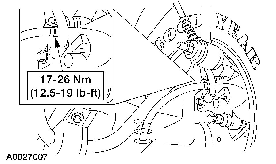

Place a box end wrench on the bleeder screw. Attach a rubber drain tube to the bleeder screw, and submerge the free end of the tube in a container partially filled with clean brake fluid.
