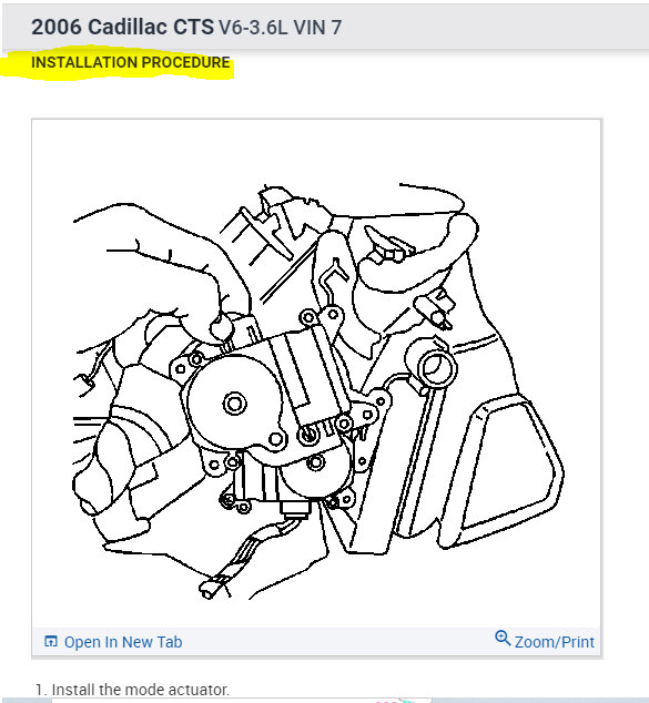

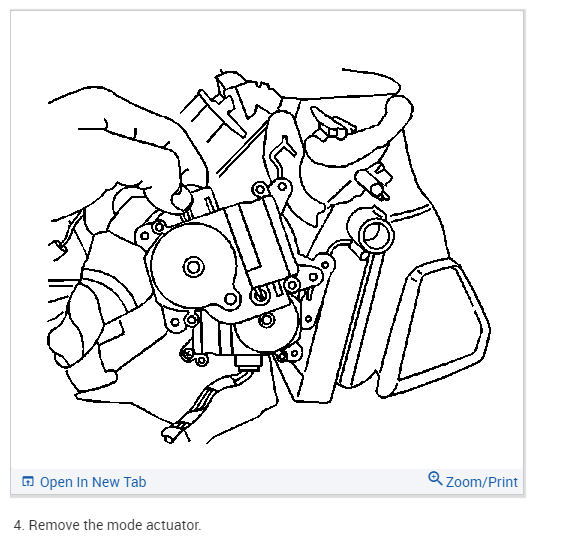

Air from floor and side vents temperature control works for hot and cold. Clicking sound from driver side dash. No air from center console vents.
Nov 1, 2022 at 3:40 PM
  • CAR REPAIR CONTRIBUTOR
  • 110,190 POSTS

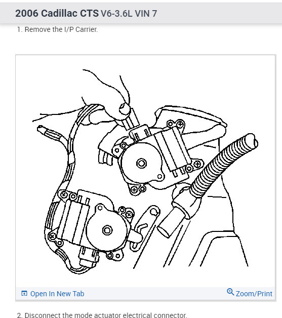

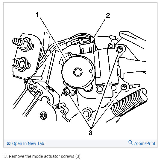

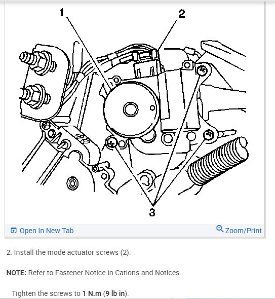

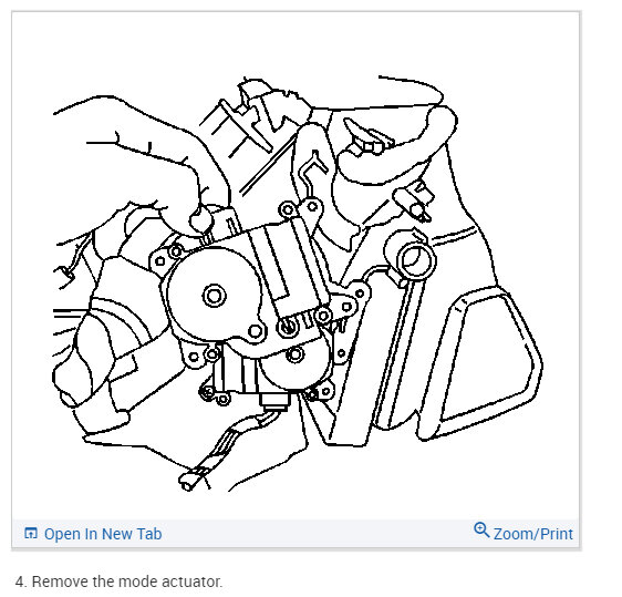

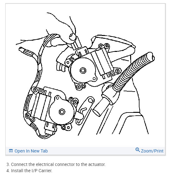

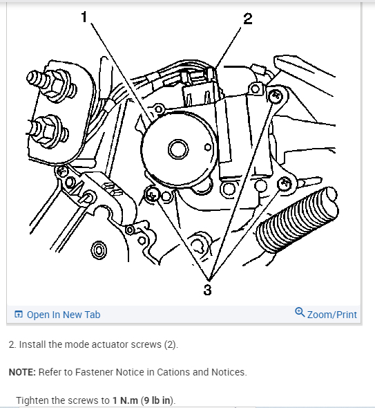

It sounds like the mode door actuator isn't fully working. They have a plastic gear in them, and it is very common for the teeth to strip causing a clicking sound.
Based on your description, my first suspect is the actuator needs to be replaced. I attached directions below for actuator replacement. However, I can't recall if you are able to access it from under the dash without removing the entire instrument cluster carrier. I need you to do some inspecting to determine if you can reach it.
Let me know what you find.
