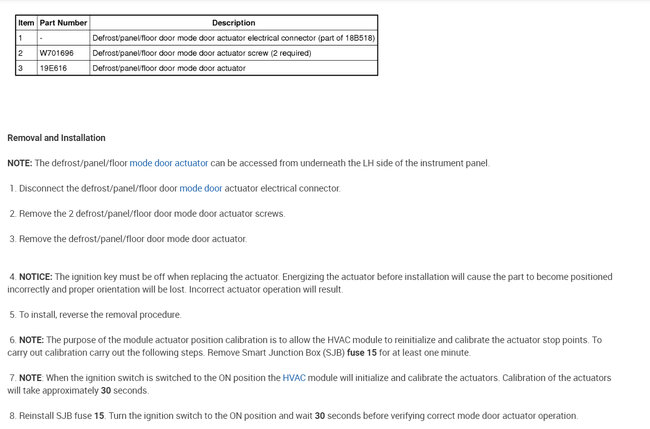

My wife's car recently lost its A/C in the front as well as heating. The back works perfectly fine. I checked fuses and relays all seem to be ok. She does remember a slight knocking noise a few weeks back. I replaced the HVAC A/C Heater Blend Door Actuator (the one right behind the stereo lol) and still no luck. Any advice as to what steps to go through next?

You might want to try resetting the system, this guide can help:
https://www.2carpros.com/articles/step-by-step-guide-to-reset-your-cars-hvac-system-an-essential-for-every

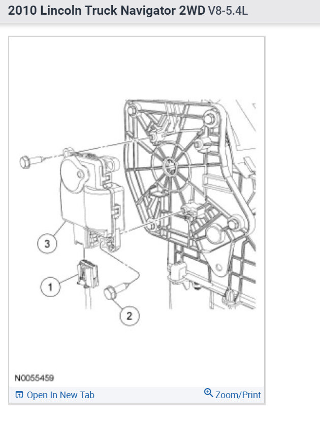

If this doesn't work here is the location of the mode blend door actuator which sounds bad, it has installation instructions as well. Check out the images (below). Please let us know how it goes.
