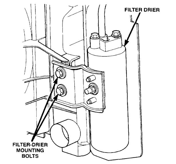

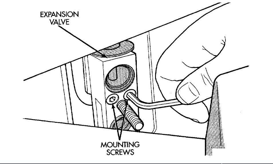

Compressor runs but sounds like it is a rock tumbler. Air gets slightly cool, but definitely not cold. I have rear A/C as well. I have reason to suspect the compressor is shot, did leak test with dye and compressor shows dye. Do I need to replace any other components of the system aside from compressor, before recharging?
Jul 8, 2019 at 1:00 AM
Good afternoon,
Yes, you need to replace the receiver dryer and the expansion valve. They are common to replace when you have a compressor failure.
