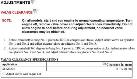

Hey i have a high milage car it has 232000 its noise and knocks only when its cold anything i can do to help. someone told me that the value bolts might be looses ??? is that true if so can do something about it

Hi there, I would say that the valve clearances may not have been done for some time, so here is th method to adjust them. Mark (mhpautos)
https://images.2carpros.com/forum/automotive_pictures/61395_1_59.jpg
