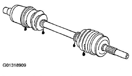

Okay, here is what you want to look for: There are two cv shafts that come out from the transmission to each wheel on the front. Look at each joint-there are 4. Look for a boot that is torn.
https://images.2carpros.com/forum/automotive_pictures/30961_nisdr_1.jpg
This is good explaination of CV shafts: http://www.aa1car.com/library/2004/bf100434.htm If you find a torn boot, you probably have located your problem in which case you'll need to replace that axle.
