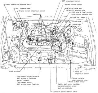

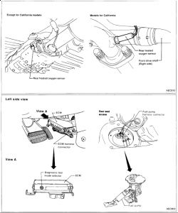

I TOOK CAR TO ADVANCE OUTO PARTS TO CHECK ENGINE LIGHT IS ON, THEY SAID I NEED TO REPLACE OXIGEN SENSOR. WHERE IS TEH OXIGEN SENSOR LOCATED AND HOW CAN I REPLACE IT?
Tuesday, February 2nd, 2010 AT 10:24 AM
  • 75,992 POSTS
1996 Nissan-Datsun Sentra L4-1597cc 1.6L DOHC MFI (GA16DE)
Oxygen Sensor
ECCS Component Parts Location
https://www.2carpros.com/forum/automotive_pictures/12900_oxys1_1.jpg
https://www.2carpros.com/forum/automotive_pictures/12900_oxys2_1.jpg

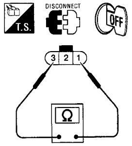

DIAGNOSTIC PROCEDURE
COMPONENT INSPECTION
Front heated oxygen sensor heater
https://www.2carpros.com/forum/automotive_pictures/12900_dpos1_1.jpg
Check resistance between terminals (1) and (3).
Resistance: 3.3 - 6.3 Ohms at 25 °C (77 °F)
If NG, replace front heated oxygen sensor.
CAUTION:
Discard any heated oxygen sensor which has been dropped from a height of more than 0.5 m (19.7 in) onto a hard surface such as a concrete floor; use a new one.

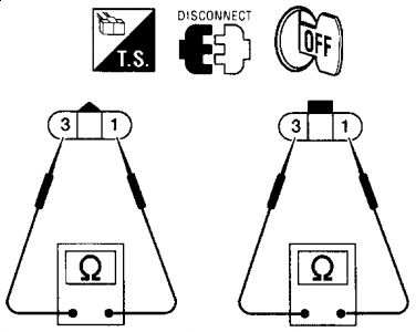

Rear heated oxygen sensor heater
https://www.2carpros.com/forum/automotive_pictures/12900_dpos2_1.jpg
Resistance: 5.2 - 8.2 Ohms at 25 °C (77 °F)
If NG, replace the rear heated oxygen sensor.
CAUTION:
