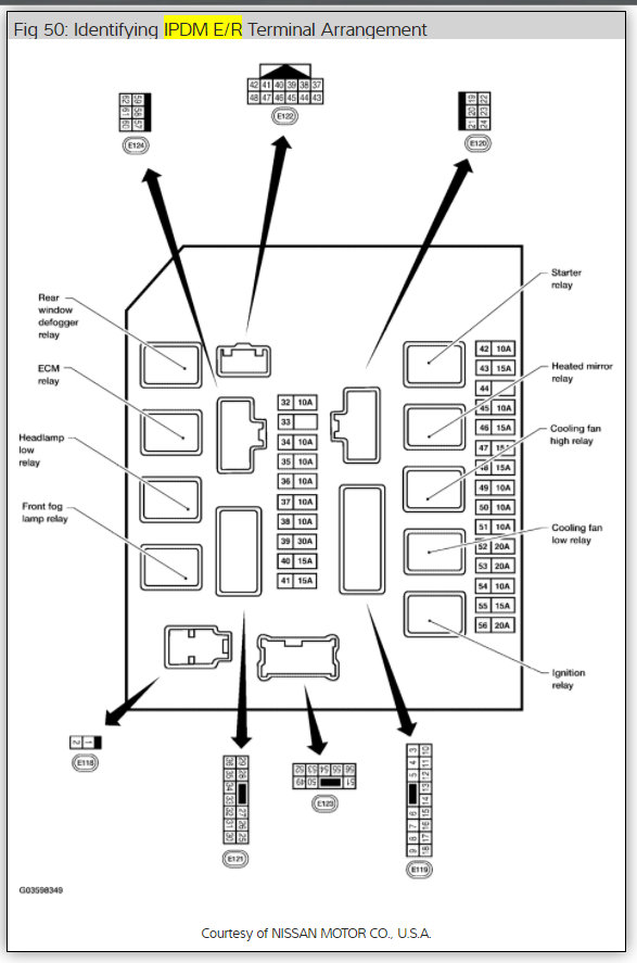

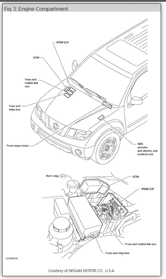

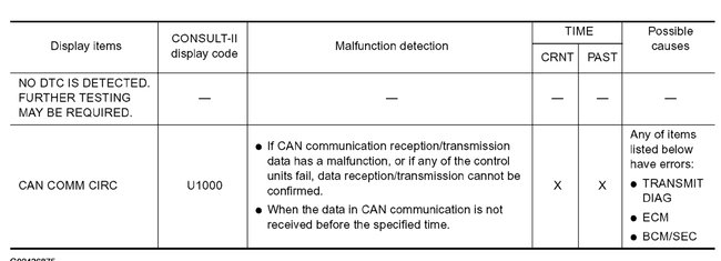

I have a 2005 Nissan Pathfinder SE and my engine service light is now turned on. I went to my a good friend who has a dtc machine and he stated that the dtc code is a u1000. Is this something that is under warranty and is this a big project?
Thank you,
AJ
Feb 6, 2007 at 6:35 AM
SERVICE WRITER
  • 9,123 POSTS

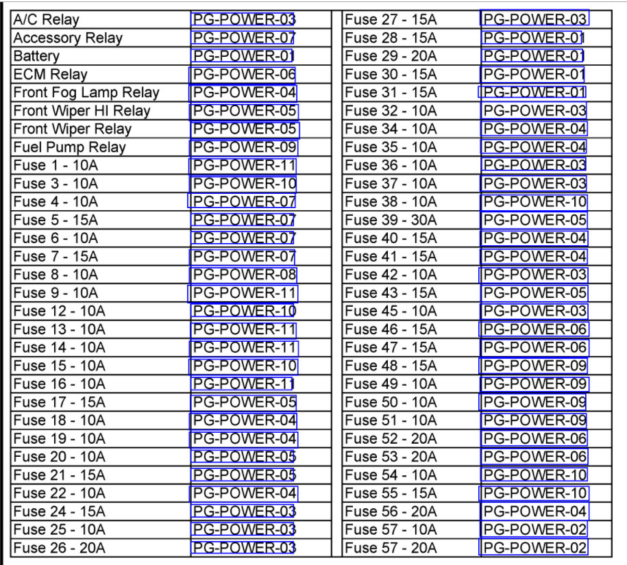

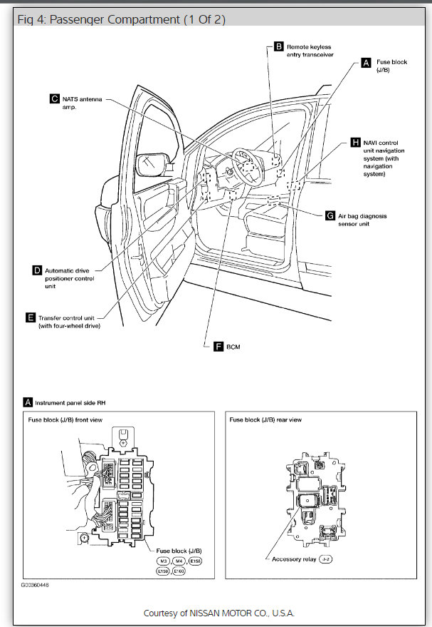

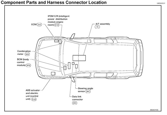

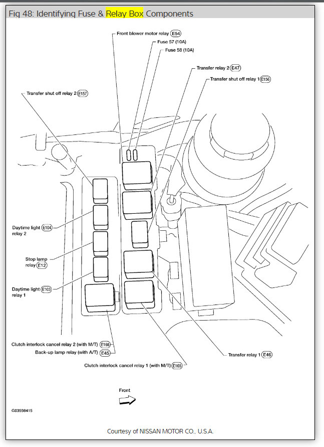

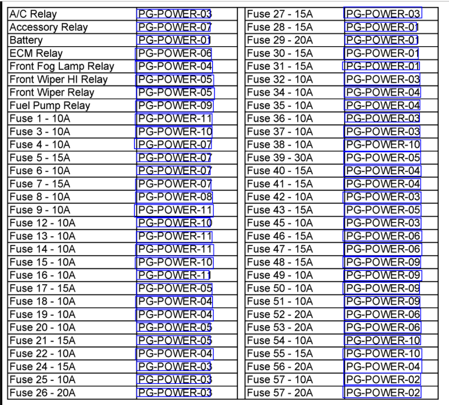

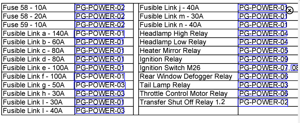

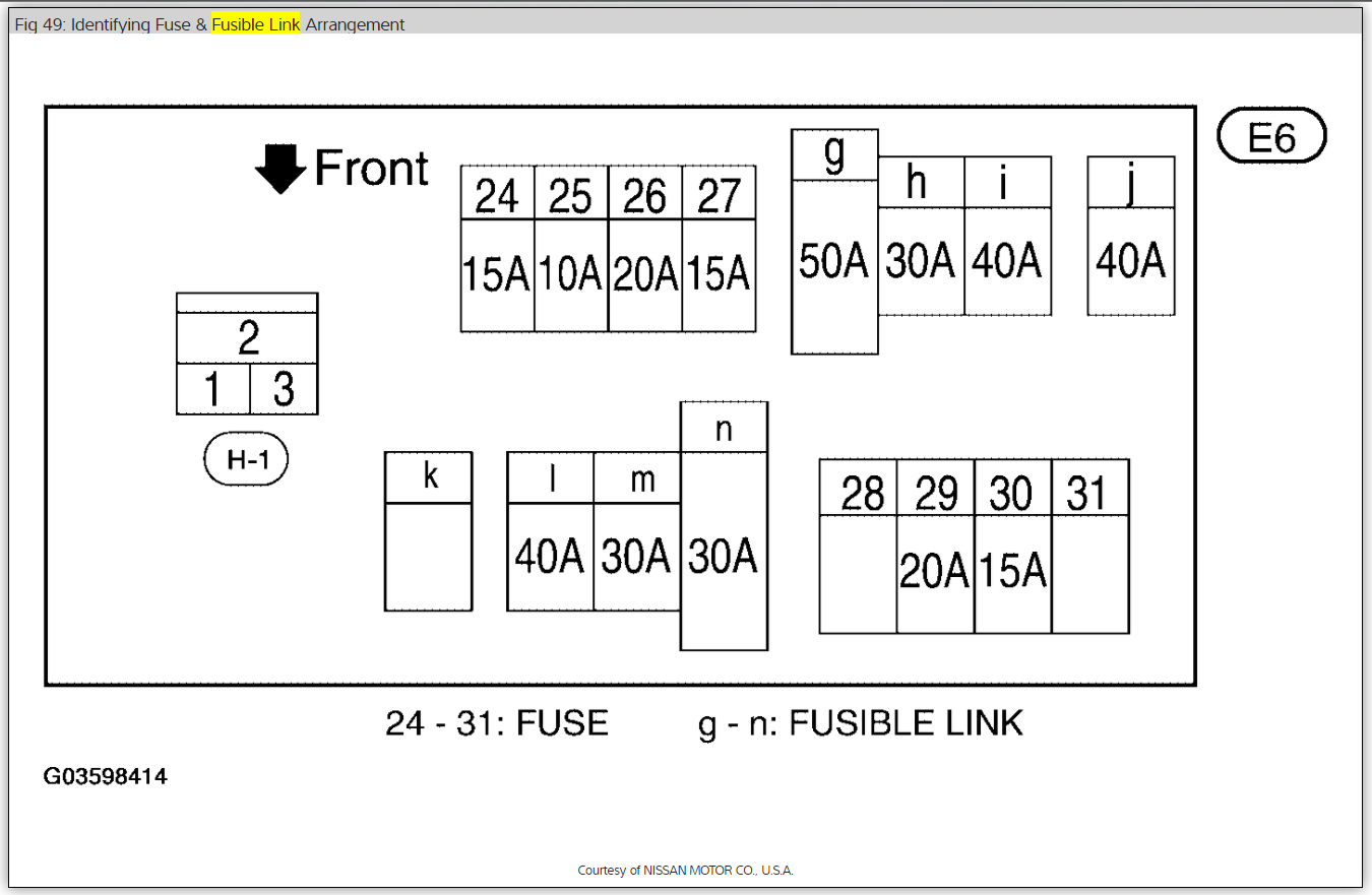

It has to do with the Controller area network (CAN) Communication line not making a connection with other module(s). It means one of the computers is not talking to the network. Two of the most like scenarios is a blow fuse or a bad computer. I would try checking all of the fuses, here is a guide and diagrams to help us get it fixed.
There is an ECM relay that could have gone out as well. There are many fuses that run the CAN so make sure you check them all with the key on.
and
Check the diagrams below.
If all checks okay try a used ECM and plug it in.

Since model year 2003, a growing number of domestic and import vehicles have been built with a new onboard communications protocol called CAN (Controller Area Network). CAN is essentially an engineering standard for how computers and modules talk to one another via the serial data bus in a vehicle's wiring system. It's a high speed standard designed for powertrain control modules, antilock brakes and stability control systems.

Thank you for the guides and instructions, I did some testing and found the computer was bad, I got a used one and plugged it in. Car runs great! thanks you guys.
