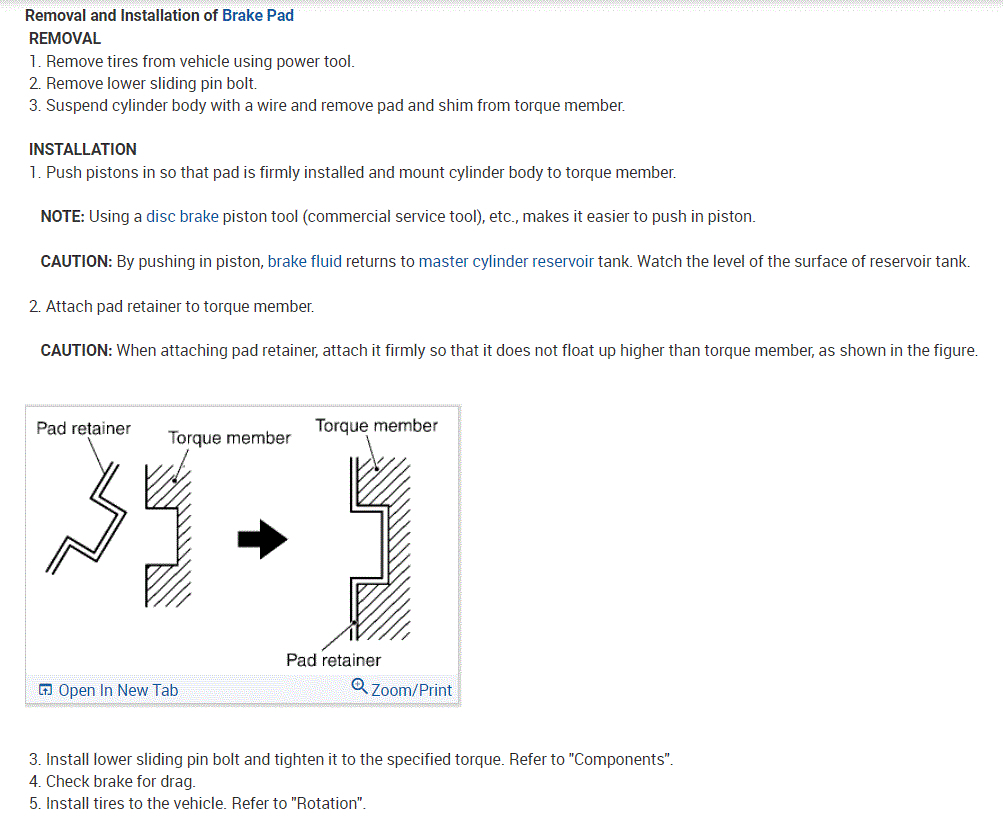

Front brake pad and rotor replacement instructions please?
2005 NISSAN PATHFINDER
97,000 MILES • 6 CYL • 4WD • AUTOMATIC
MOJE1228

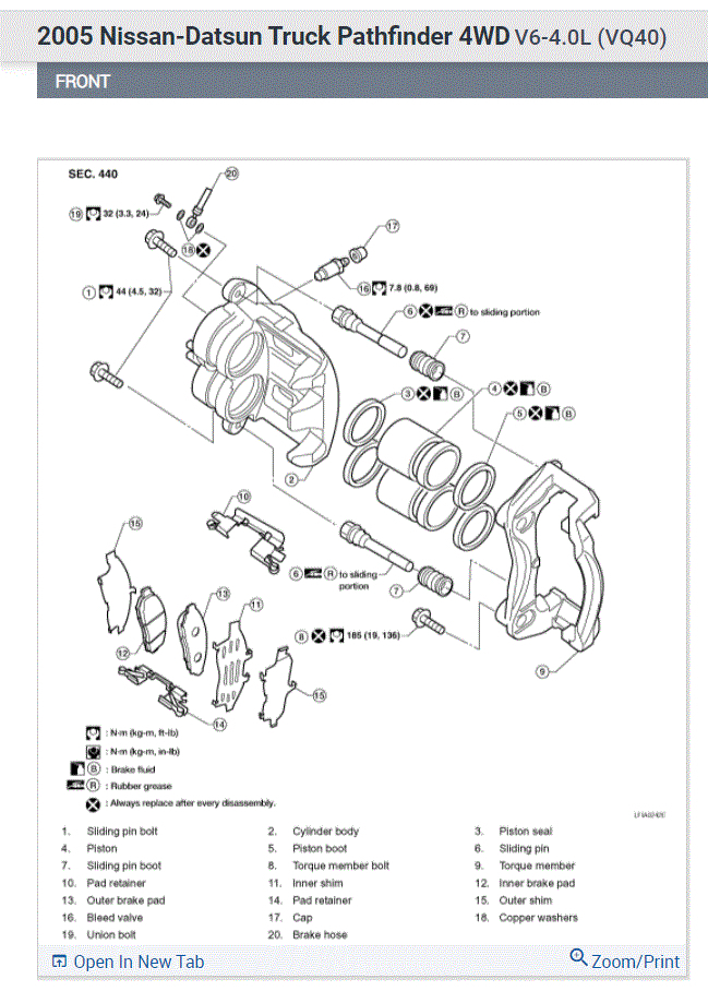

When I am driving my vehicle between 40 and 60 MPH it shakes vigorously when I hit the brake they say I need new brakes.

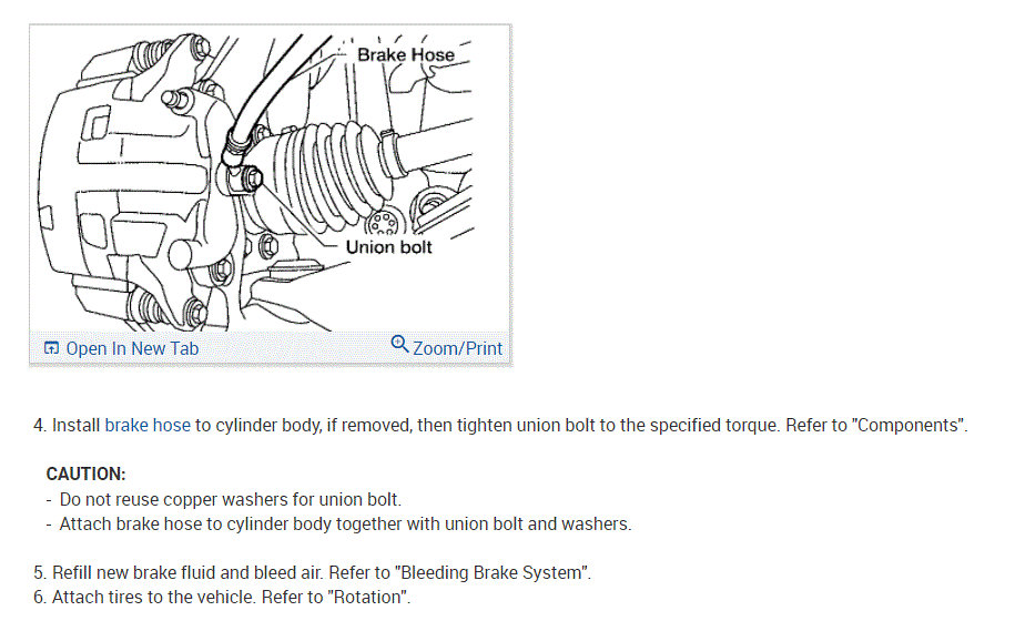

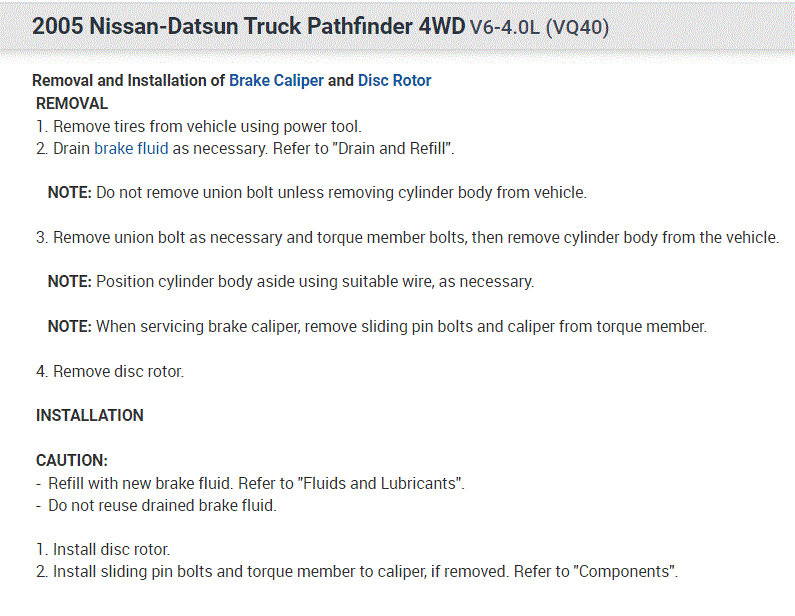

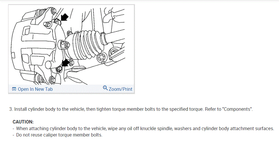

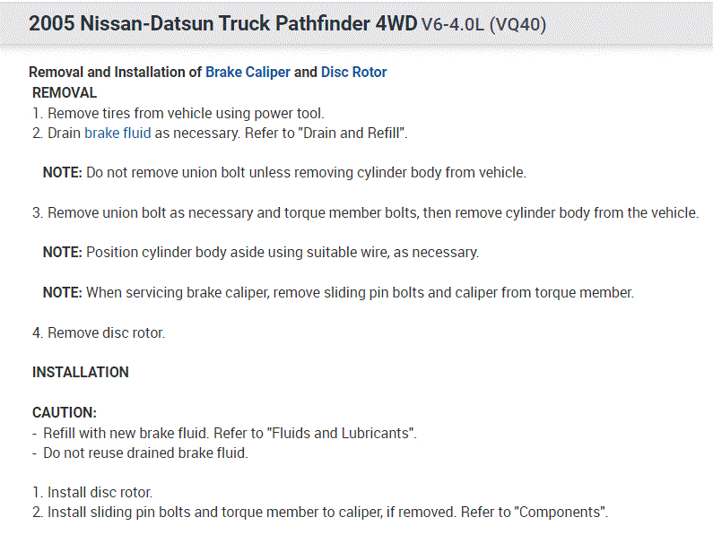

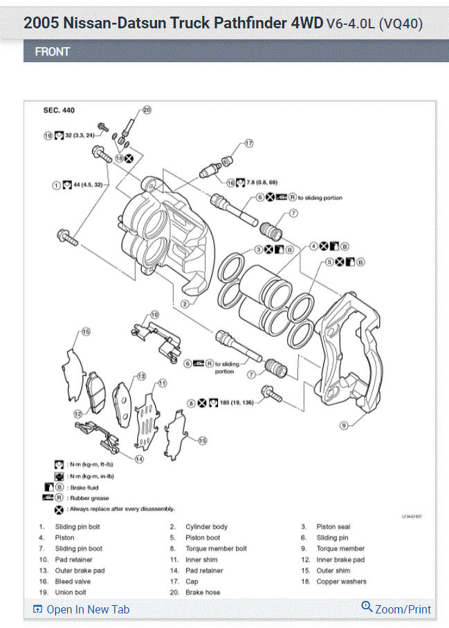

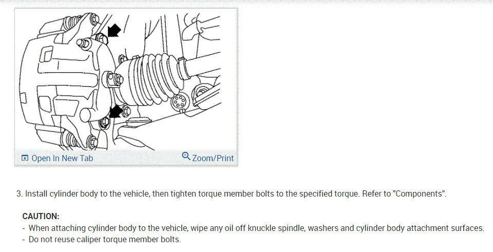

Replacing front brakes and rotors really isn't too hard. Under normal conditions, you can expect them to last approximately 25,000 miles. However, that can change based on driving habits and terrain.This video shows the job being done on a similar car but the process is the same.
https://youtu.be/mOyHFT0hoKc
and
https://youtu.be/p6smTU_SnPg
To get you started, here is a link that shows in general how it is done. You can use this to help guide you in the process.
If you look at the attachments below, they include the directions and pics specific to your vehicle for replacement.
