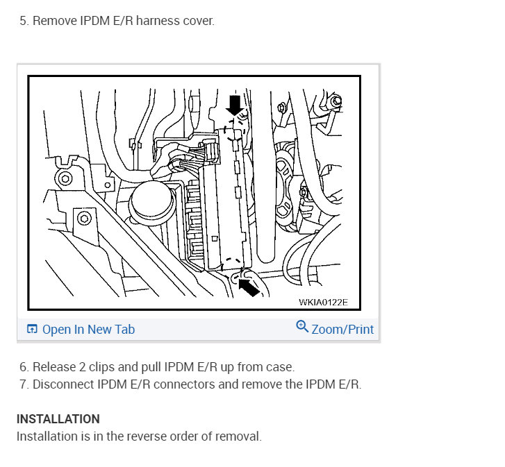

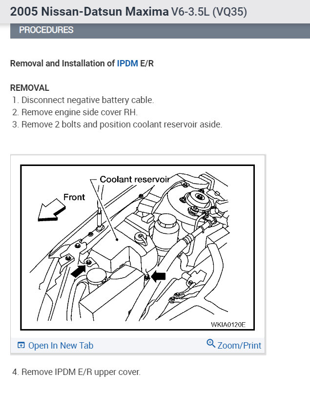

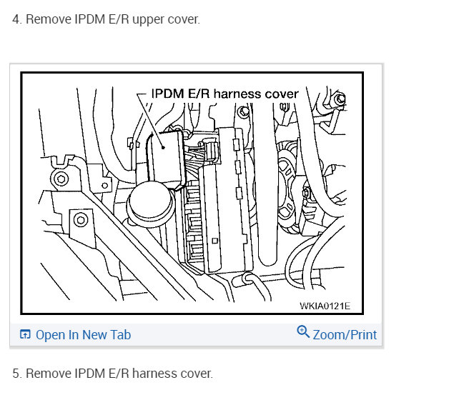

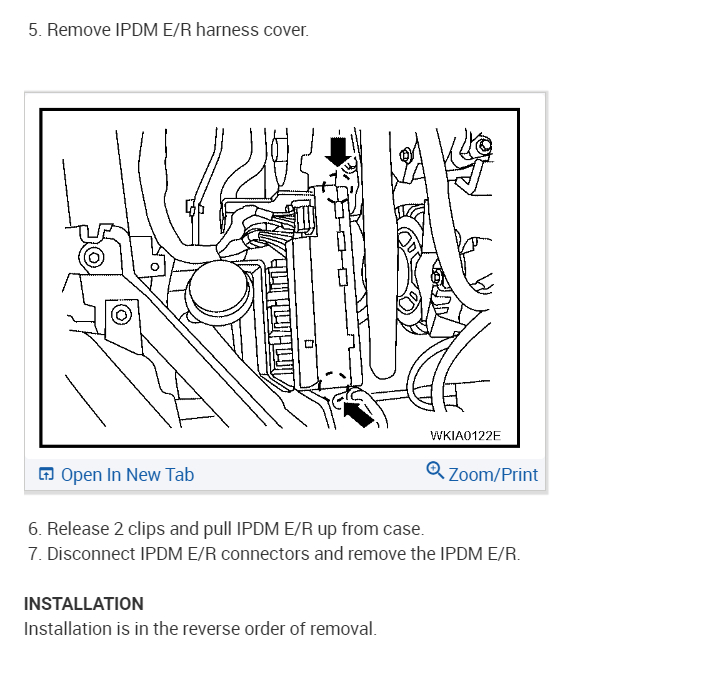

Okay, we need to run a CAN scan which is easy to do. This will go over the entire car to see what codes it finds; it sounds like the BCM is not programmed correctly. Also, it could be a faulty IPDM which is common. You can get a CAN scanner from Amazon for about $30.00.
https://youtu.be/u-4syLc-ifQ
Here is a scanner link:
https://amzn.to/3o41KcZ
You can try a hard reboot which is done by removing the negative side of the battery, with the cable loose from the negative side of the battery, hold it to the positive terminal for 1 minute this will discharge the memory capacitors in the BCM and PCM allowing the system to reboot. Here is how to replace the IPDM just in case you need it. Check out the diagrams (below). Please let us know what you find. We are interested to see what it is.
