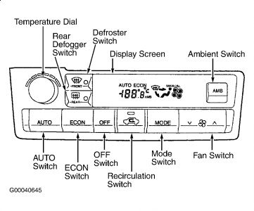

Start engine.
Within 10 seconds of turning ignition on, press and hold A/C-heater control panel OFF switch button.
Hold OFF switch button for at least 5 seconds.
Select desired self-diagnosis step by rotating temperature dial clockwise or counterclockwise.
To advance to next self-diagnosis step, rotate dial clockwise.
To return to previous self-diagnosis step, rotate dial counterclockwise.
To access AUXILIARY MECHANISM: TEMPERATURE SETTING TRIMMER, select SELF-DIAGNOSIS STEP 5 and press fan up arrow switch. Auxiliary mechanism tests temperature setting trimmer.
This guide can help

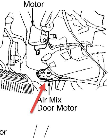

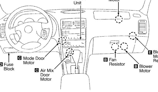

Check coolant level first #1 cause of no heat. Then check to make sure both hoses going into heater are hot. Then check ducts and whether temp cable hasn't broken see pic if electrically operated make sure it's getting power to motor.
