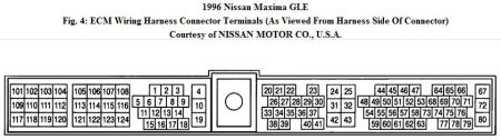

HI WE HAVE A NISSAN MAXIMA THE CHECK ENGINE LIGHT IT ON
THE MACHINE SAID THIS INFORMATION
P-1400
P-0136
P-0446
P-0440

Hi COMERCIALAUTOSERVICE,
Thank you for the donation.
Here are the description of the various codes.

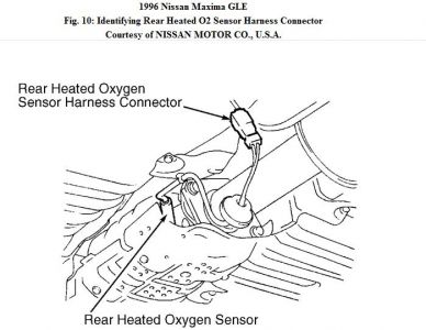

DTC P0136 - REAR HEATED OXYGEN (O2) SENSOR HEATER
Check Ground Circuit - Turn ignition switch to OFF position. Disconnect rear heated O2 sensor and ECM harness connectors. Using an ohmmeter, check continuity between rear heated O2 sensor harness connector terminal No. 1 and ECM harness connector terminal No. 105 (Purple wire). If no continuity exists, repair open in Purple wire. If continuity exists, check continuity between ECM harness connector terminal No. 112 (Black wire) and ground. If no continuity exists, repair open in Black wire. If continuity exists, go to next step.
2 . Check Power Supply - Turn ignition switch to ON position. Using a voltmeter, measure voltage between rear heated O2 sensor harness connector terminal No. 3 (Red/Black wire) and ground. If battery voltage does not exist, repair fault in Red/Black wire as required. If battery voltage exists, go to next step.
3 . Check Input Signal Circuit - Turn ignition switch to OFF position. Using an ohmmeter, check continuity between ECM harness connector terminal No. 56 and rear heated O2 sensor harness connector terminal No. 2 (White wire). If no continuity exists, repair open in White wire. If continuity exists, check continuity between ECM harness connector terminal No. 56 (White wire) and ground. If continuity exists, repair short in White wire. If no continuity exists, go to next step.
4 . Check Component - Inspect rear heated O2 sensor. Replace rear heated O2 sensor as required. Disconnect and reconnect harness connectors in circuit and perform FINAL CHECK .

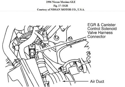

DTC P1400 - EGRC SOLENOID VALVE
1 . Check Power Supply - Turn ignition switch to OFF position. Disconnect EGRC solenoid valve harness connector. Turn ignition switch to ON position. Using a voltmeter, measure voltage between EGRC solenoid valve harness connector terminal No. 2 (Red/Yellow wire) and ground. If battery voltage does not exist, check for blown fuse No. 17 or fault in Red/Yellow wire. Replace or repair as required. If battery voltage exists, go to next step.
2 . Check Output Signal Circuit - Turn ignition switch to OFF position. Disconnect ECM harness connector. Using an ohmmeter, check continuity between EGRC solenoid valve harness connector terminal No. 1 and ECM harness connector terminal No. 103 (Blue/Black wire). If no continuity exists, repair open in Blue/Black wire. If continuity exists, go to next step.
3 . Check Component - Inspect EGRC solenoid valve. Replace EGRC solenoid valve as required. Disconnect and reconnect harness connectors in circuit and perform FINAL CHECK .

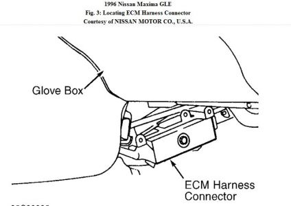

HI GAN YOU HAVE LOCATED FOR THIS PARTS?
IN CASE THX

Do you mean the location of the parts in the vehicle? I have only the following for the repairs indicated in previous post.
https://images.2carpros.com/forum/automotive_pictures/192750_ECM96MaximaFig03_1.jpg
https://images.2carpros.com/forum/automotive_pictures/192750_ECM96MaximaFig04_1.jpg
https://images.2carpros.com/forum/automotive_pictures/192750_HO2S96MaximaFig10_1.jpg
https://images.2carpros.com/forum/automotive_pictures/192750_EGR96MaximaFig17_1.jpg
