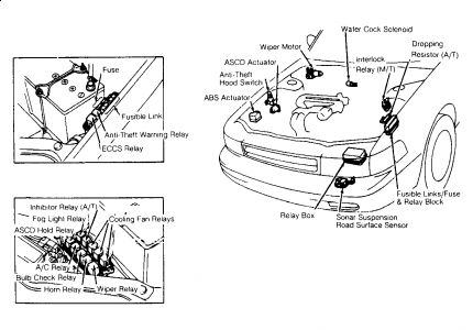

I bought a new battery then the next day my car wouldn't start all you could hear was a click then no power in the car. So I cleaned the connection to the neg cable and the car would start. Now anytime the car is turned off there is no power to the car, even the horn doesn't work in order for anything to work it has to be running. When the car is started everything like the clock and radio is reset I was going to buy a pos cable but it is a speciality item running at $100 so I want to see if it could be something else before I buy a cable for that much the cable has some connectors on it that go to fuses or something. Thank you so much for any help you can give.

Hi Check gray fuseible link comming off pos batt term. If good go to relay/link box by batt. Check all links replace as needed. Let me know Thnaks for donate
https://images.2carpros.com/forum/automotive_pictures/198357_Graphic_137.jpg

So the battery is not charging, I had it tested and it seemed like the alternator so I took it out then had it tested and it is working fine. I changed the fuseable links but still draining the battery. So all together New battery, new neg cable, new fuseable links, checked the alternator. What next???

Do you have a Volt Ohm Meter? if no will need one to test. Check voltage on battery engine offf and engine at 1500RPMS.
Let me know results
Is there still no power with engine not running?
