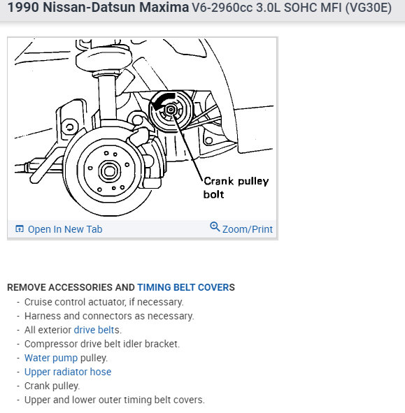

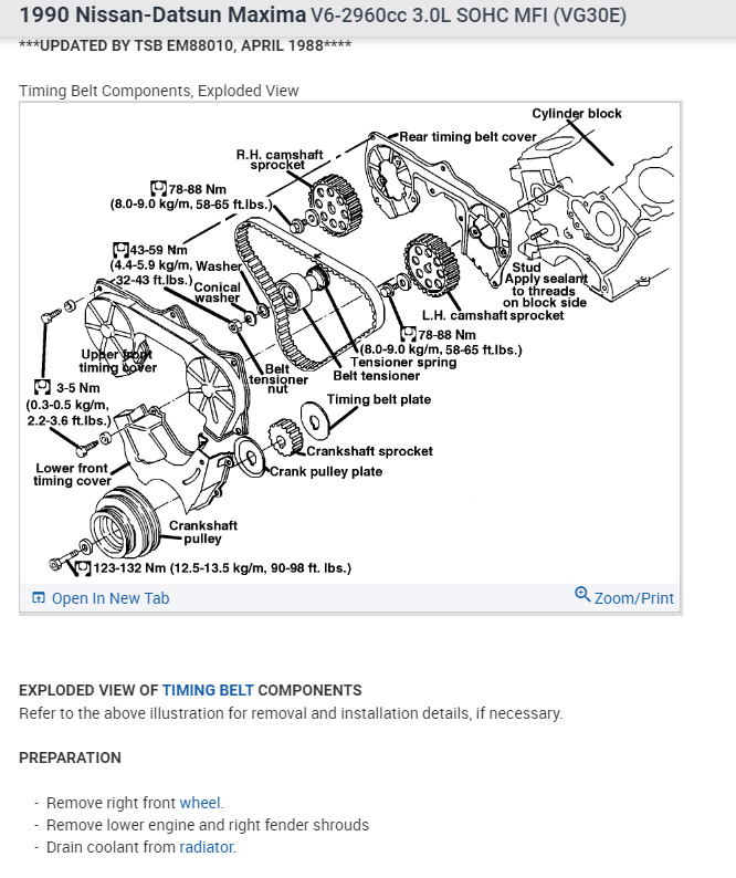

what is the easy way to pull the crank pully off to replace the timing belt and water pump?
Feb 23, 2008 at 5:01 PM
SQM
  • CAR REPAIR CONTRIBUTOR
  • 6,383 POSTS
One way to remove the bolt at the center of the crank pulley, is to use a breaker bar to turn the bolt counterclockwise, while using another bar to keep the pulley from turning. It can also be done using an impact wrench.
Here is a helpful guide on the crank pulley removal:
https://www.2carpros.com/articles/how-a-harmonic-balancer-works

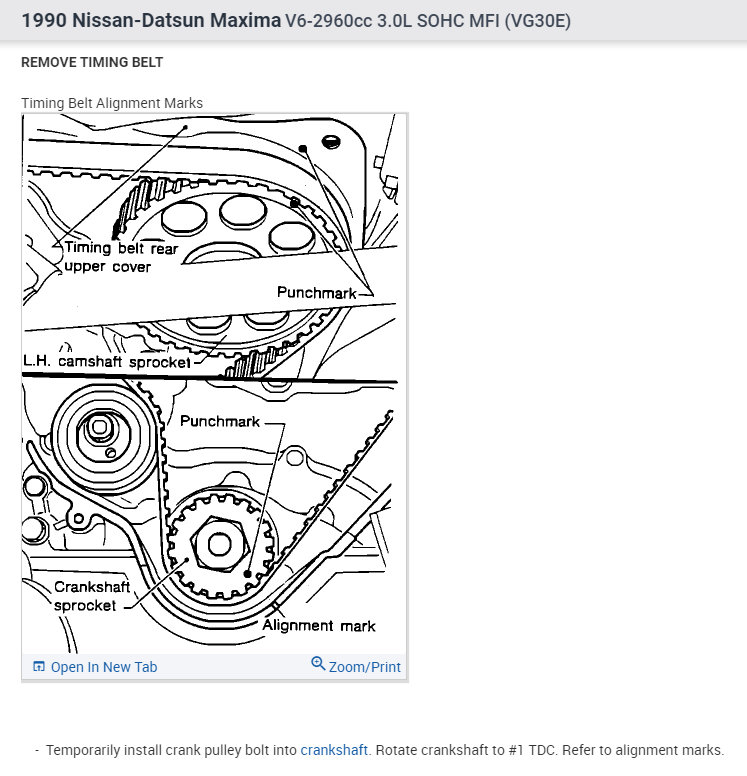

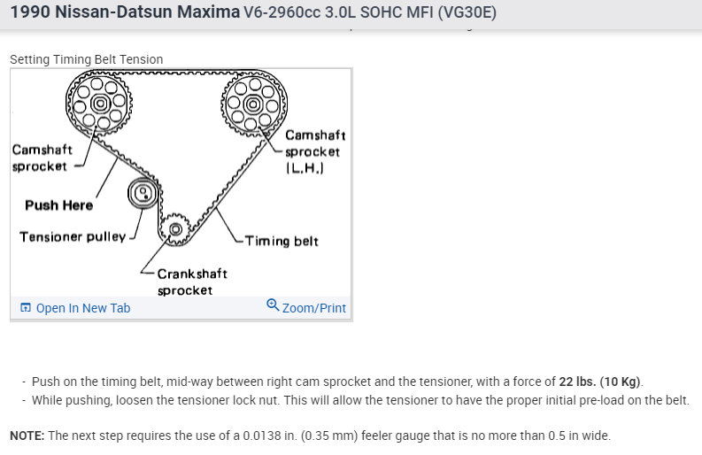

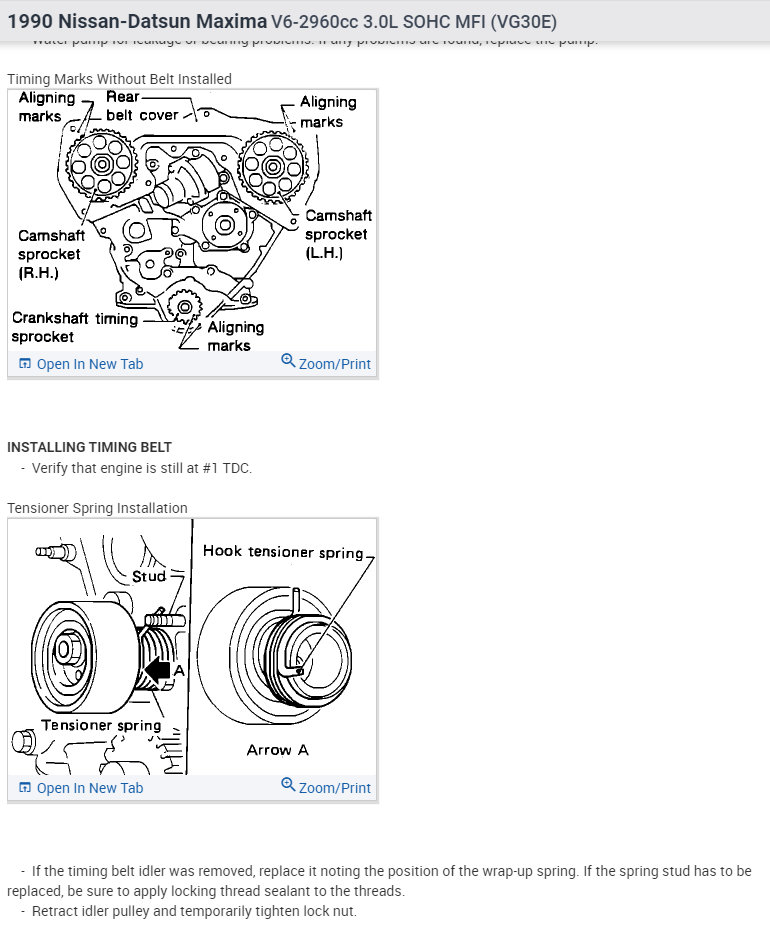

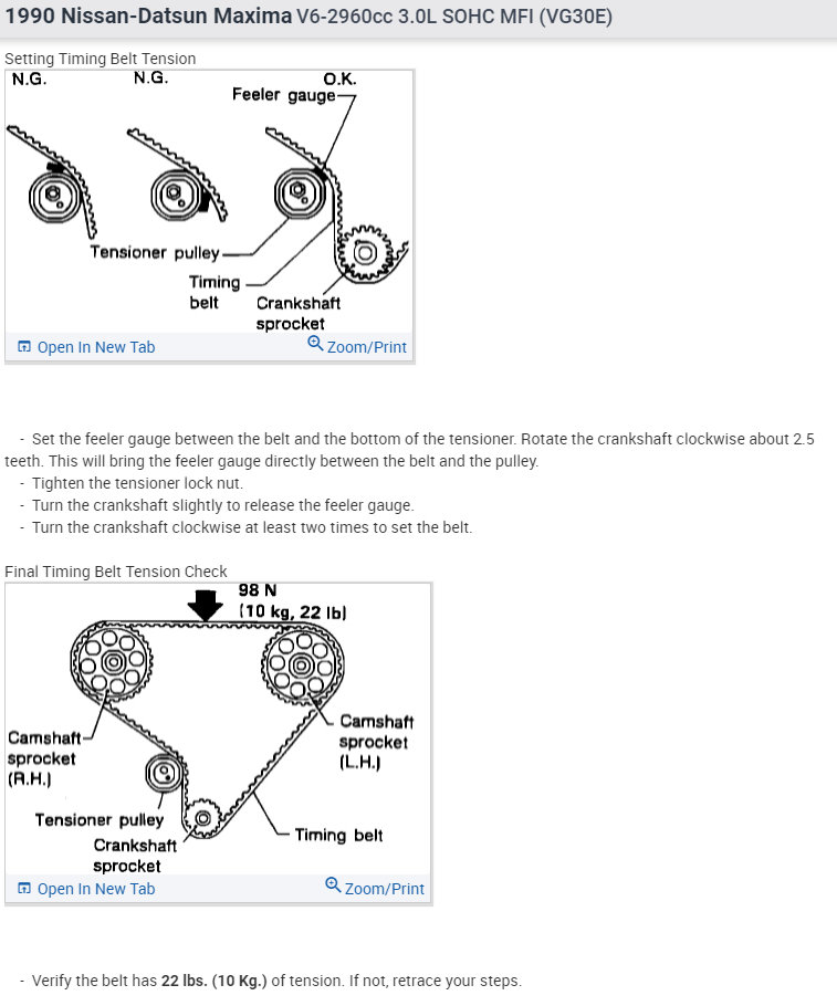

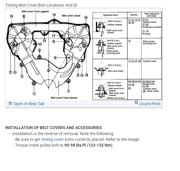

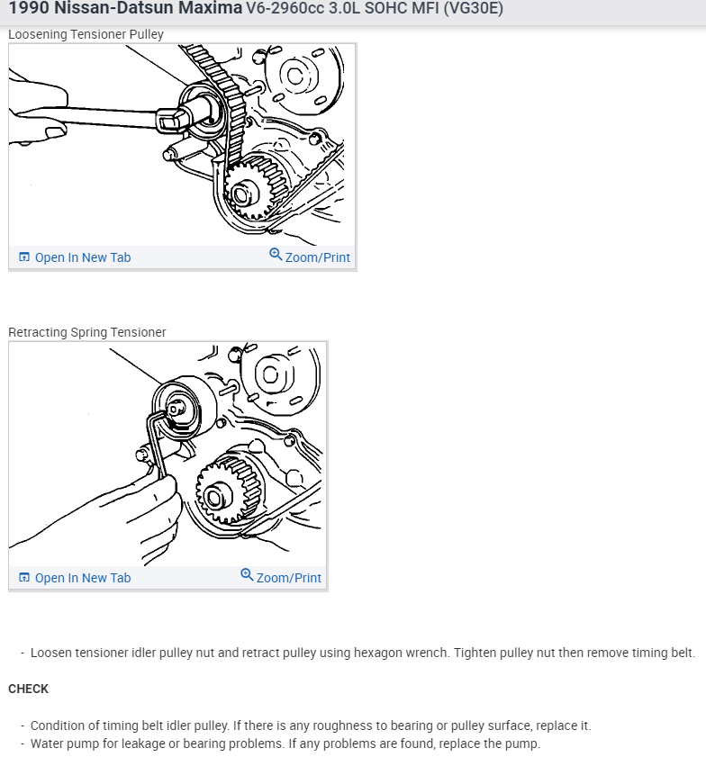

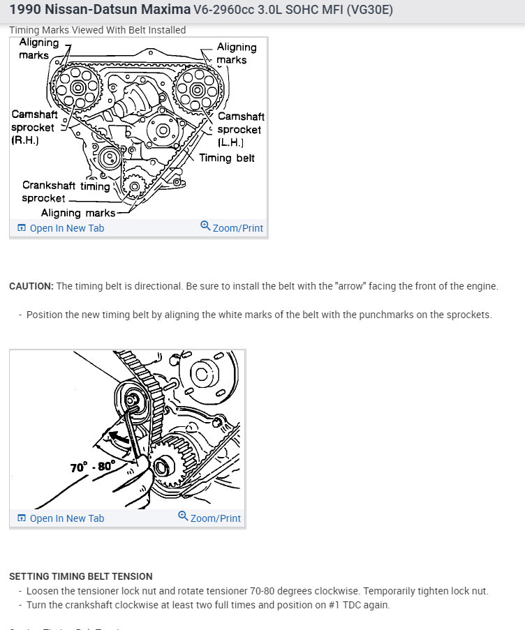

I have attached the timing belt replacement instructions below.
