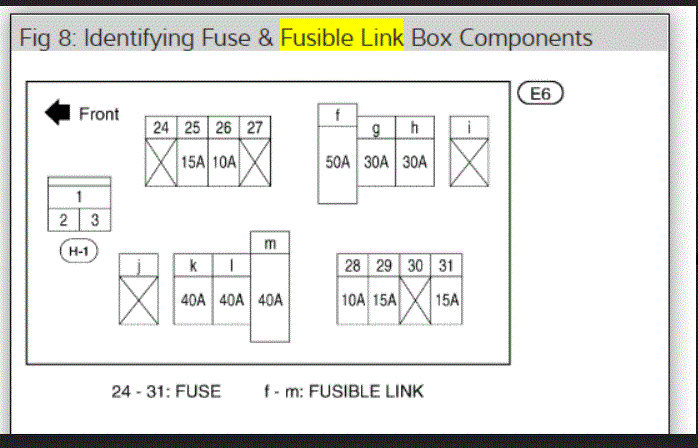

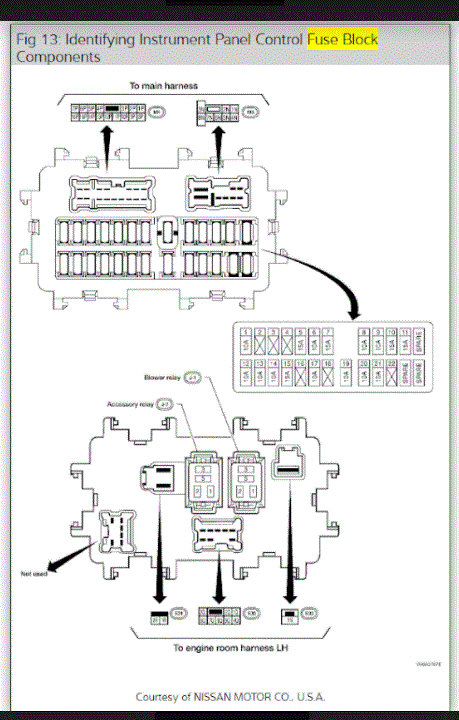

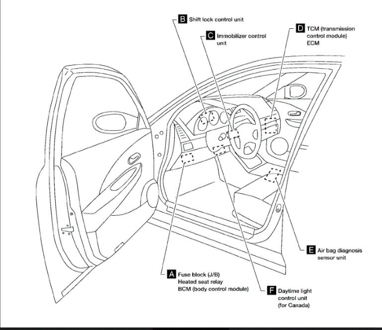

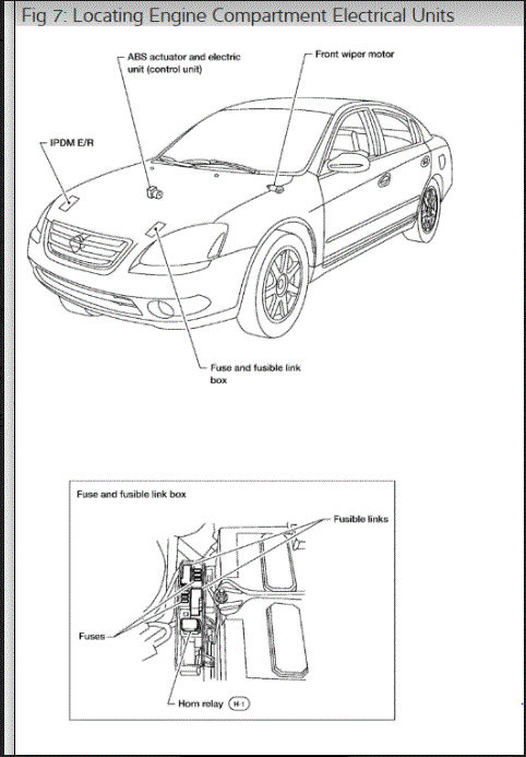

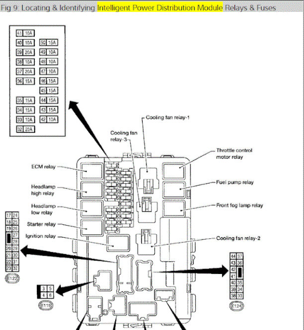

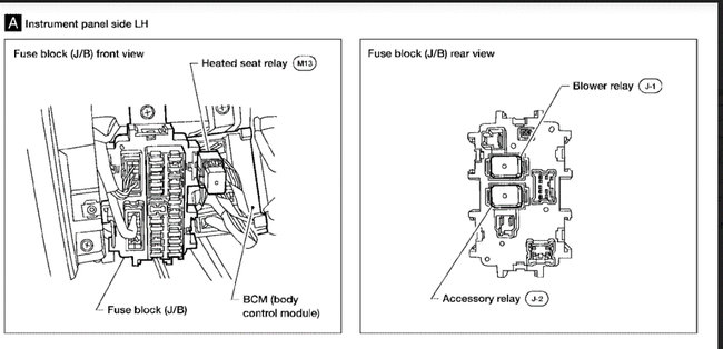

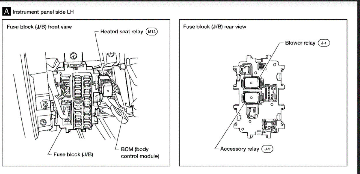

When stopped at a traffic light the lights went out I need to check the fuses but don't know where they are or how to check them can you help me?
Thursday, February 11th, 2010 AT 5:27 PM
  • 109,885 POSTS
If you look at the attachments below, they provide the fuse box orientations and what each fuse is for.
In addition to just checking a fuse, make sure there is power to it. A fuse may be good and not be receiving power.
