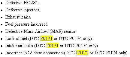

https://www.2carpros.com/forum/automotive_pictures/30961_po171_1.jpg
-1
Sunday, December 23rd, 2007 AT 1:45 PM
GBME
  • 8 POSTS
Thanks for your time, I will check these and get back with you. What is a defective H02SI?

SERVICE WRITER
  • 9,123 POSTS
Heated oxygen sensor- upstream.
