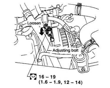

Do I need to lift the engine to replace the pulley on the front of the engine - next to the right wheel? The bearing is shot. From the replacement pictures it looks like there are three bolts that mount it to the enine.
Jan 7, 2009 at 6:08 AM
ZACKMAN
  • 4,202 POSTS
Nope. Raise vehicle, remove wheel. Remove the wheel well splash shield (the black plastic cover), you should see all the pulleys that you have. Which pulley are you replacing? Alternator, A/C, idler, power steering, water pump?
https://images.2carpros.com/forum/automotive_pictures/55316_99altimapulley_1.jpg
Jan 7, 2009 at 6:58 PM
MGRADY70

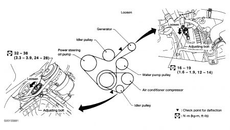

the top (upper) idler pulley
Jan 8, 2009 at 12:09 AM
ZACKMAN
  • 4,202 POSTS
https://images.2carpros.com/forum/automotive_pictures/55316_99altimaidler_1.jpg
Here I blew it up a little bit better.
