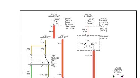

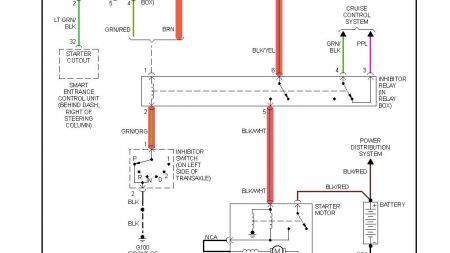

Have a helper hold key in start position-find the starter and bang on it-if it kicks over-replace the starter. If not could be the, inhibitor switch and relay, fuses and ignition switch

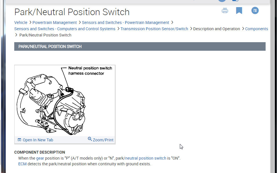

I had that happen once to my '96 Altima. I shifted it into neutral and back into park. And tried to start it again and it started like nothing was wrong.
-1
Monday, May 17th, 2021 AT 6:47 PM
That is great info. Thank you for jumping in.
Sounds like your park neutral switch is failing.
Take a look at the info below. If this happens again I would replace this switch and retest the vehicle.
This switch is what tells the PCM that the vehicle is in park and it is ok to start the engine.
Please let us know if you have other issues in the future and we will be happy to help.
